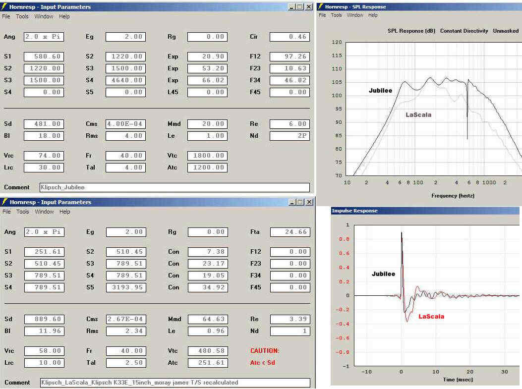

There have been a couple of interesting threads here of late pertaining to conventional front loaded horns. I have been reading up on Klipsch speakers as I recently purchased a set of Klipsch speakers at a price which was too good to pass up. I was of the impression that the Klipsch horn woofers such as used in the Belle and the La Scalla were too small to really be taken seriously as modern high efficiency designs. However after reading I think that I was mistaken. While these cabinets do not extend much below 50 Hz. with out room gain though they are very compact and very efficient and would seem to have reasonable response.
I am curious to to know if any here have ever run either the Belle or the La Scalla cabinet design through Horn Response to see if Paul got it right the first time all those years ago? From what I can see they both represent a good compromise as a commercial product which has consistently stood the test of time in the market place. Both design are very similar with the Belle being a shallower cabinet with a wider mouth. Many owners consider the two versions to be pretty much the same in terms of performance. I have included a link to the AES paper which Paul Klipsch wrote many decades ago for reference. Thanks for any comments or thoughts. Best regards Moray James.

I did a considerable amount of design work on a bettered LaScalla bass section. It became the bass section of the Volti Audio Vittora loudspeaker. It gets pretty favourable reviews.
What I can add in doing both a bunch of sims and looking at measurements, is that there is a total lack of actual bass and a boatload of low midrange. Mr. Klipsch was intelligent in his design decisions. The greatest amount of "bass" in music is centered in the Octave range between 64 and 128 hertz. And the designs are engineered to reproduce this range with great efficiency. About 105 db/watt against a wall. The corner loading story has a bit of actual effect on the Klipsch horn and almost nothing on the LaScalla. The path lengths ore to short to take advantage of the corner loading to reinforce the region below 60 hertz.
Given the math realities, there really is no domestic authentic horn loading below maybe 45 Hz. But then there's just a little music - including organ pedals - below 40 Hz; of course, many of us cherish those occasional passages.
Having lived with a Klipschorn (bass only) for 40 yrs, I can say nothing compares to it for filling a room with great gobs of rolling clean bass, and with a bit of EQ, all the clean bass you'd want to around 34 Hz in organ pedals. Even side drums, the biggest-lowest sound I know, close to excellent.
