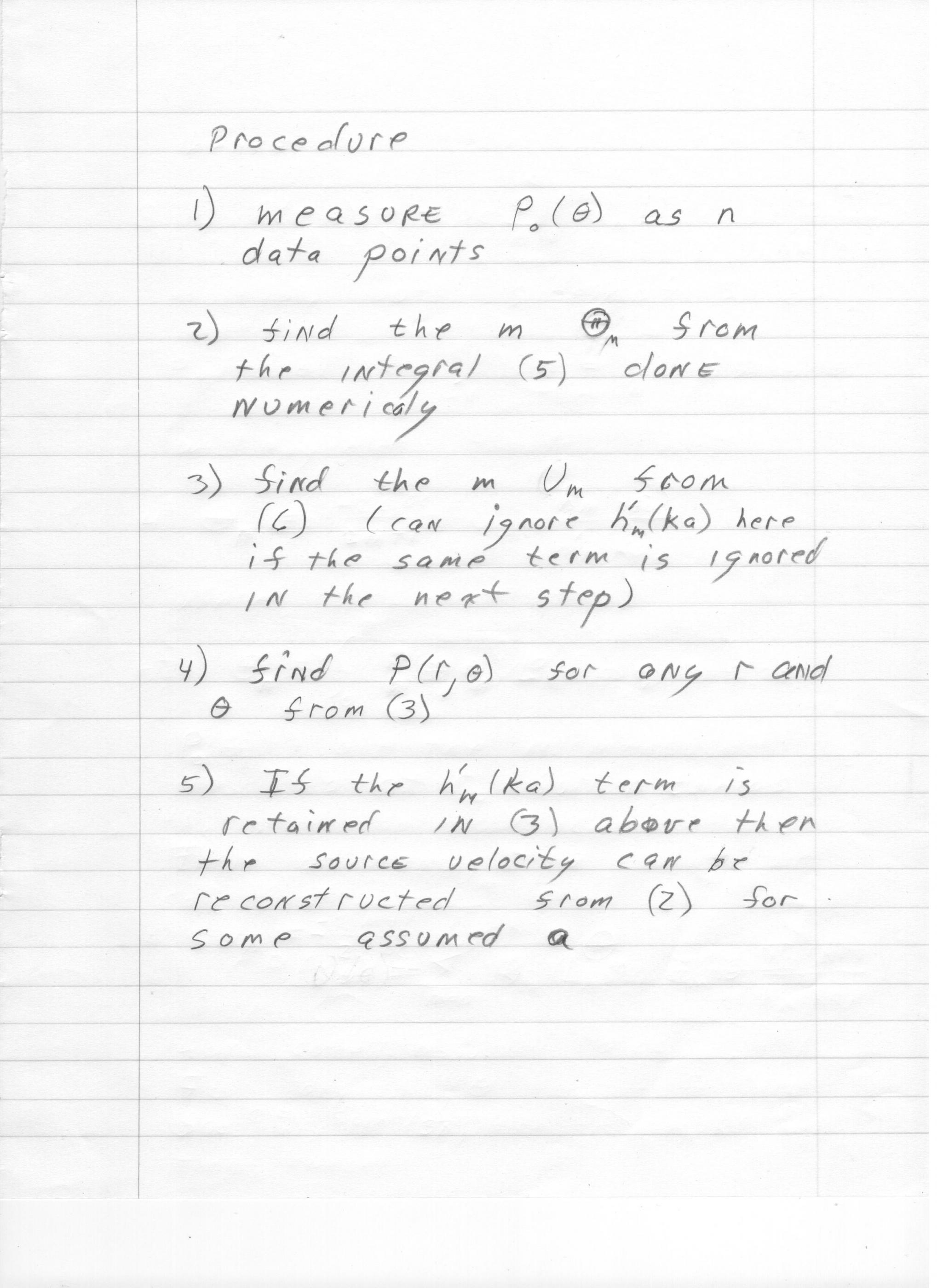

I have read some more articles and the klippel stuff more thoroughly.
My understanding so far is that klippel takes the extra points to have "redundant" points to use for the least squares fitting, so to seperate the sound fields of the direct and reflected sound more acurately.
Maybe we could draw/write out an example in 2d with just 1 complex number (one frequency) and one reflection to get a clear picture of the steps that have to be taken?

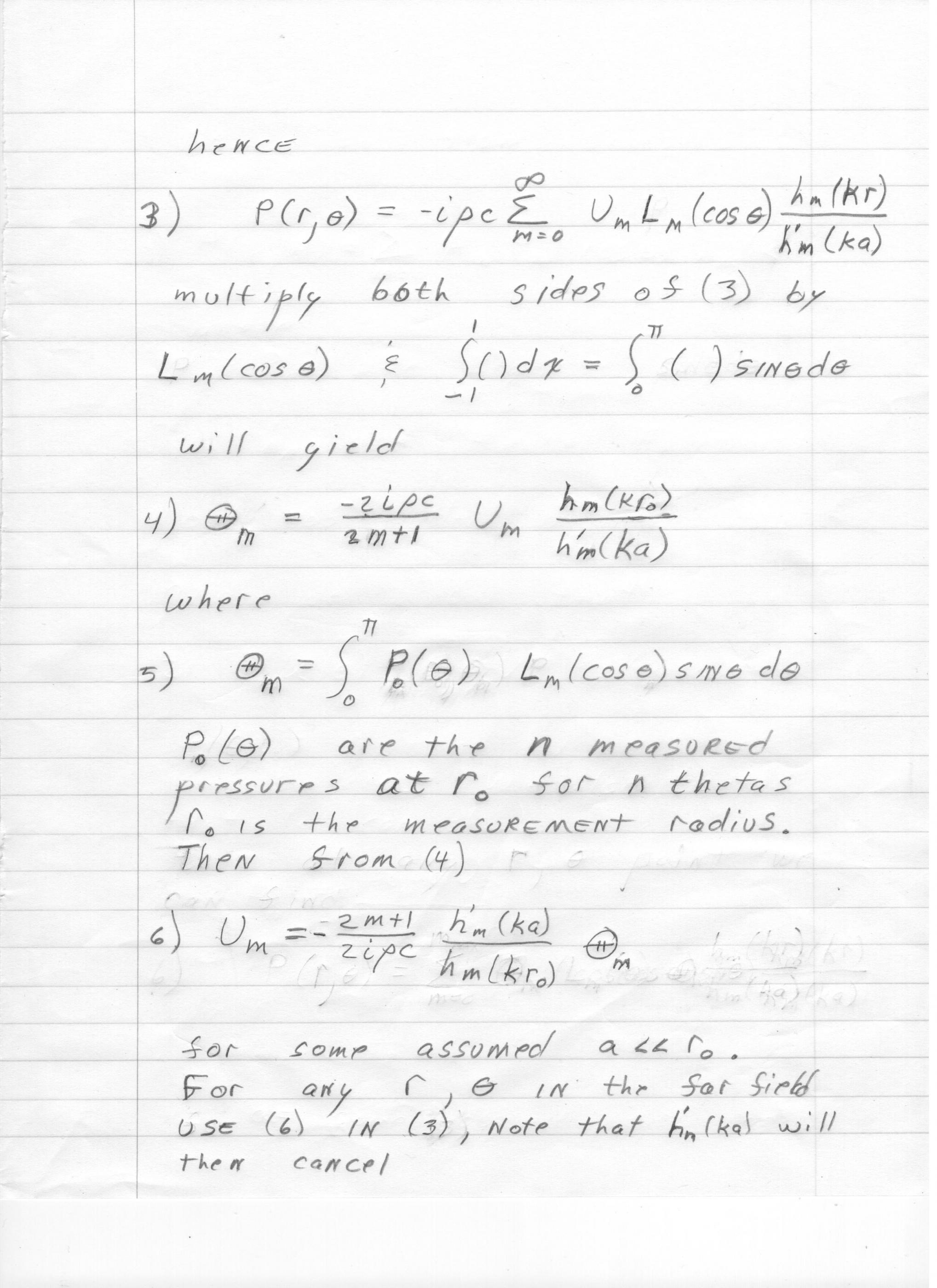

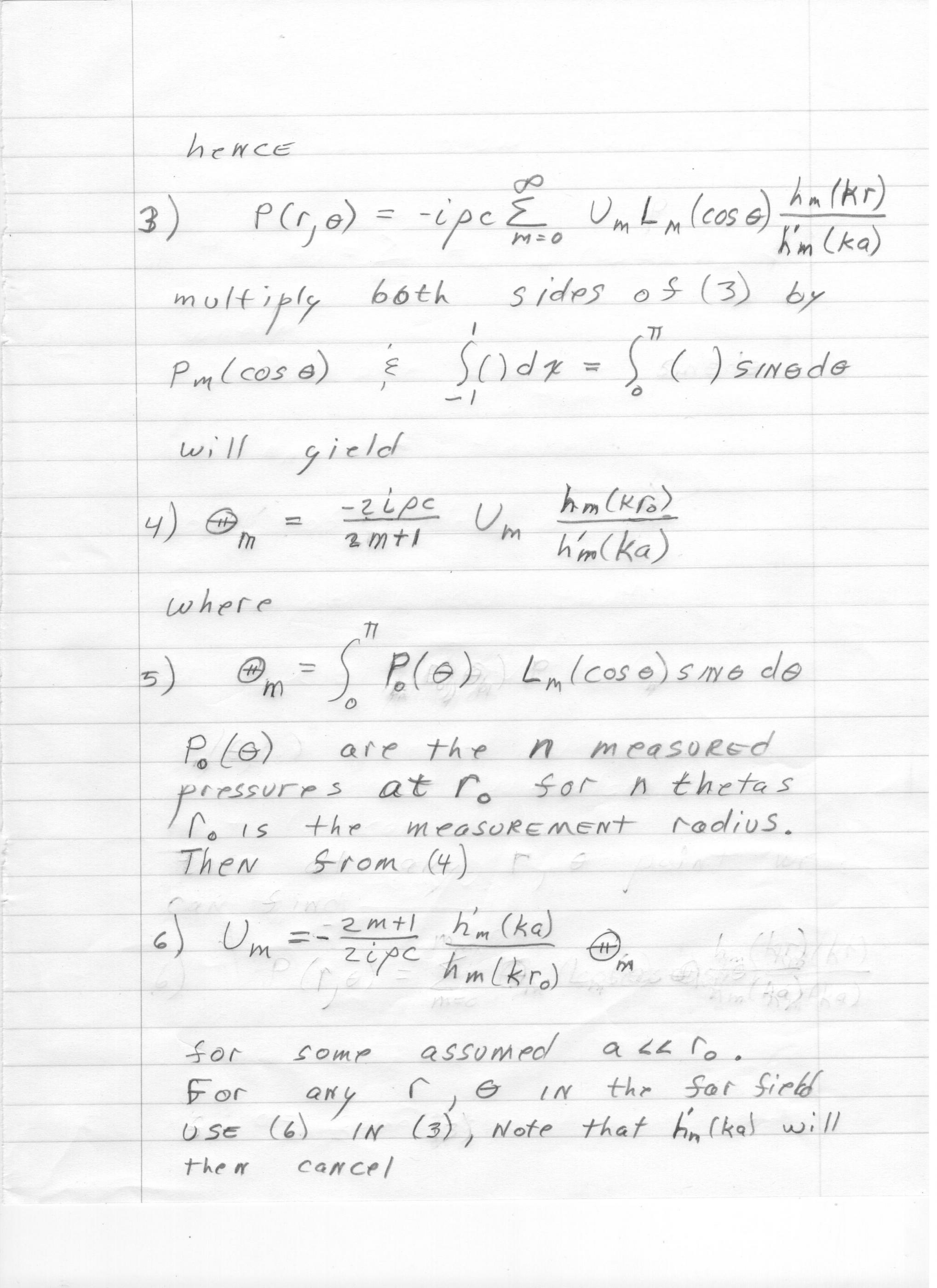

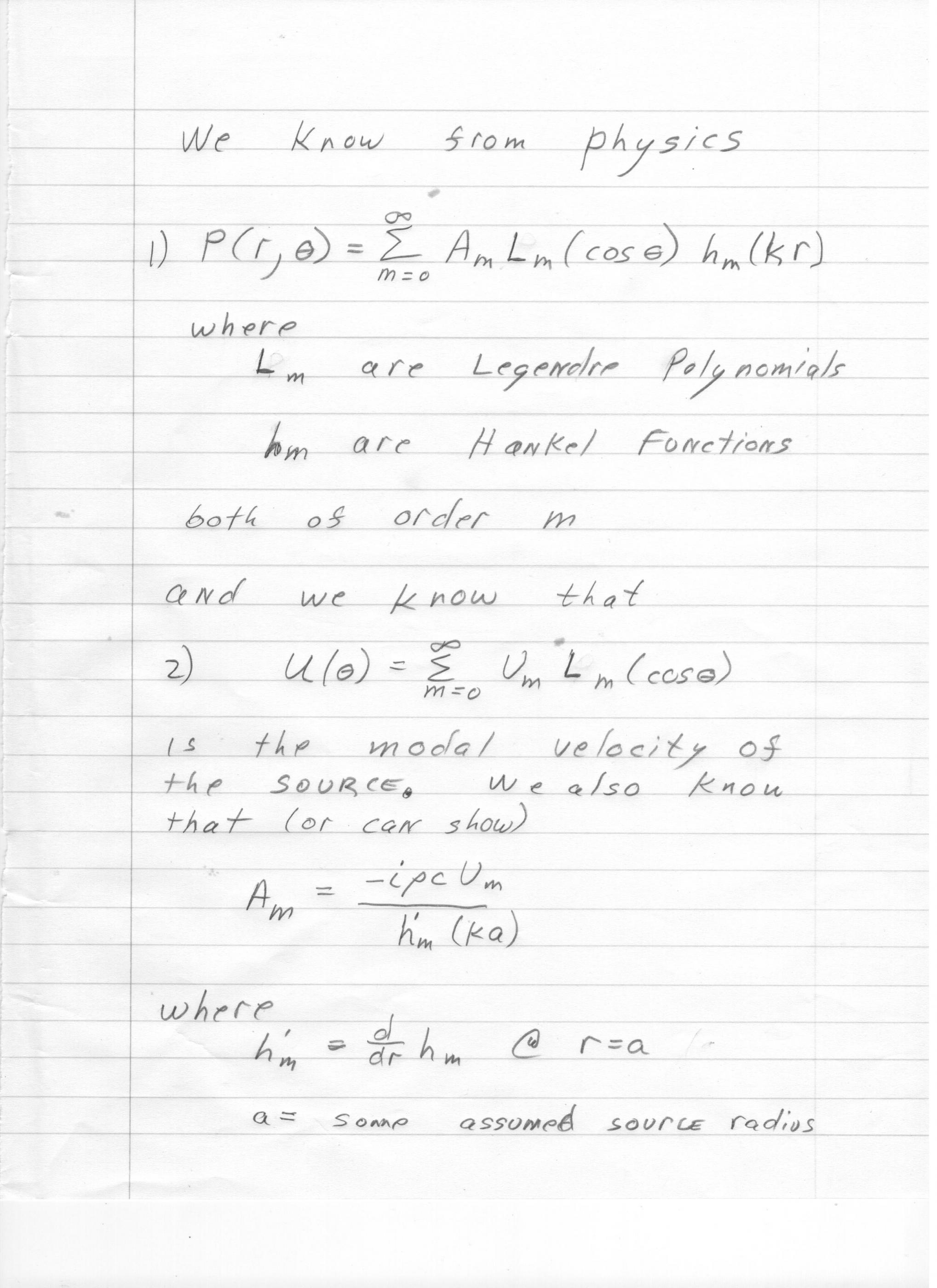

I have attached a short and simplified procedure for 2D. 3D would be almost identical.
Let me know if you have any questions.
PS. I used Lm here for the Legendre Polynomials, but the usual usage is Pm, but this can get confusing with P(r,theta).
OOPS - just under equation 3 the Pm should be Lm.
Also, we know that from the hankel function terms there is a cut-in of ka values below which the terms will not contribute (see my book figure 3-6). Basically below the mode number where ka = M there will be almost no contribution to the result. This means that M, the modal number will not be necessary for any frequency below ka.
Now we also know that for M modes we need precisely M data points and more points are just redundant. So the number of required points = maximum modal number. If M=400 then that is like saying we need data for a ka value of 400, which is absurd, ka seldom goes above 20.
The above analysis is slightly simplified since the "cut-in" values for 3D Spherical Harmonics will be different than 2D, but not so much different that 400 data points is necessary to go to 10 kHz.

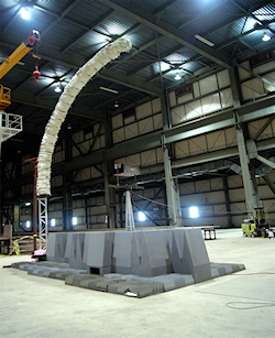

movie of the pattern the klippel system makes:
UPstage 360|World's First 360deg Smart Speaker in Hi-Res Audio by Level 10 —
Kickstarter
I have to admit that I am totally fascinated by the realization that you can make good measurements in such a small, untreated room. You can hear how typical the room sounds on the video, normally you would not be able to measure anything decent below 300Hz
That video is a great find!
And yes, the idea of getting good full range measurements in a typical room is what started me on this. We may not be able to get there, but it is absolute worth trying to get there, and I'm extremely grateful for all the help so far.
Thank you very much for that contribution Earl! 🙂
Also, we know that from the hankel function terms there is a cut-in of ka values below which the terms will not contribute... Basically below the mode number where ka = M there will be almost no contribution to the result. This means that M, the modal number will not be necessary for any frequency below ka.
Now we also know that for M modes we need precisely M data points and more points are just redundant. So the number of required points = maximum modal number...
Yes, that's essentially as I understand it for 2-d.
But for an all-purpose measurement system that does not assume symmetries I think we need also similar (even if not identical) resolution in 3-d.
So approximately M squared points, with your example M=20 and so 400 total points, exactly my own ball-park estimate.
The main use of 3-d polars seems to be sound systems for stadiums, auditoriums and the like, where there are speaker arrays and potential interference patterns.
Then ka can be substantially more than your example.
I think this helps explains the AES56 standard, where they use M=72.
But 20 seems a reasonable start for stand-alone speakers and DIY use.
