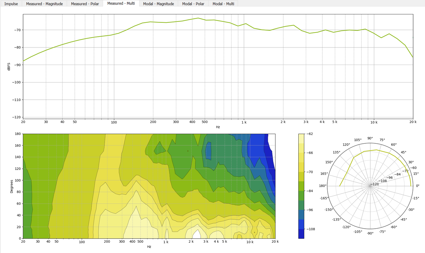

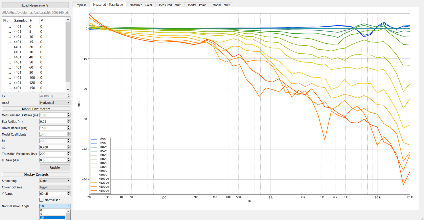

I made a start on some animated charts and thought a vid might be interesting to see the whole thing in action
It seems you can't embed youtube vids in this forum so head to this vid on youtube, I seem to have broken a few of the bits in the last minute today so ignore that bit

Thanks for the video, that looks awesome!
We would need to resort to the C# code to debug that.
a test case to reproduce

I realised I was using freqs.Length-1 in my code but this function already accounts for that in the definition (i.e. the arrays are declared as 0:NumPts-1 so I don't need to -1 this time). This reduces the number of NaNs but doesn't completely eliminated them, CB Moore seems particularly troubled.

added an interactive polar view which varies with the mouse position on the freq axis
@gedlee what are the next steps on the analysis side of things? I have some rough edges in the gui code but otherwise I think I am up to date with the data analysis.
Now I can foresee that being very useful!
