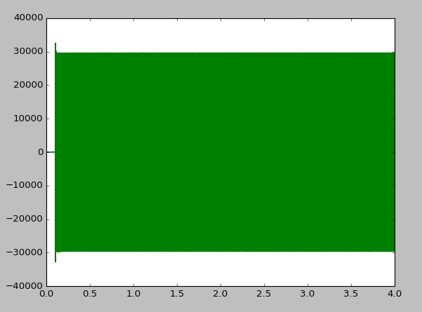

This might be a little off topic but of interest to those that might want to incorporate the acquisition of the measurement data into a single Python program. SoX is very popular for audio file manipulation, recording, and playing. I know under Windows Python has a pyaudio interface to the free PortAudio implementation but some searching found an already built-in interface (subprocess) that works with SoX making all its capabilities available. Sox (SoX - Sound eXchange | HomePage) is a one click install for those that want it easy. If you have Anaconda Python and SoX with a Windows path entry to sox.exe there is nothing else to do.
The picture is a loopback of a 1kHz tone at around 30,000 16 bit codes.
from scipy.io.wavfile import read, write
import matplotlib.pyplot as plt
import numpy as np
import subprocess
import time
#edit here to add a HOME directory, file paths, etc.
RECFILE = 'C:\Users\scott\Desktop\\tempau2.wav'
PLAYFILE = 'C:\Users\scott\Desktop\\tone2.wav'
#end edit
# Build the argument strings for SoX. The commands must self terminate, play ends at
# the end of file and record ends by using the trim option, trim 0 4 simply records
# 0 to 4 seconds and stops. You can't cont-C to stop recording here.
args_play = ['sox','-q',PLAYFILE,'-t','waveaudio','default']
args_rec = ['sox','-q','-t','waveaudio','default','-t','wavpcm',RECFILE,'trim','0','4']
# Force SoX to run without opening a cmd window, the -q option in the args
# also forces SoX into quiet mode that minimizes latency
startupinfo = subprocess.STARTUPINFO()
startupinfo.dwFlags |= subprocess.STARTF_USESHOWWINDOW
# Simultaneous play and record from seperate processes usually works these days.
# My Scarlett 2i2 didn't (after hours of aggravation I simply checked and it does not
# with any application (sans ASIO) under Win 10). A cheap Soundblaster USB worked fine. You will need to set
# default devices in the Windows control panel and fiddle with the mixer settings
# to get levels right, 48k at 16 bits worked fine. Don't be fooled into thinking you are
# getting 24 bits under Windows, none of the free PortAudio implementations (AFAIK) support it, in
# general ASIO is required for this. Trust me under Win (not Linux) you can really be fooled.
sox_r = subprocess.Popen(args_rec, startupinfo = startupinfo)
sox_p = subprocess.Popen(args_play, startupinfo = startupinfo)
# Python keeps going, I found simply sleeping until the played file is over works since
# I could not find a foolproof process to signal completion under Windows. The '5' below
# is the length of the played file, a general solution would test for the length and
# insert it. The recording needs to end first with enough time to close the file, otherwise
# there can be garbage in the file. Padding the files and accounting for this should not
# be a problem.
time.sleep(5)
