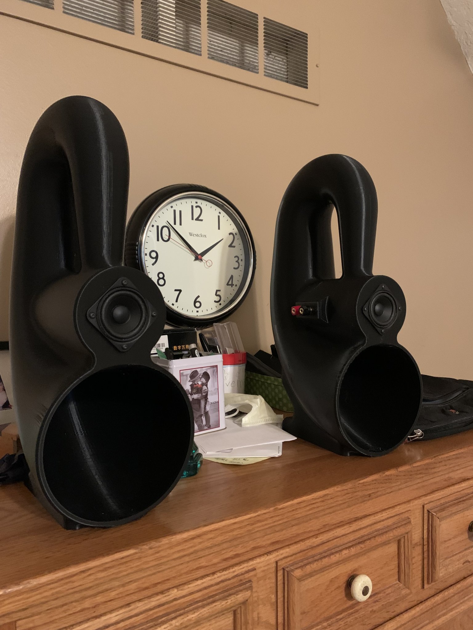

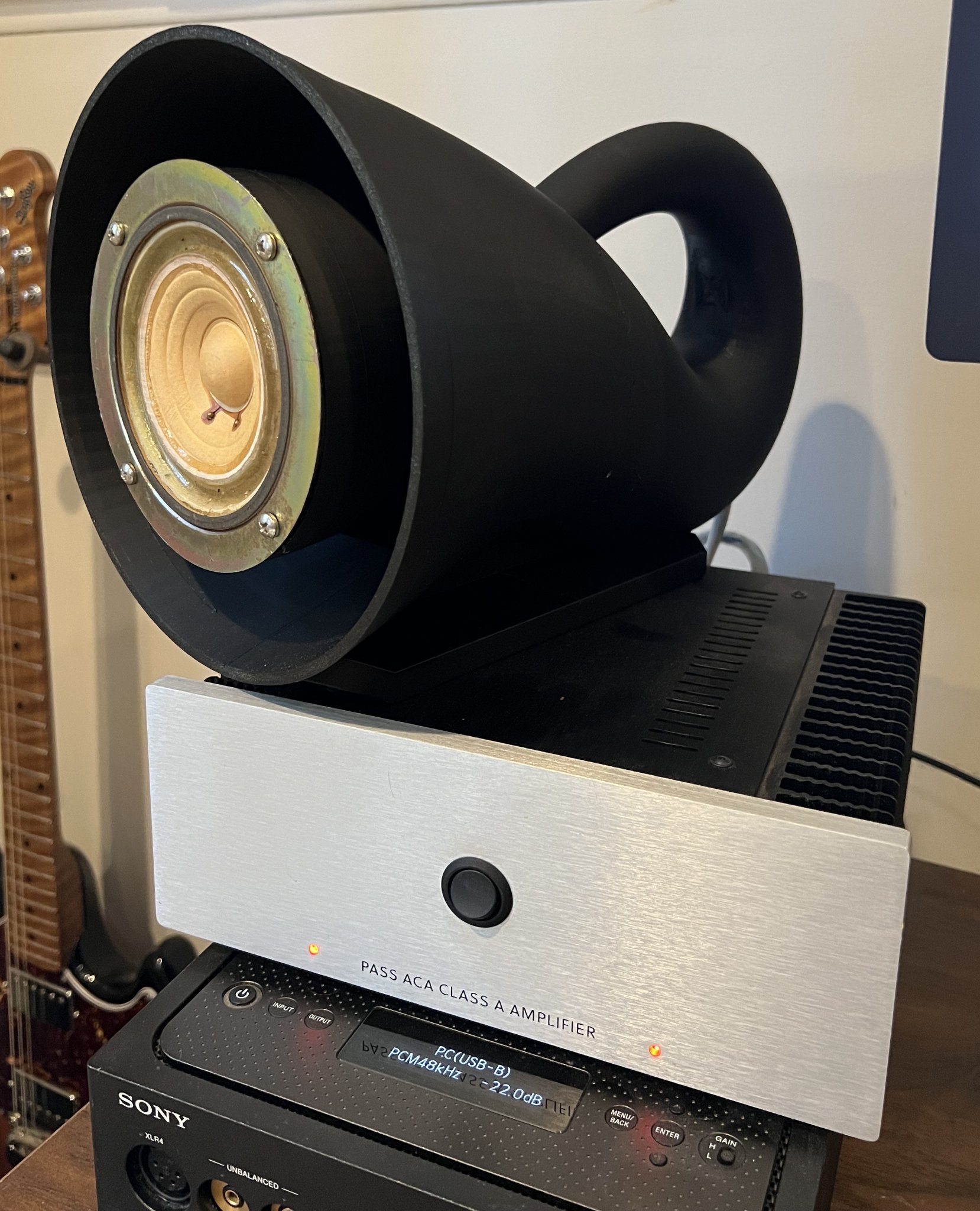

I was going to print that out and changed my mind. I could not get over the the chamber covered up 70% of the horn mouth, maybe that was not an issue. So I designed this to print in one piece on my printer. I have printed a few pairs. The drivers are Eminence alpha 8. These are 2 inch speakers and are 8 ohms.

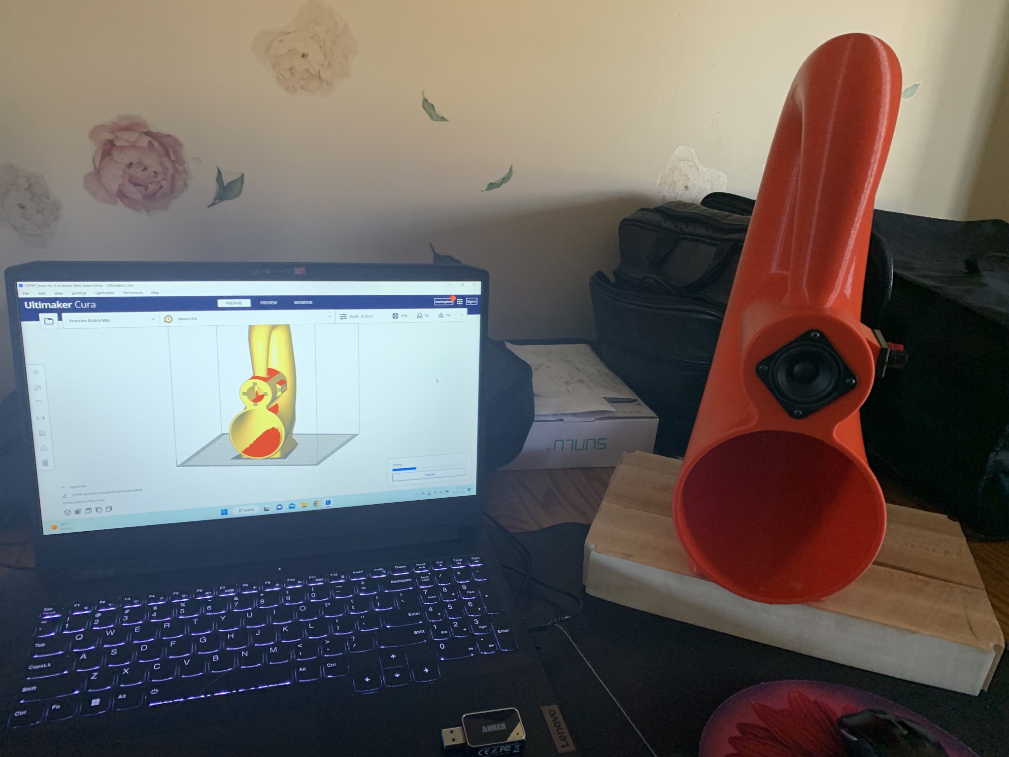

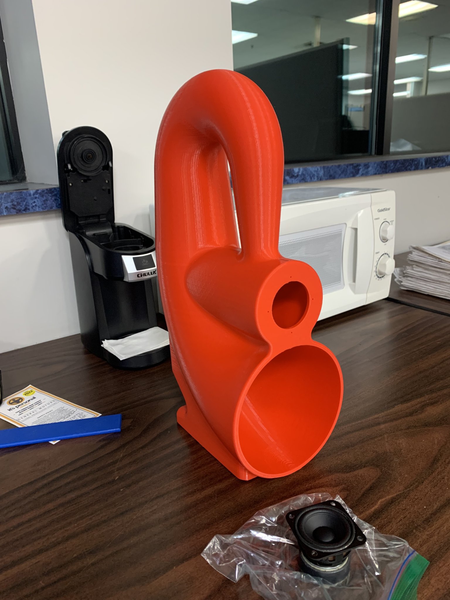

Very nice! I bit the bullet and am printing a scaled up version of the Klein Bottle to use with the Coral Holey Baskets. I only have PLA basic on hand, and did a 25% infill just to see if its worth bothering with a better filament and more infill. Have you measured with different filaments on your multiple versions?

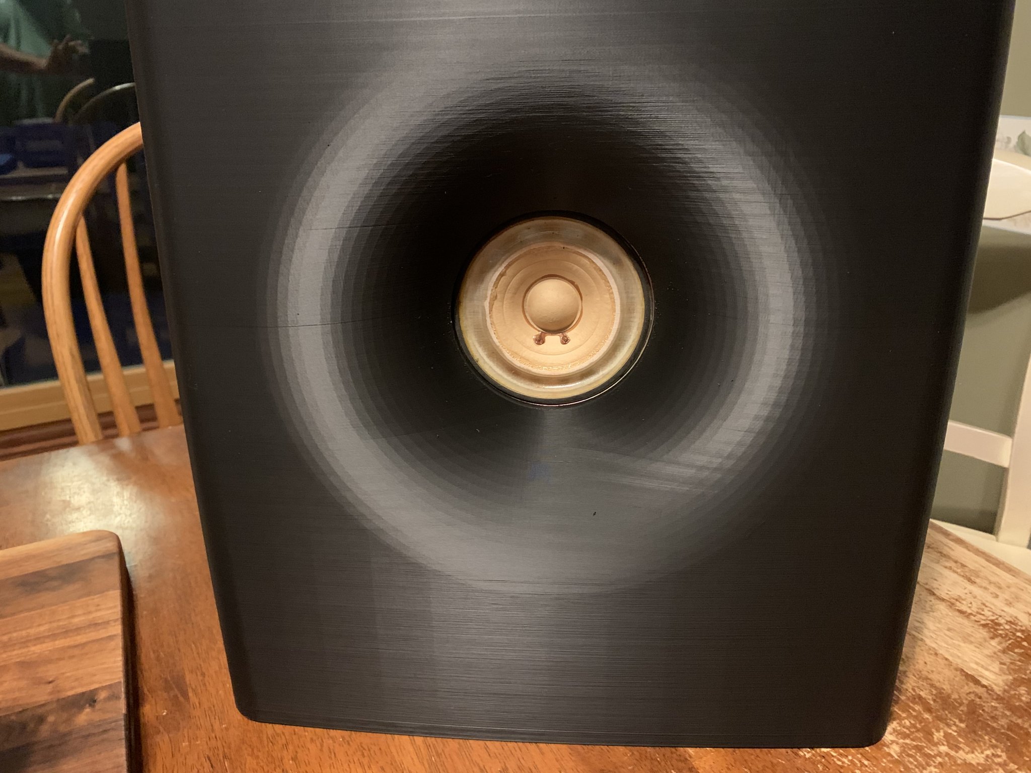

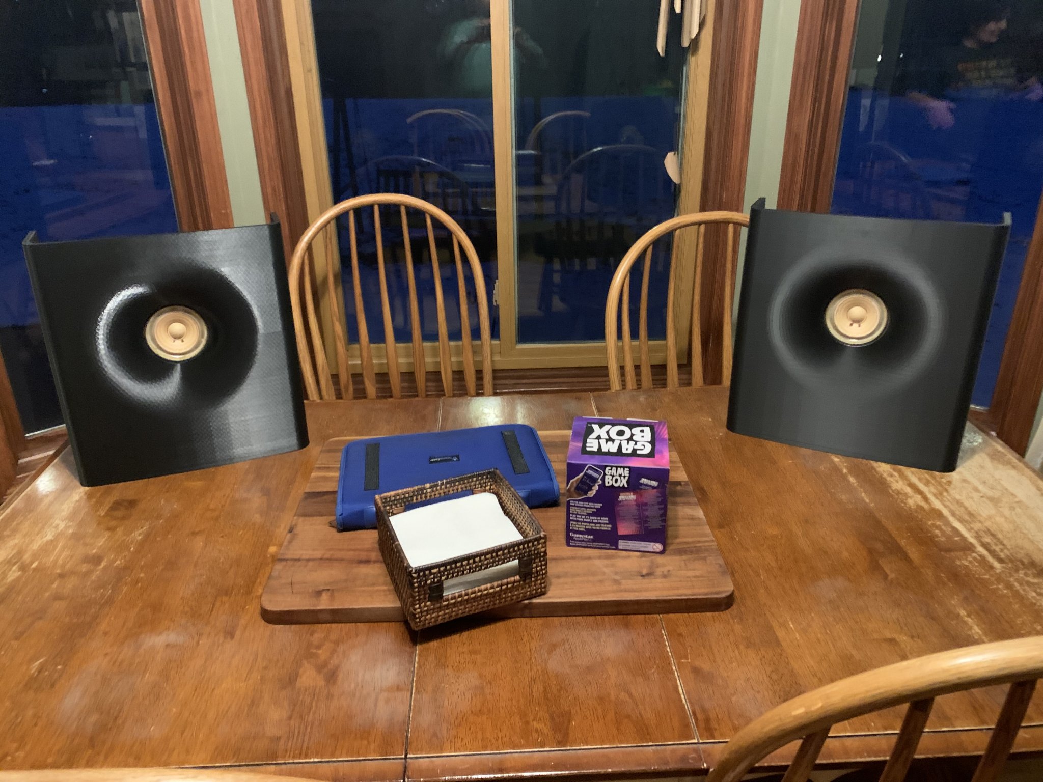

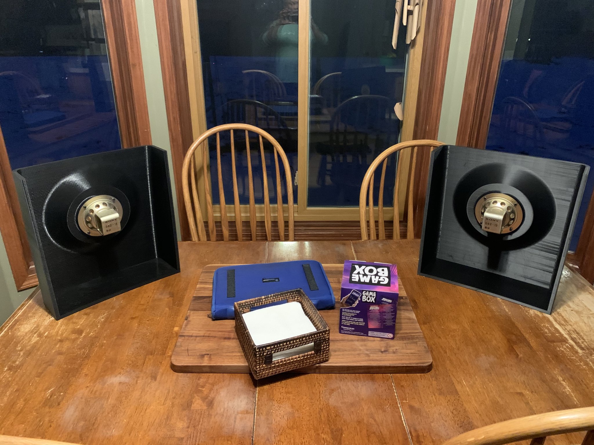

I printed them using basic PLA. I have not measured them all. I used 25% infill on them. The walls are 8.5 mm thick. Wonder how big you need to scale them for the holey baskets. I printed a a pair of open baffles for my holey basket. I found out one of them was damaged. It sound like the dust cover has loud screeching sound to them when pushed them in wattage.. here is a picture of the open baffle. The baffles were spherical shaped. The one damage speaker I could not stand listening to them.
@ Dave, the surrounds are supple not stiff at all. the one speaker makes a screeching sound. the other sound great. the one is damage I believe, the dust cover was pushed in and I sucked it back out using a vacum and that may have damaged it.
