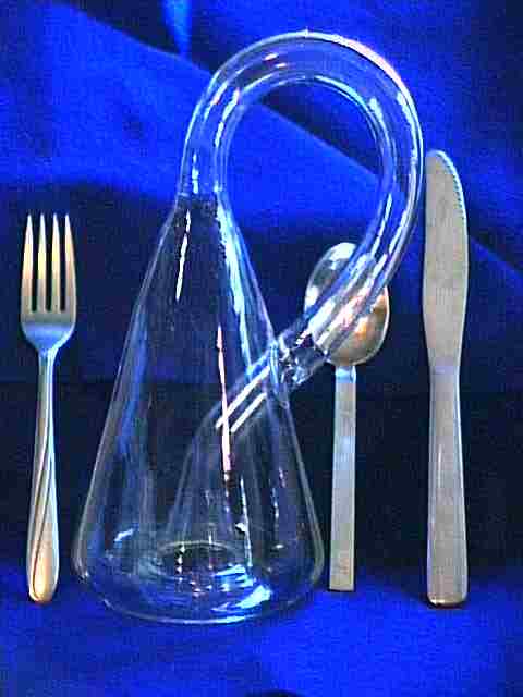

A Klein bottle is closed if you put driver at mouth. In which case it will be kind of like a sealed TL (if long enough). One could mount driver on wall of bottle and let mouth/neck serve as vent in a BR or TL or BLH. The aesthetics would look great in a real blown glass enclosure so you can see the Klein bottle topology. Otherwise looks like a bottle with a loop handle.

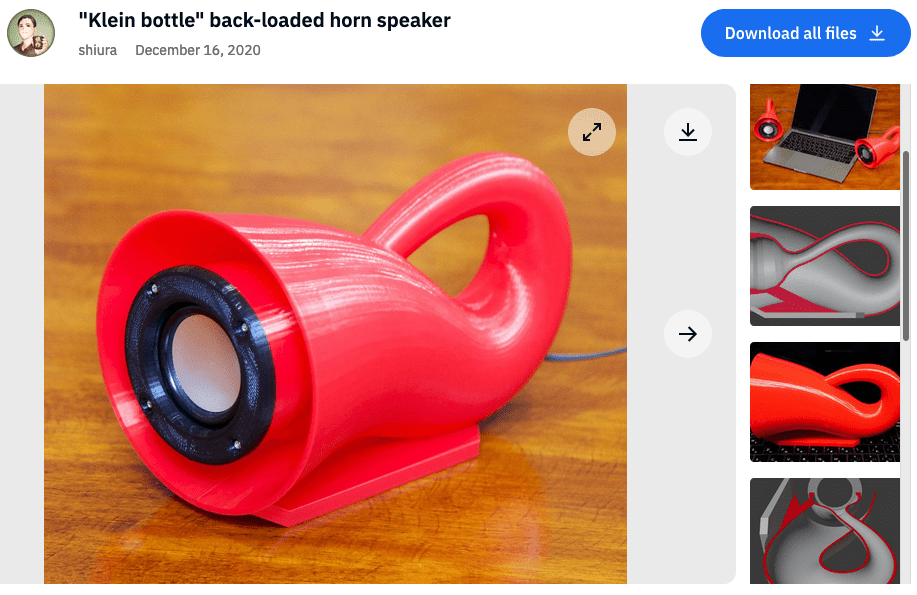

Hi. I'm reopening this thread to ask about a klien Bottle enclosure I've seen on Thingiverse page to see if anyone has any ideas about it and how one might go about calculating/modeling this type of enclosure?
I'm thinking of printing one out to try with a decent 2" driver. But I've just found I have some TC9FD-18-08 on the shelf, so was wondering about scaling up this enclosure to try out. Any thoughts?
a sealed TL
But with a geometry opposite of what you would really like.Kleinhorn opens up the bottom (both X’s and my pictures, and then sizing everything to be a uitably sized horn.
