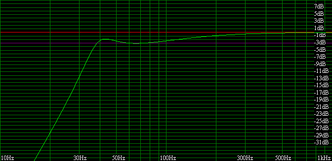

Here's the WinISD plot for the 6.5" unit.
20l box tuned to 40hz.
