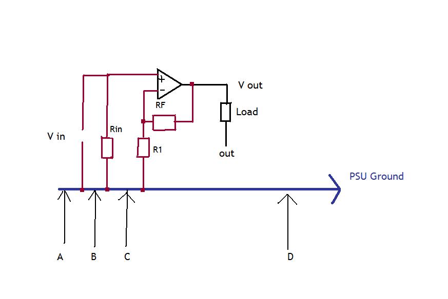

What you are after is perhaps more like a 3 or 4 wire sensing system where the feedback is taken from the load itself. Lab PSU's often have this sensing arrangement, and it "removes" the effect of all the wiring/sockets etc.
If you look at he drawing below, which is any amp, discrete/chip/ Quad 405 etc there is one thing to remember. The amp will try and keep the voltage difference between it's inverting and non inverting terminals at ZERO. So if RF is 9 K and R1 is 1K and you put 1 volt on the input ( analysing at DC is surprisingly useful- each bit of wire and print in your amp has significant resistance ) then the output rises to 10 volts to do this. That 10 volt's gives 1 volt on the inverting input so we have our gain of ten. If we connect the output to point D the current in the load flows back to the PSU and does not contaminate the input.
Now imagine that blue ground has 1 ohm resistance end to end ( which is probably to high by a factor of 5 or 10 ).
Now if you connect the load along here at points A/B C etc it will alter the voltages seen by the amp. Point C will "add" a voltage to the inverting input that is in phase with the output.
Point B will add the signal to both input and feedback nodes but not equally. Why -- because points B and C have resistance between them creating a volt drop.
It get's even more interesting when the load is reactive as the current and voltage are not now in phase + the load ( speaker )has a very variable impedance curve maybe as low as 3 ohms and as high as 20 or 30 ohms.
It's no wonder the "sound" changes. There is really only one correct feedback and grounding scheme, and going away from this can increase the distortion of the amp by perhaps 10 to the point of instability !!
Same for the inverting configuration as well. Draw it out -- it makes it easier to visualise.
Regards Karl

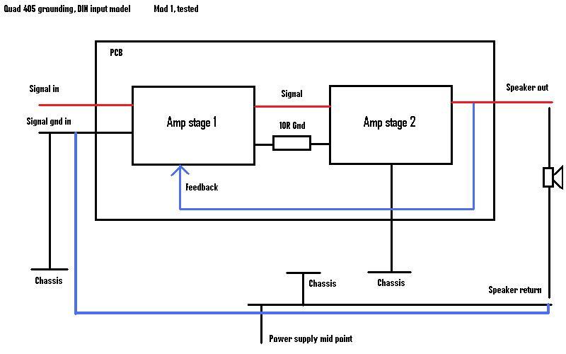

I tested my theory a little bit, by going halfway: The 405 has an existing path from power caps middle (and star ground point) to chassi's ground, which connects to the DIN input as well as the ouput stage ground (via heat sink arrangement, as far as I understand). This path was augmented with a short and fat wire from loudspeaker neutral terminal directly to the channel's input side (small signal) ground. (Solder side, where the push-on pin for signal ground enters.)
The new low impedance path just does what a more complicated path already does, but far better I hoped. I wasn't very worried about oscillation etc since the path existed already. Since I didn't remove alternative paths there are potential ground loop problems, which I'll live with until I feel I understand what paths can be disconnected without bad things happening..
The result is encouraging. Very dynamic, very transparent sound. Really comes to life at life-like levels. I don't think the effect is due to overshot, as treble is very natural and not at all uncontrolled or exaggerated (and this is at very loud levels). Also, when only one channel had been modified, that side sounded slightly more recessed compared to the unmodded one. It's the best sound I've had so far in my system. The one obvious shortcoming is in bottom end power at very loud levels, where a few more 100W might help. Or maybe it's the current limiter that stops delivery..

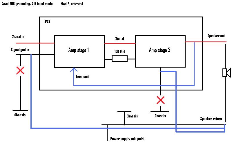

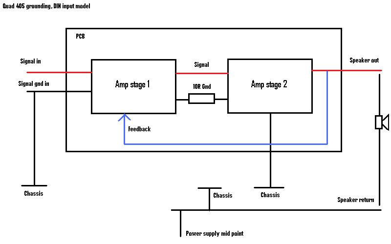

Here are simplified block schematics showing the grounding scheme in the original 405, my newly modfied 405, and a planned further modification:
Seems I can only attach one file, so may have to spread over 3 postings.
So, unmodified 405 here:

Modification 1, where signal input ground is more tightly bound to speaker return. In real life the wire is short. Shown here as fat and blue. Before the mod the same path existed via the chassis. (Still does, in this mod, in addition to the new path)
