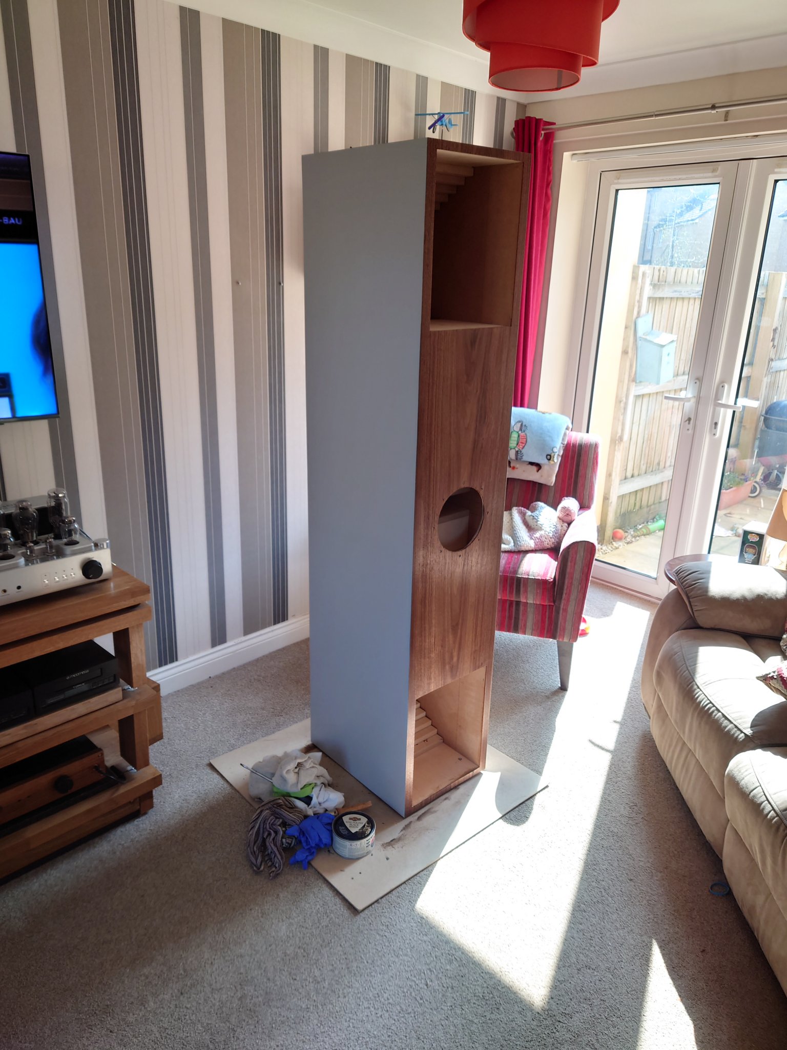

What do people think on the efficiency of these.
I was going to consider getting a 4 watt amp, assuming these are in the high 90s efficiency wise

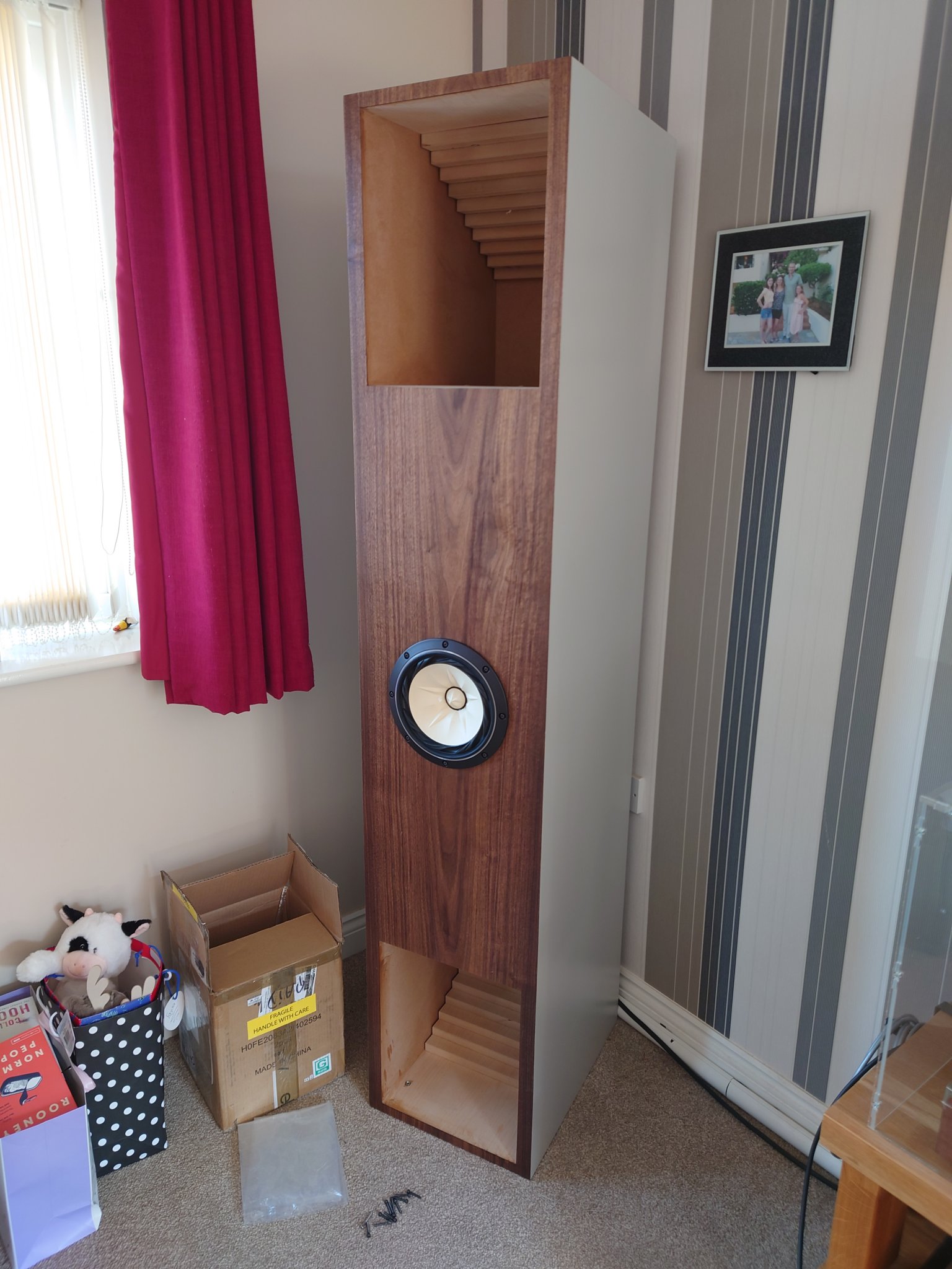

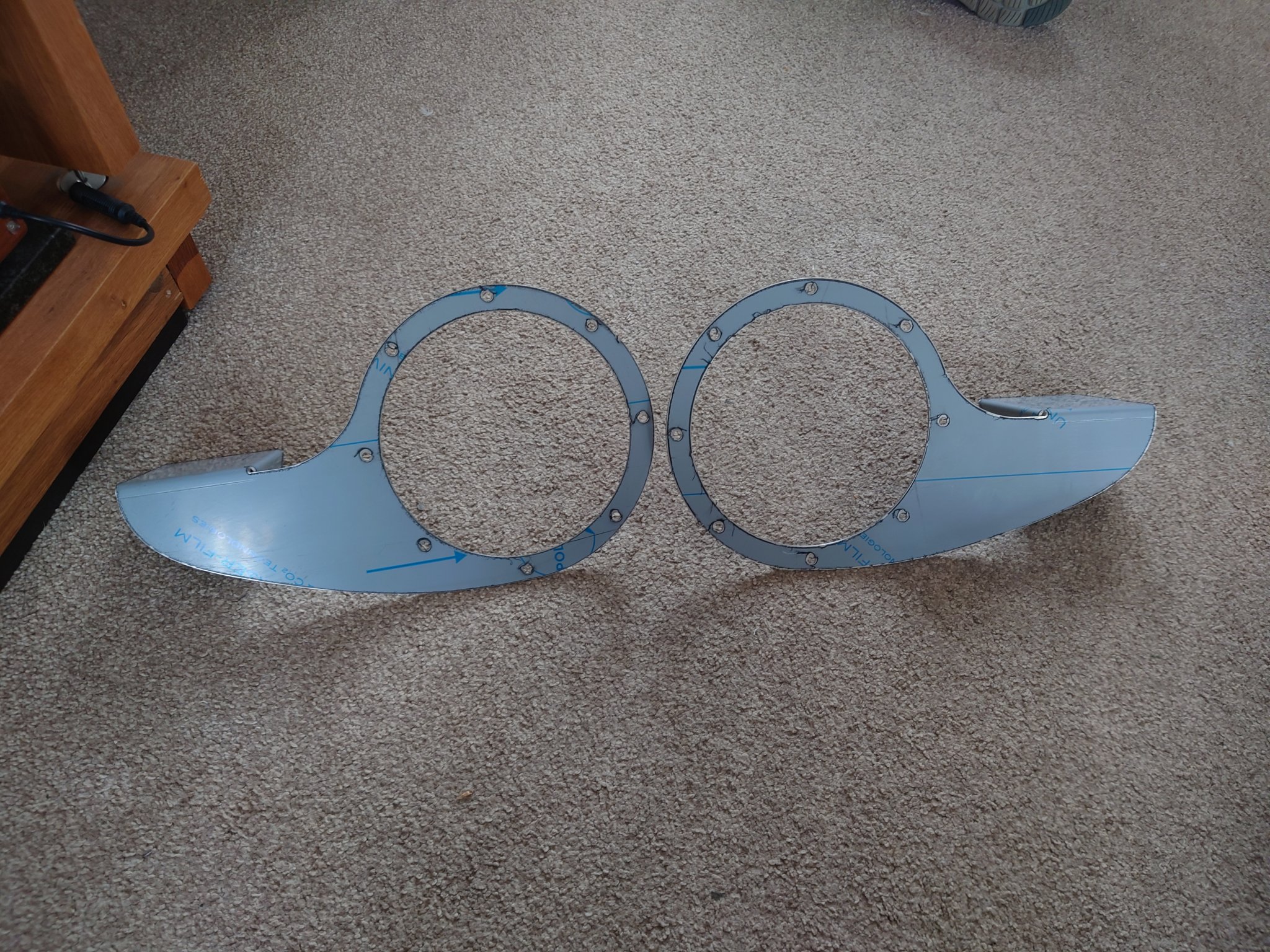

BeautifulVery impressive work, you're flying along with the build. One possibility for the tweeter:
That was my plan before passing the torch. Same driver setup and similar style cabinet, $12,000!
Mid 90s. Umless the room is BIG and you play really loud, 4w should be finr. Keep in mind that the clipping behaviour is more important than the absolute power.What do people think on the efficiency of these.
