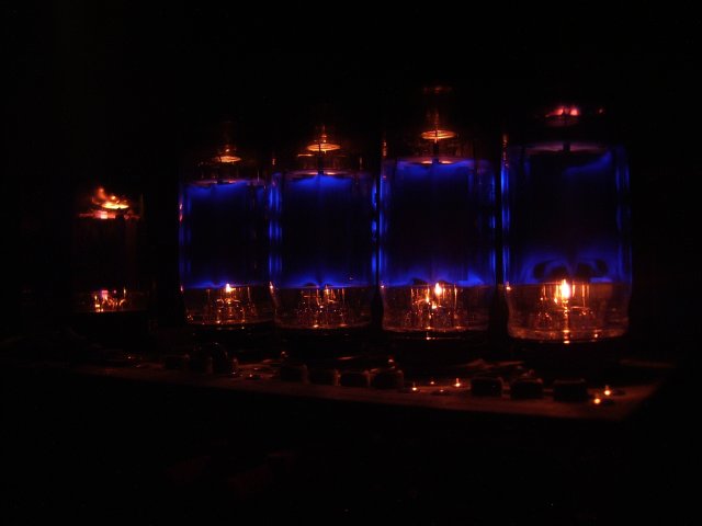

One thing I noted last night during a bout of extended operation was that the power transformer was getting warm (somewhere between 45C and 50C). Speaking for the novice, for a metal surface with high heat capacity, 50C is ~10 seconds uncomfortable, meaning you can leave your finger on for ~10 seconds before really needing to pull it off. 55C is ~5 seconds uncomfortable, and 60C is ~1 second uncomfortable. Such is the nature of the non-linear thermometer built in to our sense of touch to protect us from our own insatiable curiosity. Glass and plastic surfaces with lower heat capacity have higher "uncomfortable" temperatures. This realization is actually acknowledged in UL specifications for maximum allowable surface temperature.
Anyway, my power transformer is getting warm. A temperature rise of 25-35C above ambient is actually very conservative design for a power transformer. If an engineer did that these days, the bean counters would no doubt be all over him for wasting money on excess copper.
However, my spider-sense is tingling, so one of the things I'll do when the amp is down in the basement for mods is to add the top panel tip jacks for monitoring output stage bias current that I meant to have all along, just so I can keep watch to make certain that the bias current in the output stage isn't slowly running away with me. Probably not, but it never hurts to check. Even if there are no problems, the top panel jacks will come in useful when it comes time to load in another set of output tubes.
