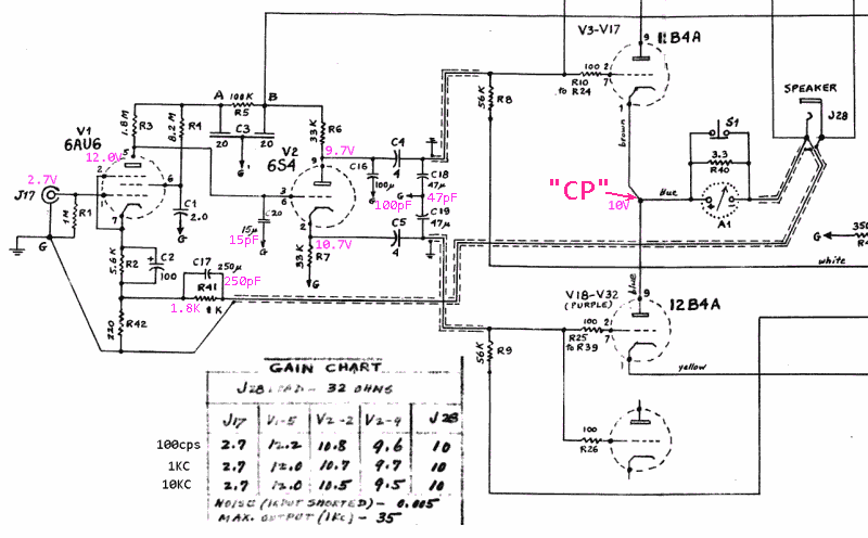

"CP" comes from transistor amp jargon (sorry). This is a Totem Pole output, one stacked above another. (Or 15 over 15.) The load is taken at the center of the totem-pole, the Center Point. The voltage here normally should be roughly "centered" between the supply rails; for capacitorless output with a center-tap power supply it should be really close to power "zero" so no big DC flows in the speaker.

Some notes on the plans shown in #22:
R41's value is unclear on schematic; parts list shows 1.8K.
The small caps are noted as "u" but can't be microFarads. They would be mmf or uuf in those days. I assume a note (not found) or shop convention says "all caps in uf"; then another u on the cap makes uuf or what we now call pFd.
Sheet 3 shows "Gain Chart" with audio voltages at three frequencies. 2.7V in makes 10V out. Observed gain of 3.7. However R41 R42 imply a gain of 9.18 max. If NFB is large we would expect gain near 9. Why the difference?
6AU6 with the super high 1.8Meg plate load should have gain over 400 over the lower audio band. The rest of the amp should be around unity gain. Cathodyne is shown with gain of ~~0.8. Upper power bottles have gain <1. Lower power bottles may have stand-alone gain over 2. The combined gain may be 0.9-1.0. So the forward gain is over 280, the gain-set is 9.18, we have 31:1 excess gain and expect gain error of like 3%. The amp working gain should be 8.8, needing 1.12V in for 10V out.
Gain difference not clear here.
Each set of fifteen 12B4 parallel @22mA each makes a triode with Mu still near 6.5. Gm is near 94uMho or 0.094S, equivalent to 10.6 Ohms effective cathode resistance. rp is about 87 Ohms.
So there is 43 Ohms of plate resistance shunting the 32 Ohm load. A pretty fair part of the audio output happens as plate-heat rather than voice-coil heat (and sound).
The output load is 43||32 or 18.4 Ohms. Disregarding active combining, the upper bottles have gain of 18.4/(10.4+18.4) or 0.63. The lower bottles have gain of 18.4/10.6 or 1.7. Output stage gain may be near 1.18, as a very approximate tangent on a significantly bent gain curve.
About loading vs THD: yes, in single ended triode amps a 5*rp load gives low THD without large loss of power. When the customer wants power too, we often go to 2*rp. The higher power may play low-power with THD similar to the 5X load, but won't go splatt so soon.
But in Push-Pull all that curvature of rp that we were trying to mitigate with high RL "cancels". The THD does not vary much with different loads, only the available power.

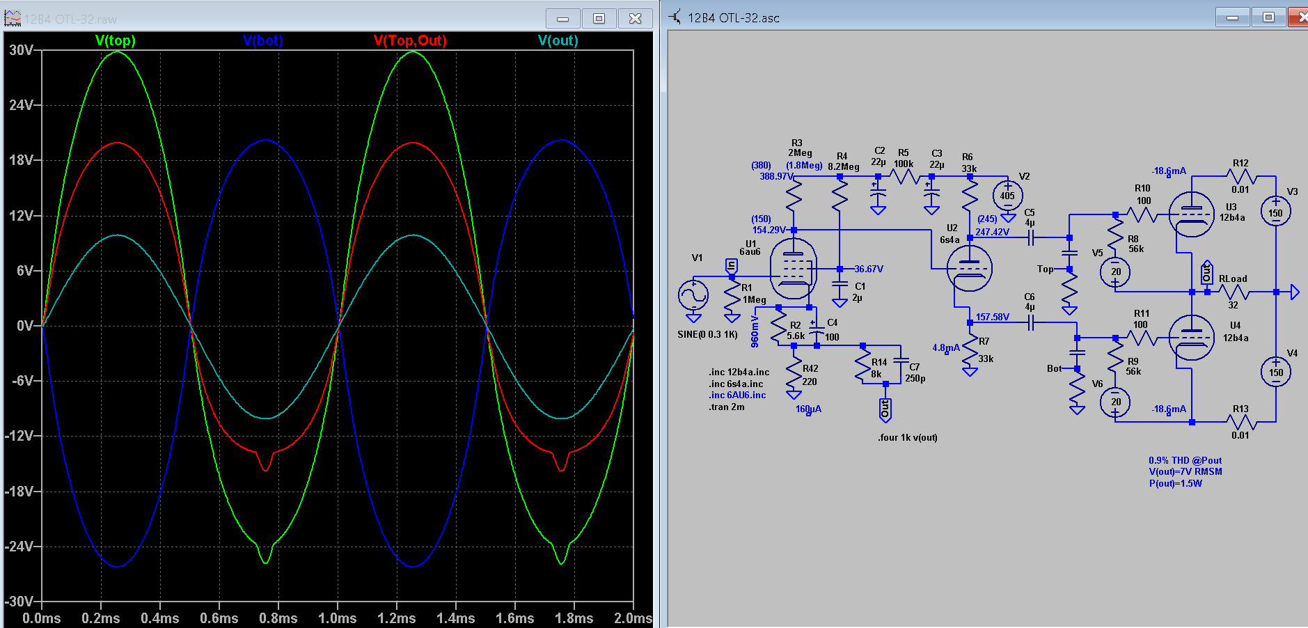

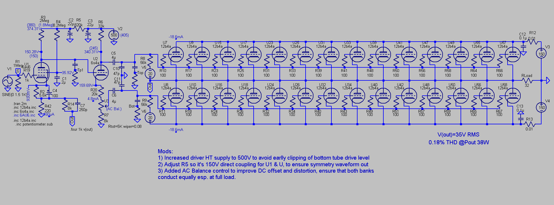

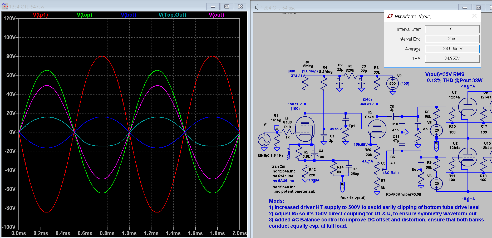

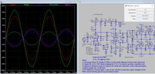

A lot of comment writings from you guys, how much a SIM for a change 🙂
For a pair of 12BH4A, the amp is quite well behaved but performed very badly with 14 pairs: a huge DC offset and much lower power output (<20W), high distortion than expected (what do think is the actual power out?), thank you for sharing.
Simulation tubes should be -perfectly- matched. Seems odd that more of them would perform worse? (Oh, I see, the 2nd plot is for the 15 and 15 tubes with some matching, 15X the # of tubes makes for 15X the loop gain for the global N Fdbk) The 2nd harmonic distortion is pretty obvious for the 2 tube output without balanced gains. Looks like more than 0.9%. 30V + peaks versus 24V - peaks.
I notice that the gain equalization is not the same however as the Futterman scheme. Might try that instead, since it involves some local N Fdbk that might change the picture across low signal to high signal. Particularly for the DC offset. The present gain balancing may have DC matching different from AC matching. I think Futterman's scheme should get the two (AC & DC) to match together at the same setting.
A quick estimate: 27 V peak 1st harmonic, + - 3 V peak 2nd harmonic would give 24V and 30V peaks, which looks more like 11% dist by voltage, or 1.2% by power. OK, not that far from 0.9%.
Then 15X the tubes for 15X the loop gain (gm) should give 0.08% dist. However that includes 15X more gm that is mis-matched, not quite sure how that computes without some serious math.
I think I estimated 50 Watts output (with matched gains), depends on how far the 105 mA peak rating was "pushed", 38 Watts seems reasonable enough. Mis-matched gains should give less power output. Maybe something like the sim'd 1.5 Watts X 15 = 22.5 Watts out. That would be a pretty heavy "hit" for not matching the bank gains. Or significantly hotter tubes if pushed to the same 38 watts out. The tube curves for 0 V grid1 limit how far one can go, unless pushed into positive grid territory.
"Seems odd that more of them would perform worse?"
More tubes more Gm (you notice that the output stage gain of 14 pairs is higher than 1 pair?), higher output voltage, totem-pole is sensitive to load and output level, higher voltage required additional gain drive for the top bank and lesser gain drive for bottom bank with equal Gm added. In the Tim Mellow's OTL, it has 100% NFB bootstraped for lower bank and 100% PFB for upper bank (via LTP), it's least sensitive to load change and tube numbers.
“Looks like more than 0.9%. 30V + peaks versus 24V - peaks. ”
Not you should read the plot V(out) not V(top).
If you have AC balance, you automatically get DC balance provided the PSU is equally rigid, and tube equally matched for AC and DC, but the driver can compensate somewhat for output tubes.
That model is AWESOME! I wish I better understood it but very cool that you took the time to build it.
Is your reference to "a pair of 12BH4A" a typo? Tubes are 12B4A.
Also just curious about this: why 14 pair instead of 15? Just wondering.
As for the power out, in the lower, right corner of the gain chart (see post #22) there is a note: MAX OUTPUT (1Kc) - 35.
Seems low for all the hardware involved, but it may be so.

“Is your reference to "a pair of 12BH4A" a typo? Tubes are 12B4A.”
Yes, it's a typo, sorry.
"Also just curious about this: why 14 pair instead of 15? Just wondering."
Yes I missed count: V3-V17=15 not 14, I will edit for 15 pairs and AC Bal is moded again so it'll use NFB to better control the gain of top and bottom bank, after this mode the output has increased to 63W (14 pairs), I post asap I edited it.

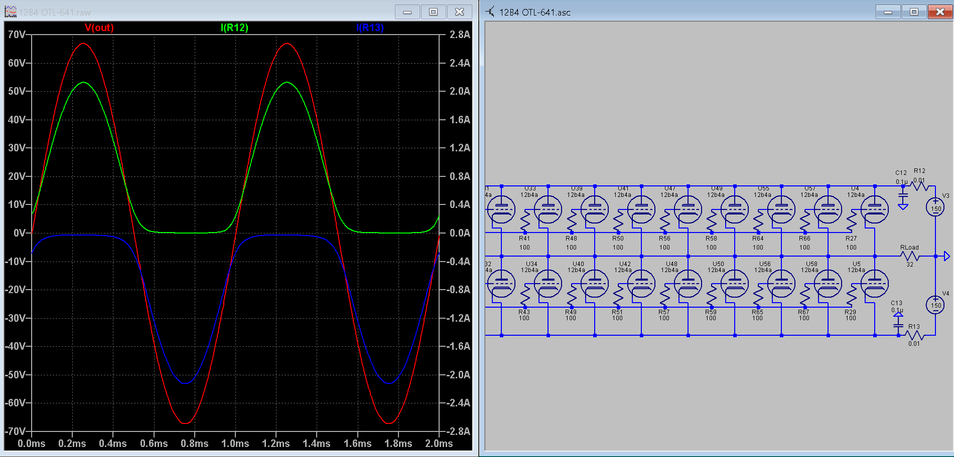

Here is the edited version, now 15 pairs, 70W. Included also the current waveform for top and bottom bank, shows a peak of 2.1A, or 140mA each tube (look like it has exceed the max current of 105mA), if momentary should be ok.
Athough this is not my own project, but doing it helps a lot to improve my own OTL amp, so worth the effort.
Very nice! Staying within the 105 mA tube limit should then give 70W x (105/140)^2 = 40 Watts. Apparently the amp is rated 35 Watts (without the balancing fix in place).
Did you notice the distortion level at 40 Watts output?
Another interesting question would be how -inverted- Futterman drive compares.
(positive Fdbk to the top bank instead of neg. Fdbk to the lower bank) I would guess they come out fairly similar for the same total tube gain available.
Oh, and the output Z's too.

I think I spotted one more error;
As PRR pointed out in an earlier post, R41 is not very well identified in the original schematic, however, it is shown in the parts list as being 1.8K. You show this resistor as R14 with a value of 8K.
Might make a difference.
Thanks,
Joe Y
THD@40W is about 0.17%
I'll make the comparision asap, no much difference so long the amount of NFB used does it job (optimized) and not overdo it (can it?)
Here is the output Z:-
Output Z: 15 pairs
The input resistor 1Meg is shorted to aviod interference
1) Output stage only 17.7 Ohms
2) All stages in but no NFB 8 Ohms
3) Connect GNFB but remove NFB from phase splitter 0.4 Ohms
4) Connect GNFB, NFB to phase spiltter 0.35 Ohms
Very Cool! <snip>
In schematic it's 8k but in part list it's 1.8k.
I try to use 1.8k but the sensitive is way down, at 8v in, still not full power out and clipping set in. So it's more likely to be 8k, the bias is about 1V, the sensitive is 1.9v to full power.
Output Z, input short, sig gen removed, GNFB removed, only NFB to phase splitter:
MP/Inv-Futterman 14.1/5.25 Ohms
Edit: Original MP has no NFB in phase splitter, output Z is 8 Ohms, while for inv-Futterman whether NFB connected or not doesn't make much differences. (5+ Ohms), the raise of Z means there is an increased in overall gain, and if GNFB is finally applied the overall Z would be lower than inv-Futterman. You think so also?
