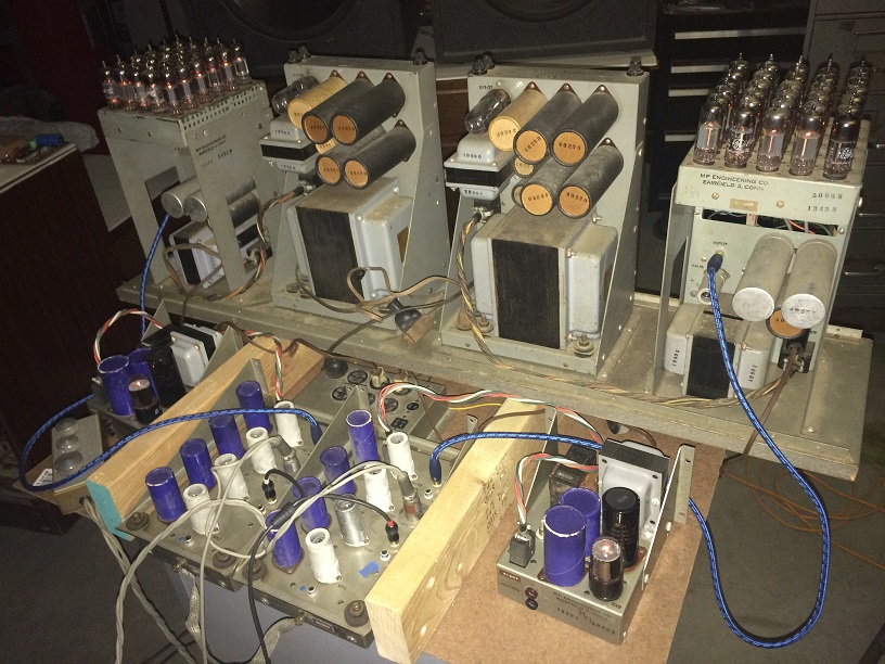

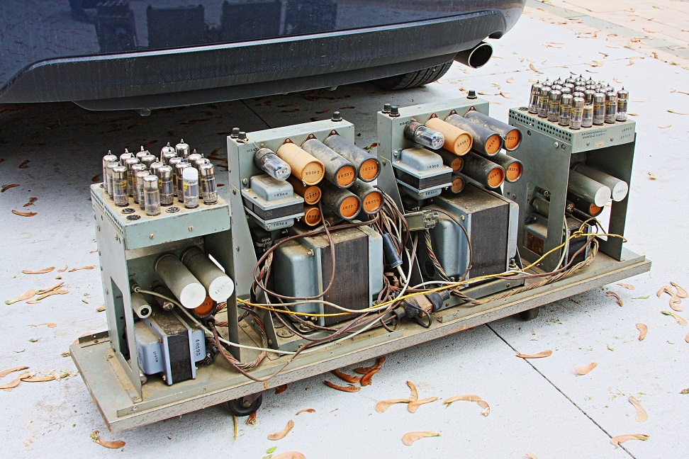

Killer OTLs
Here's a pair of OTL amps that were built in the early 60's by a small company named MP Concert Installations.
The system consists of 8 chassis: pre-amp, pre-amp power supply, power amp, power amp power supply and then X2 for stereo.
I acquired these about two years ago.

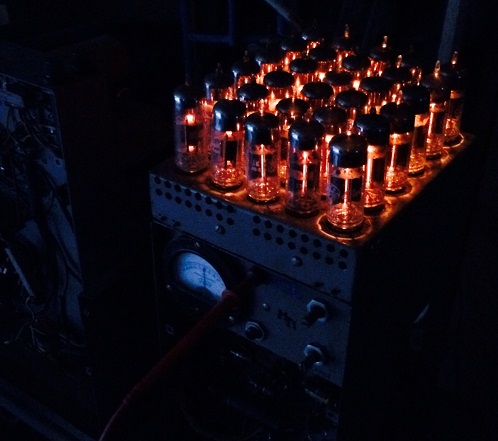

They don't seem to have read the RCA manual on safe spacing of tubes!
Maybe there is a big fan that blows on each bank of tubes?
Geez, 12B4 are only good for 30 mA each. Someone must have requested this strange design. I can't see marketing that.

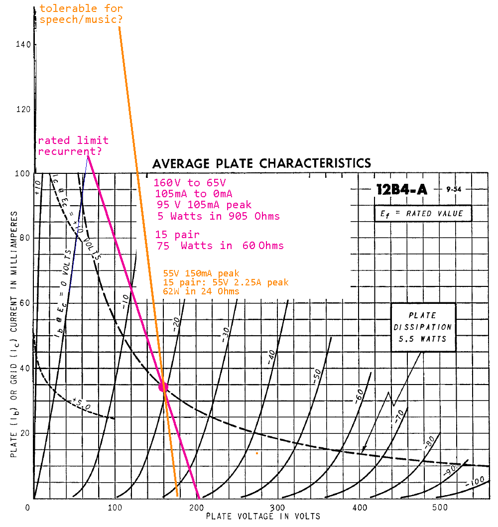

...Geez, 12B4 are only good for 30 mA each.....
But 105mA Peak. The most peak in the smallest bottle of any TV-shop tube.
The rp/30 number is a miss. We have to swing the peaks with only 15 tubes. Assuming 105mA it works to 75 Watts in 60 Ohms. Not shabby, if the load can be 60 Ohms.
The rating is for TV V-sweep duty, 105mA peak 60 times a second 6 hours a day all year. Speech/music does not peak very often. If 12B4 are inexpensive, we can hit them harder. Plotting 150mA peak gets near 62W in 24 Ohms. If the speakers turn out to be 30-60r where it matters, the power will be in this 60W-70W range.
The load goes over the Pdiss line. This can be OK. For full-Sine power output, we should compute or measure the plate dissipation. For speech/music, this much over-Pdiss will be fine.
Other plots are possible. 12B4 has positive-grid plots, and we could work-out a class 2 design. But Ig goes up so fast the drive requirements get huge before much is gained.
