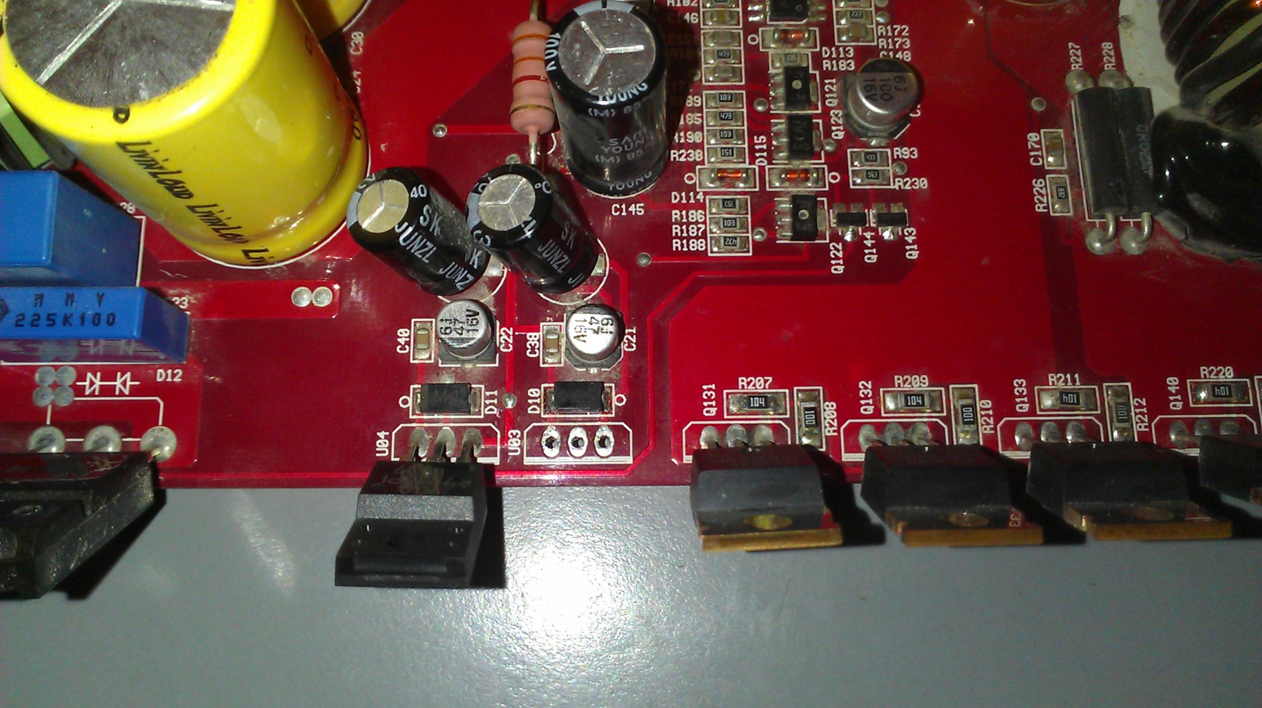

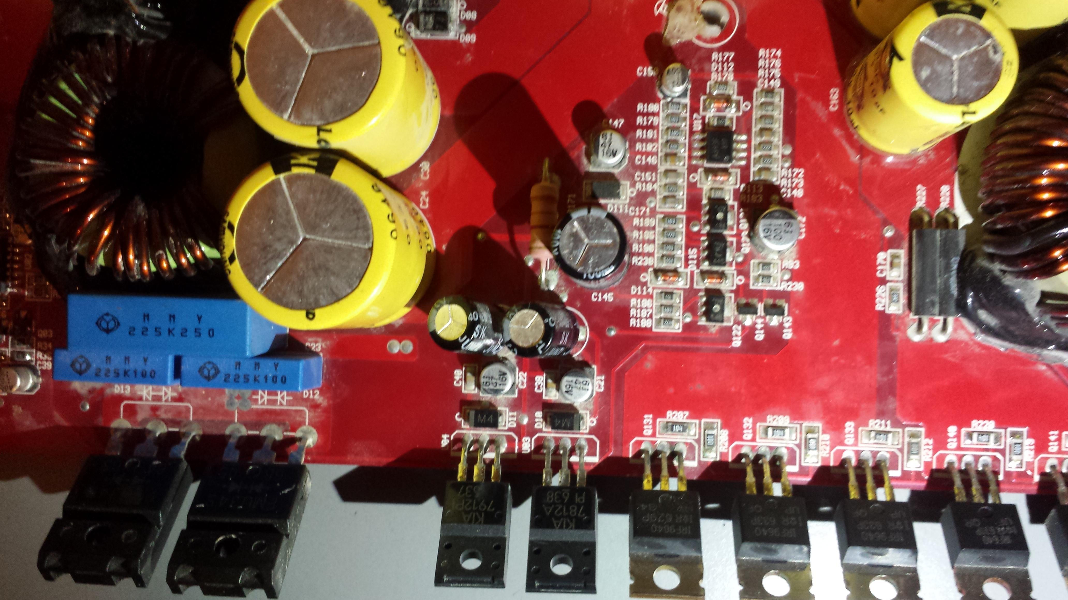

You will see a half dozen parts around the 7812. a couple of capacitors and resistors. Can you take a close up of the 7812 and surrounding parts so that I can inspect the parts? I will study the pics you have sent and let you know what resistors and capacitors you should check with the ohmmeter( Power off of course :0) after you send me a pic, can you remove the shorted 7812?

Okay, here is a close up picture. It's the KIA7812A on the right side of the two KIA's. And yes, if you would like me to remove the mosfet, I can.
But again--new at this, so what is the correct and safest way to remove/solder? What gauge of soldering wire will be needed to solder it back together? And what kind would you recommend? I know there's wire with and without lead. Didn't know if that would matter too much.

Short the power and ground terminals, I use a pair of needle nose pliers, or you could use a length of wire,speaker cable or lamp cord will do. You can use 60/40 .6mm or medium gauge solder purchased from Radio Shack or a home improvement store such as Lowes or Home Depot. Do you have a solder iron? And you may want to purchase a desolder tool, its a plunger that sucks up the solder and maybe some solder wick/braid. when you replace any parts you'll need to clean up the solder left in and on the pads/via's so that you can install new part/s.
After you remove the 7812 check the resistances from power ground terminal to all three of the holes where the 7812 was. Tell me what you find. I'll will consult my schematics tomorrow. I think the 7812 and maybe the LM361 will need to be replaced, all though there may be one or two more parts to replace. If you have a Radio Shack you might find the 7812 there and any tools or solder you'll need.

To remove the 7812 you can use the desolder tool, when you heat a joint with your iron and melt the solder, the desolder tool will suck up the solder. The desolder tool is a plunger and after you push in the plunger it will lock, and when your ready pushing the button on the side will release the plunger creating a vacuum and suck up the solder. The tip of the desolder tool should be as close as possibly without touching the hot solder, after you've done it a few times it will become easier. If you have a PCB lying around that can be used as a practice board that would be a good exercise. The solder braid or wick isn't necessary, it just adds a finer touch to the clean up.

Okay I have the 7812A out but now need to get a new probe for my multi.

But I have pictures of it and the new 7812 came in the mail today

Okay got new test leads for multi and a new solder iron selectable 20-40 watt ... my very old 30 watt one seems to take forever to heat the solder taking 7812 out
I did the resistance test that you ask for Multi was set at 200M Ohm + and - terminals jumped black lead on terminals and red testing
Pins
1: 1.1
2: 0.9
3: 0.9
If these seem right to you I will go ahead and solder my new 7812A
