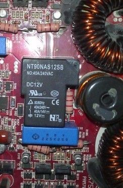

Lets see if the relay is working. With your ohm meter put one probe on the positive speaker terminal(if you have a way of clipping the probe to the terminal,so that you have one hand free,do it) and the other probe on the side closest to the speaker terms of the small coil with the black core, standing up between the doughnut shaped output coils(Toroid). Before you apply power you should read a high or infinite resistances.After you power up the amp the resistance should drop to near zero. If this is not the case the the relay is bad or bad solder or open via.Let me know what you find.

What relay are you talking about
And how would I get to the pins to a relay

Okay coil standing up between two doughnut ones... Pin that connects right by the big black relay?
4.1 off
.6 on
4.1 off
.6 on
I will send you a pic when I have a chance.the relay is the black box with NT90NAS12SB. the leg of the coil next to it is the same point electrically of the input of relay.The pos spkr term is the same point as the output of relay.These points are convenient test points, to place your meter probes. the 4.1 off and .5 on are they voltages or resistances?

I think the meter is telling you 4.1kohms (k is short for kilo or 1000) or another way to put it is 4100 ohms and the .5 is 1/2 an ohm,which should be about right. Have you heard the relay click on, it may be a soft click. I was not able to hear the turn off click in the your youtube video, but if you hear it, I'll take your word for it, and pretty sure the relay is ok.

Oh and about the Relay.
I never hear it click on and only Hear on click off... But like I said the one I hear click off isn't the Big Black one that we been testing. This clicks sounds more like from the Power Side Of the Board By the Big Doughnut Coil.
there is one relay in the amp.It may be difficult to localize the sound but I'm sure it is the relay. I'm not 100% sure the relay Is passing audio, but we'll get back to it later.redo the AC voltmeter test, and turn the gain control up and down. Your meter is looking at a changing AC voltage and that is why you will not see a consistant unchanging reading. turning the gain control will give you a better idea that the amp is passing audio. As you turn it up the average voltage will be higher and turning it down will have the opposite effect. use the same test points. we are bisected the amp, to isolate where the audio stops. when we have a better idea then I will give you a different set of test point to further narrow down the fault.
http://i963.photobucket.com/albums/ae119/Mrpapazbill/vi39c2_zpsf41d2e82.jpg
I posted this to point out the relay and to learn how to post pics on this forum :0)

I meant to suggest a test tone, I forget there is an app for that! Good thinking! 40 hz is the perfect test tone for this test and its what I use. the result show the amp is working and passing signal up to the relay, so either the relay is bad or a bad solder joint or an open via. there is a small diode D92 on the left hand side of relay. power up amp and check the DC voltage with one probe on neg power terminal and the other probe check voltage on either side of diode.
