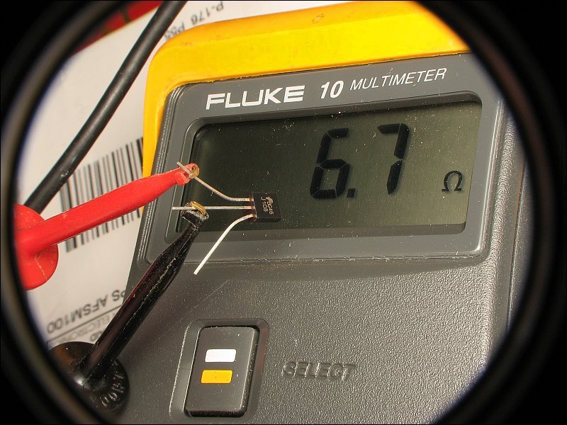

Hi all, does anyone know the number of Q101 on the main board. The sub in, off of the input board, is fed to this transistor through a resistor and cap. The transistor is shorting the signal to ground. The number on the transistor is BA21. I tried searching specks for this on line. Any help would be appreciated. Thanks.

That's what I'm thinking maybe a J109 and it will normally read low in circuit.If the muting voltage is low (normally +10v I think).If this voltage is wrong it will ground the input signal.
Sent from my HTC Desire 626 using Tapatalk
The J108/109 appear shorted when there is no bias voltage on their gate.
Fairchild often puts the part number below the production code.
