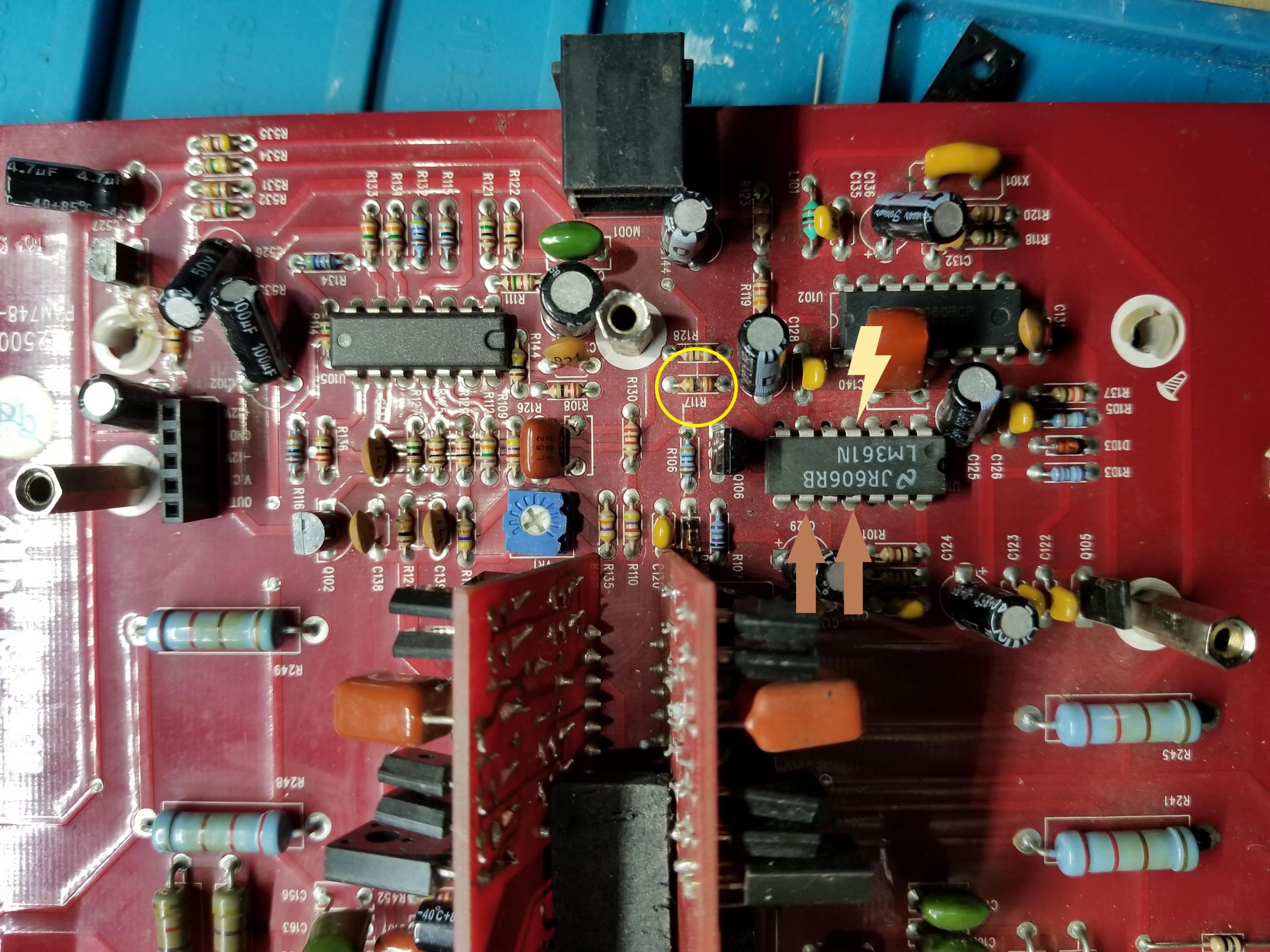

R117 looks to be burnt or taken heat at one time.
The attachment shows testpoints for the Class D circuit.
Brown arrows- Test points for the drive waveforms. Again you should see waveforms similar to the drive waveforms in power supply.
Yellow Lighting Bolt- This will be a triangle waveform. Without it the LM361 comparator has no reference and will not produce drive waveforms.
Yellow circle- R117- This may indicate why the class D may not be working. I need to check schematics to see what it is tied too.
Again I know this is a lot, but the more I'm able to see what the test points look like, the better I'm able to point you in the right direction

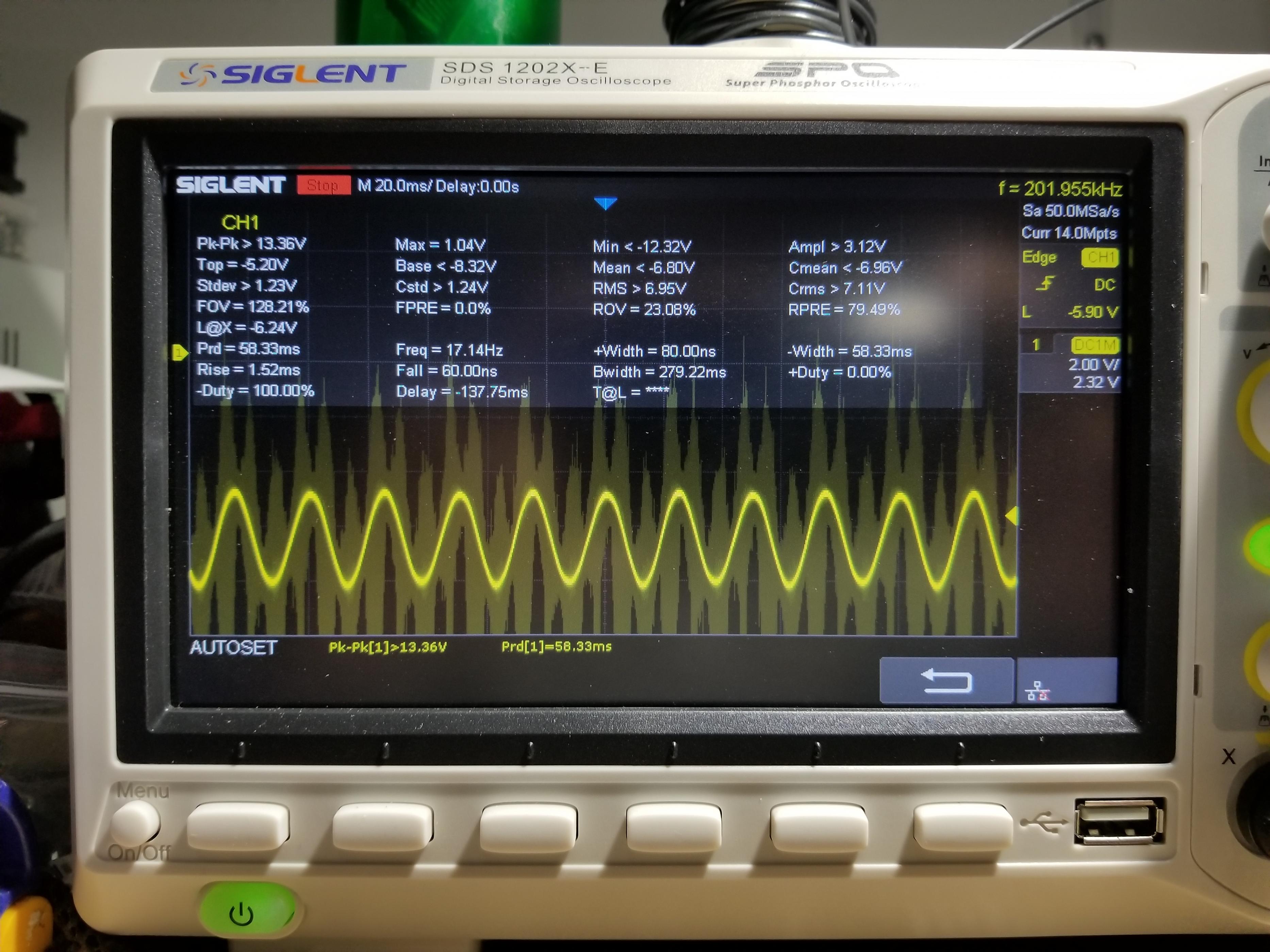

+/-12 on preamp board present. So is the 40hrtz sinwave.

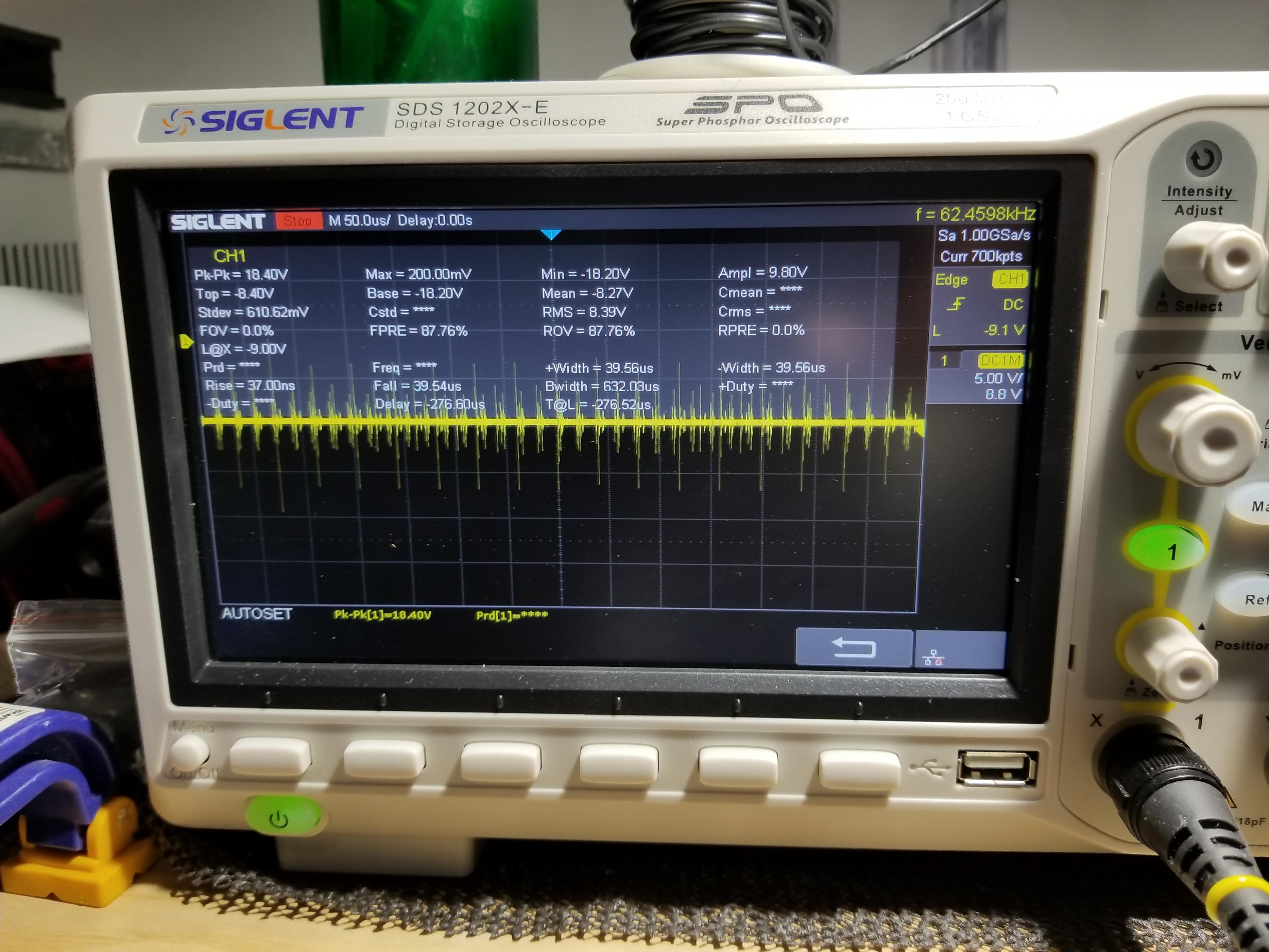

I can't get the scope to view any drive signals at the gates without signal.
This is at the out pin of the preamp board. I been trying to find a drive signal. I had a very small sqaurewave before I installed the output transistors. Only signal I can see is faint on the n channel transistors gates with the signal.

The screenshot you just posted is what I would expect. I leaning toward an issue with the Class D circuit. It's possible the LM361 and or U102 is not getting its operating voltages.R117?

In either case the fact that you have a triangle wave and no drive waveform tells me the LM361 is failing or not getting the right operating voltages.
