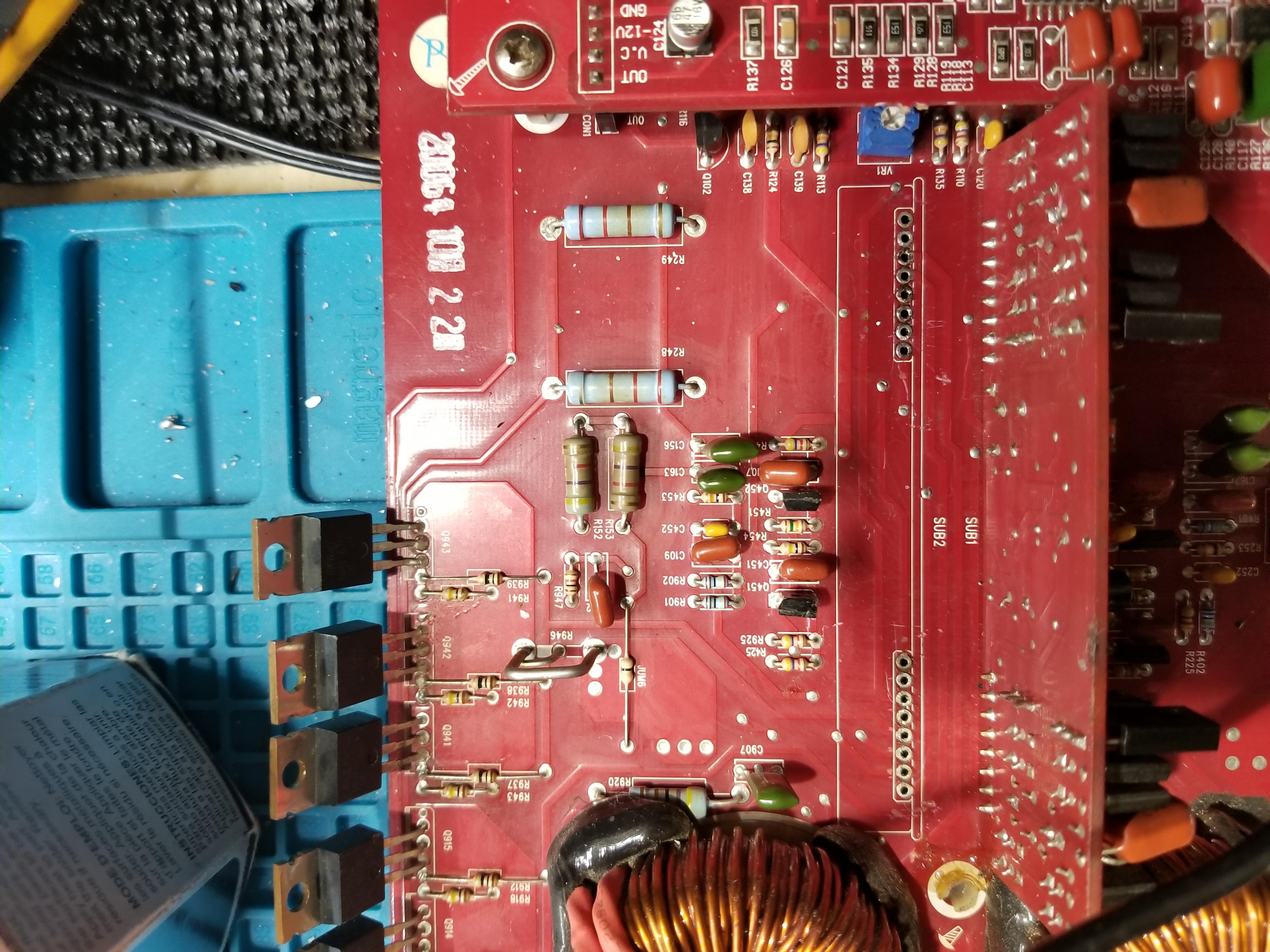

Remove the suspected bad driver board and with the opposite side driver board still in place check to see if you have drive to the other side. If so, remove good board and install in place of suspected bad board. If swapping the boards proves good, I can walk you through repairing the bad board. Post pics of the driver boards when you have removed them, so that I can edit and show you possible failed parts.

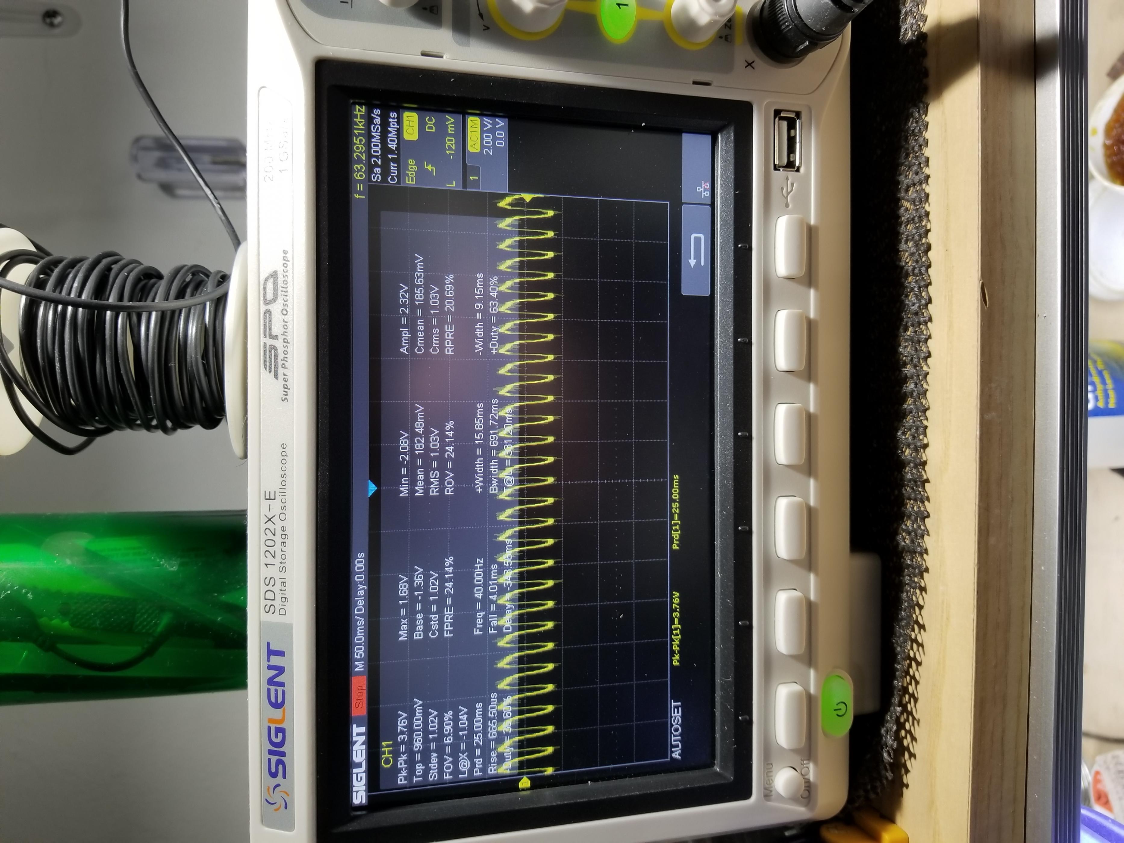

Yes I have a scope, just not that well trained to what I am looking at on it. I know to look for drive wave forms in ps. And I can get this on accept coupling, at the high side gate resistor with signal. 40hrtz 4v sine wave. And on a voltmeter they have 7.2vdc across them. Relay is clicking once. Some of the transistors on the driver boards are reaching 112°f c3503 the output remain cold as do the ps mosfets. I have a good 40hrtz on the pin labeled out on the preamp board.
For reference. Before I put the outputs in I had a drive signal. A small squarewave without signal. With then outputs installed I can't seem to get it to display. I believe it's just still muted. I think it's the relay now. I have these in stock.

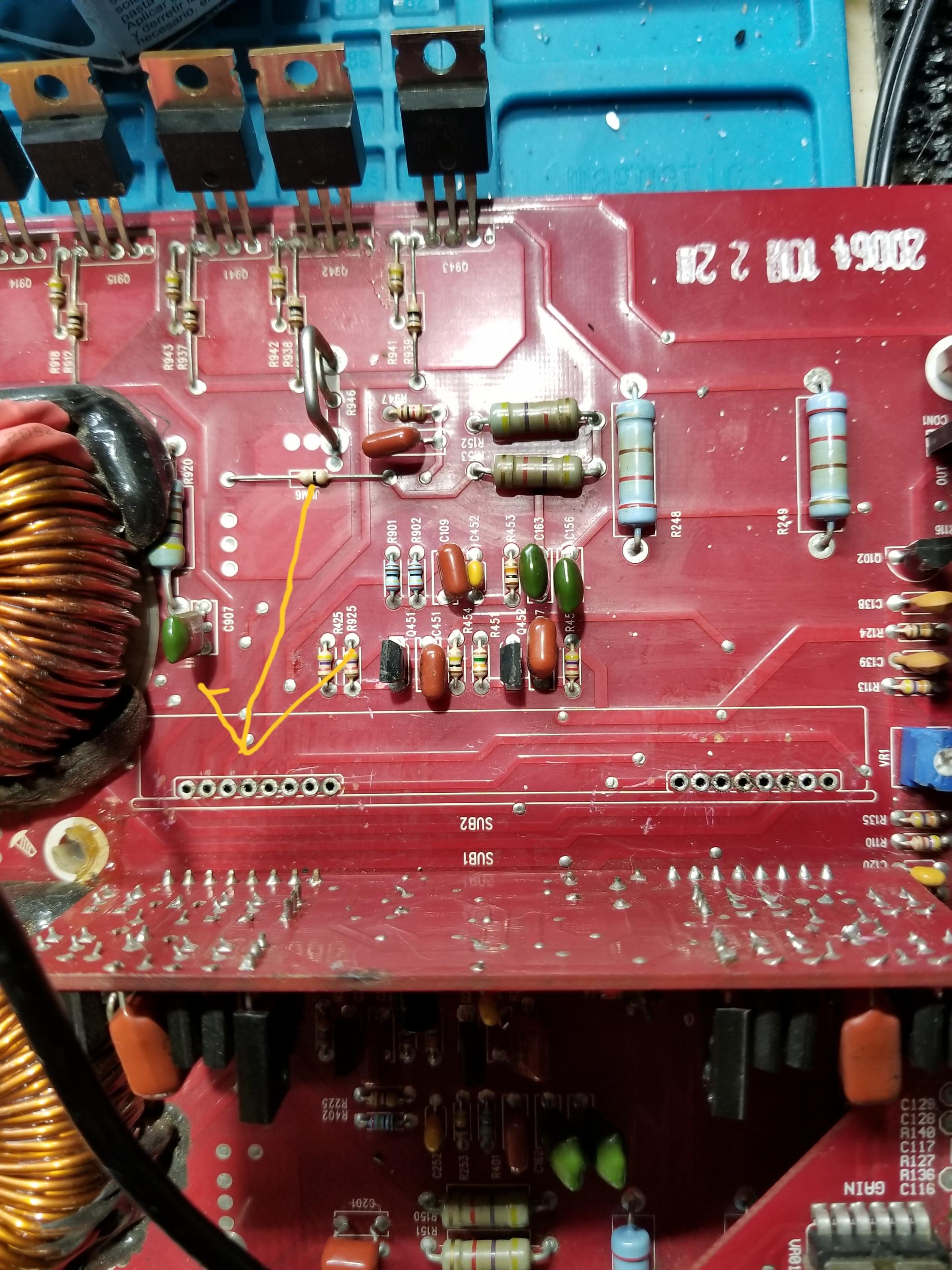

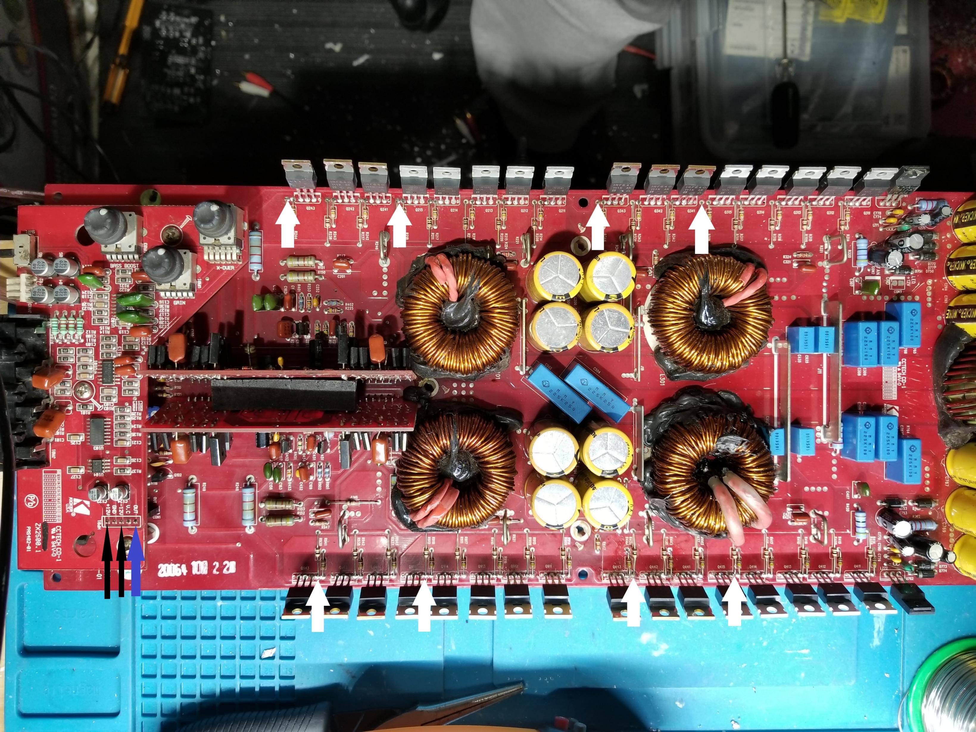

Post a picture of board from the bottom side. I will highlight test points.

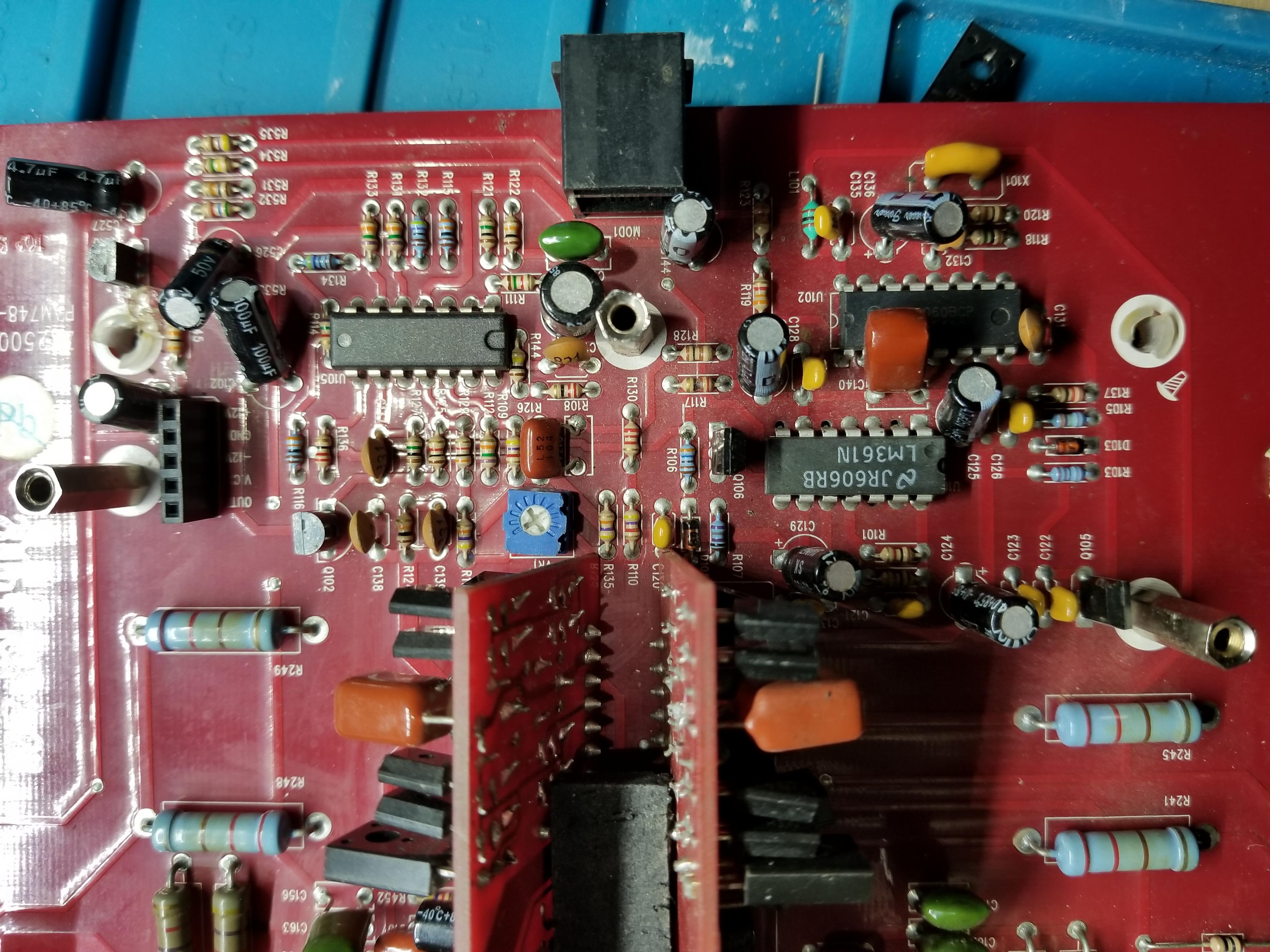

Also, remove preamp board and you will find U907,U908 and U909, this is the Class D circuit. Take a good quality picture of the Class D circuit and I will point out the test point you can probe with your scope

R117 is 22ohms. The relay I swapped out today, since I had them on hand. Same result. No signal at the output teansitors, and I have the signal coming out of 104 and at the out pin of the preamp board. The fault must be either the class d section or the driver boards. They are the only other two sections in between the preamp and the output transistors.

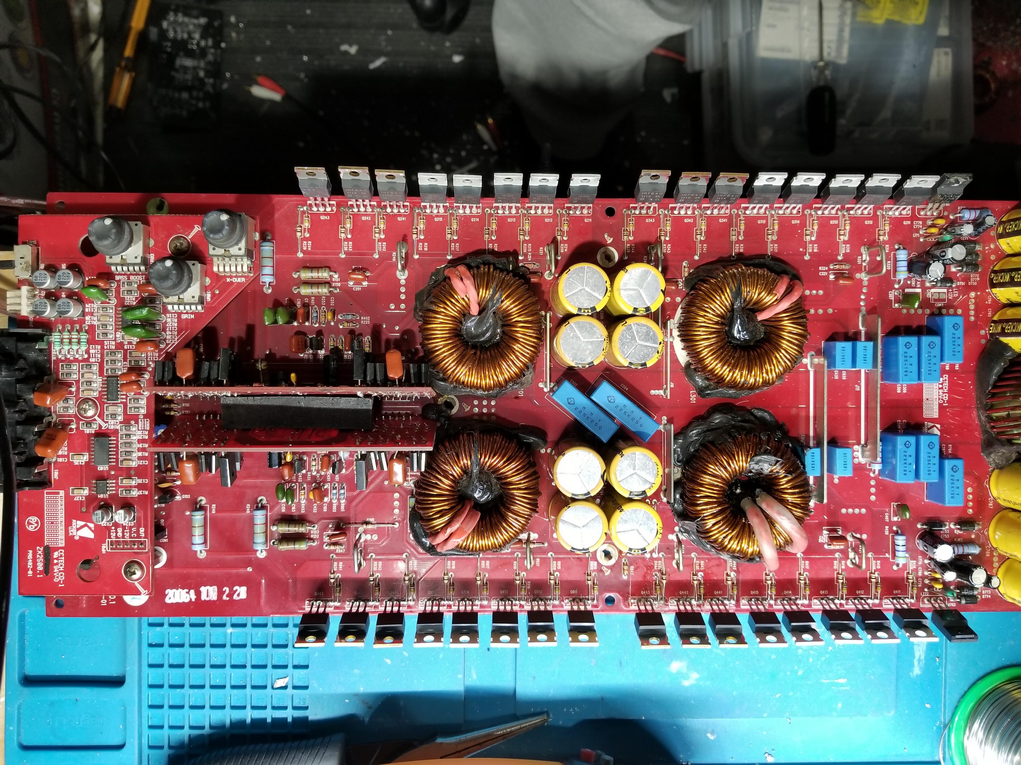

The attachment are the test points for top side of board.
White arrows- These are the gate resistors(side connected to the mosfet gates)
You should see something similar to the power supply drive with your scope,do not apply signal. Post screenshots from all eight test points.
Blue arrow- Of course this is the audio from preamp board. with the 40hz Test Tone applied, post a screenshot of this point
Black arrows- This is the +/-12 volt test points. These voltages are necessary for the preamp board and the Class D circuit and if one or both are absent you will not have output. Check with a DC Voltmeter and post if you haven't check them.

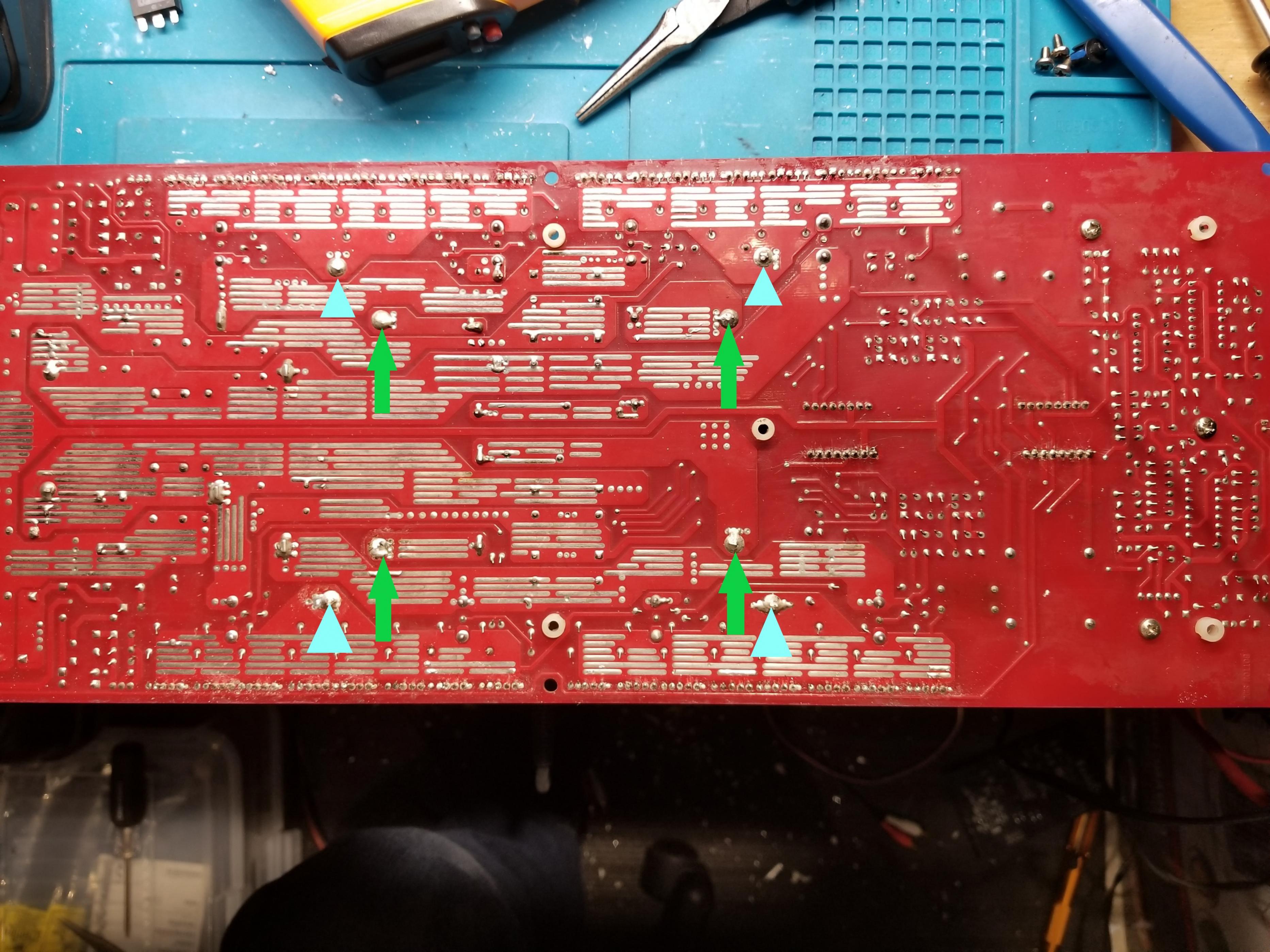

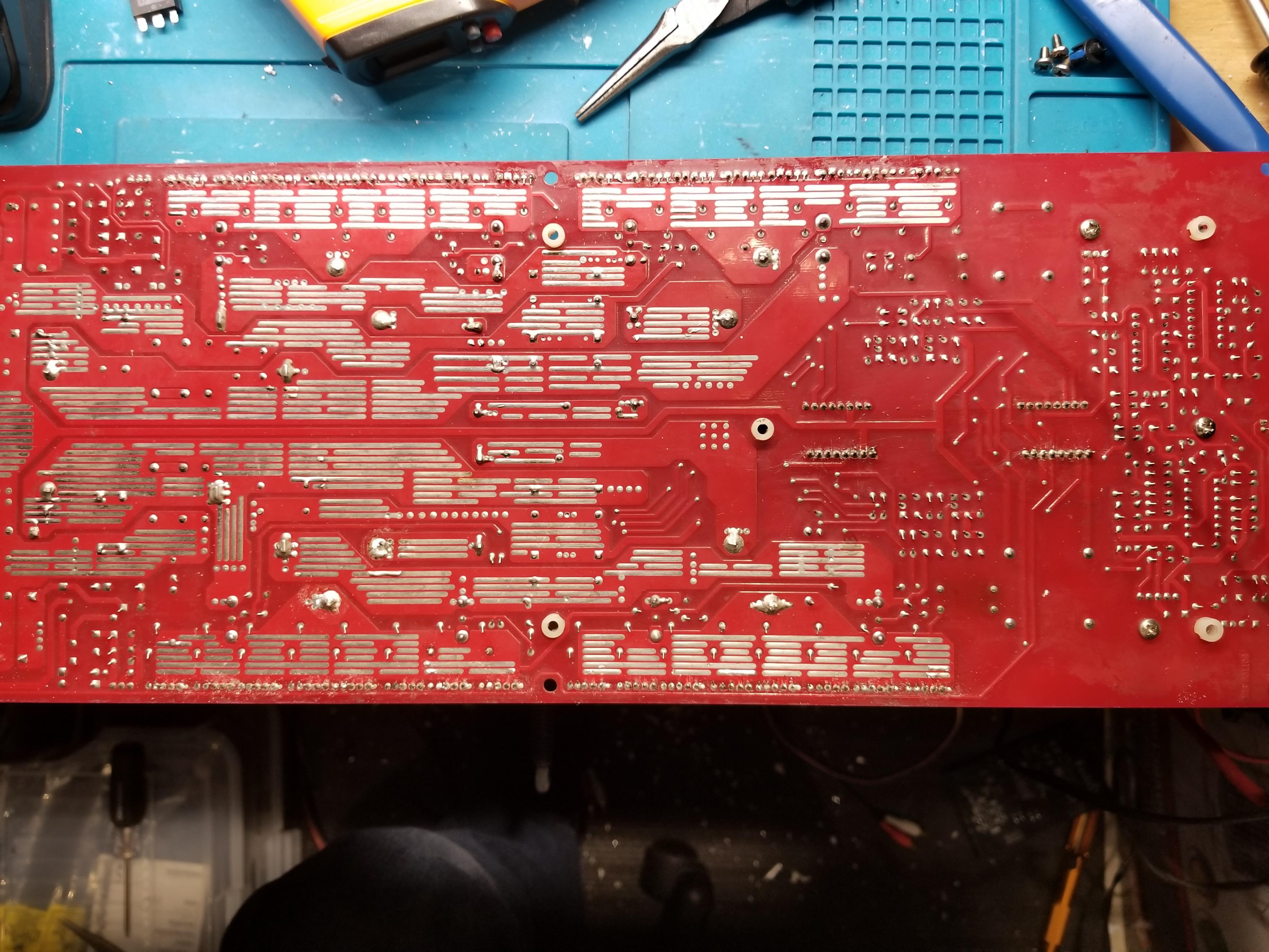

These are the test points for the bottom side
Light Blue triangles- Test points for inputs to the output inductors. With a scope and signal applied, you should see a modulated squarewave. Without signal you should see an amplified version of the drive waveform to mosfet gates.Post two pics with and w/o signal.
Green arrows- Test points for the outputs to the output inductors. With a scope and signal applied, you should see the amplified 40hz test tone which can be varied with the gain pot.
