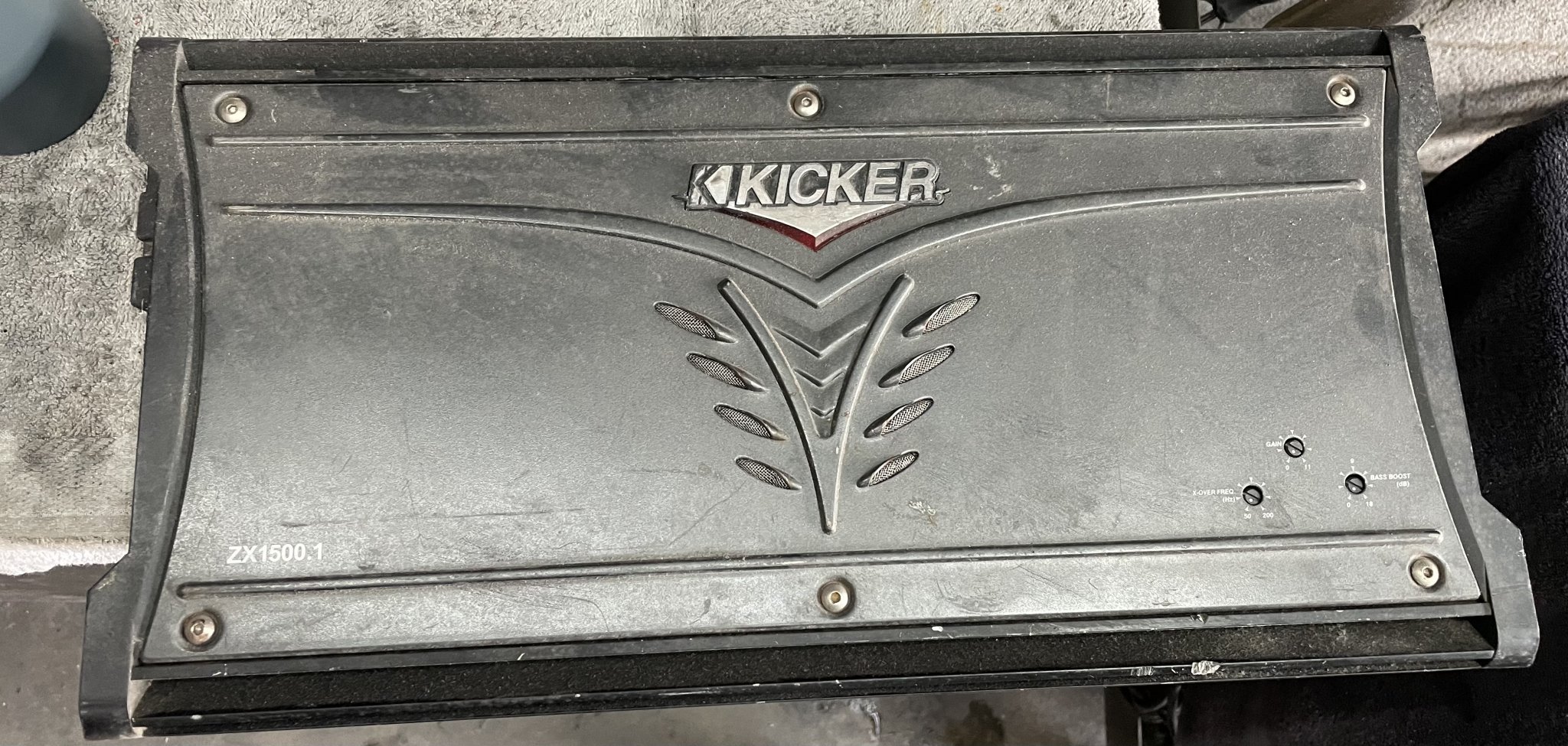

R134-47 ohm 2wAnyone have a schematic for this amp? I need help identifying components:
C66
C109
R134
C108
And also why these failed. Looks like someone replaced C66 and C109 with 10uf470v caps, and R134 is measuring 58 ohms. C108 isn't measuring anything.
Thank you
C109,C66 -10uf 200v NP
C108-1nF 630v
This amp has a unique topology and is unlike the KX1200.1 or KX600.1
Post pics of this board and main board. If you get a solid overall I can point out some test points.
Inspect the class D control board (holds the LM361). Look for L200. Is there an inductor there, or just a trace? The ZX1000.1 and ZX1500.1 share the same control board with some minor differences. The inductors being one difference. This is part of the feedback loop, which appears to be open and causing this issue.
If shorting pins 6&7 on the U200 which bypasses the opamp and essentially the feedback loop, allows drive to the output mosfets the amps Class D control, drivers and outputs are good.
