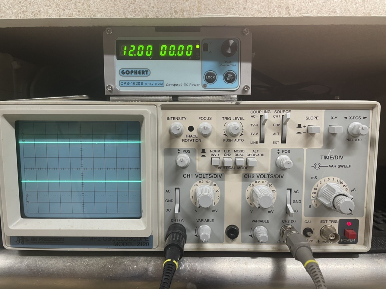

For ch2 in normal mode, touch it to 12v. It should deflect up. Now switch to invert. It should deflect down the same distance as it did up.
12v attached to both probes. ch1 probe ground to negative. Both probes at 1x.
INV1 button only inverts ch1.
There seems to be no INV2 feature on this scope.
5V/Div.
1. First photo with 1 line, is actually traces from BOTH channels at the same point at +12v.

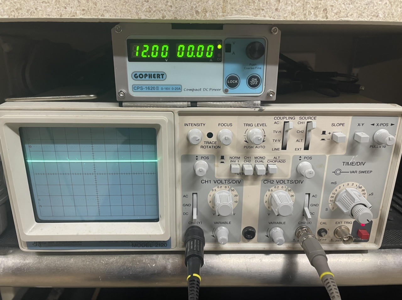

2. Second photo shows CH1 inverted with INV1 pressed. You can see the invert function is not operating correctly as the trace for CH1 is only at -6 where it should be at -12.

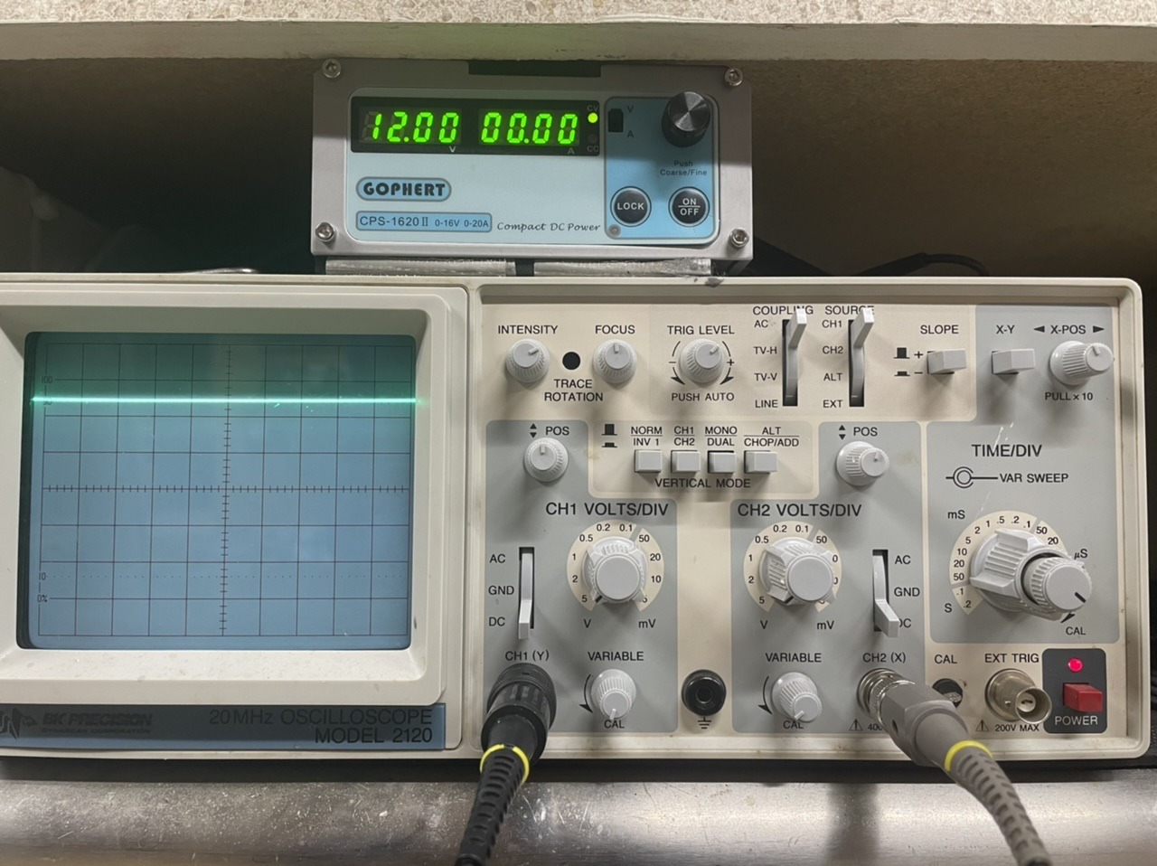

3. third photo is the differential reading. This should have been 0v but since CH1 in not inverted correctly its showing +6v

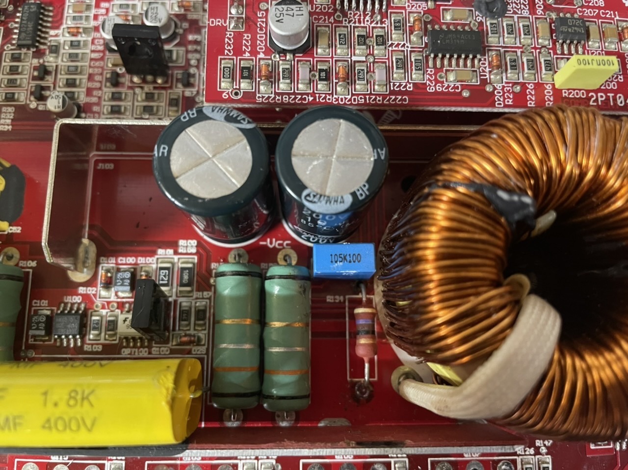

C108 the cap marked 105 is in series with R134. The two components are essentially connected to the positive and negative speaker terminals.
The blue cap is not an original. Amp came in with R134 and C108 destroyed.
The 1200 diagram shows that cap as a 1000pf (marked 102). They are R316 and C305 on the diagram. Is that what you have?
