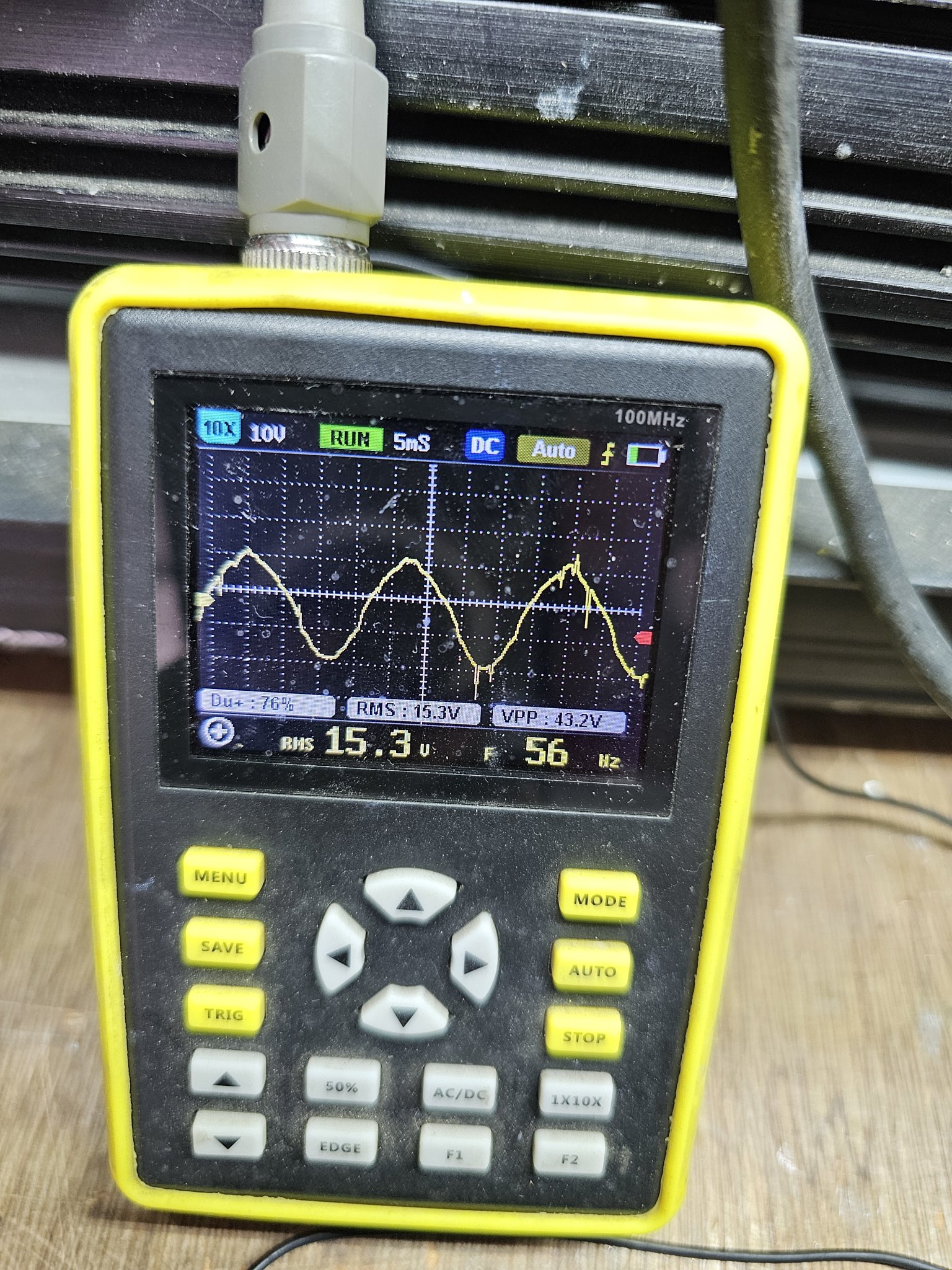

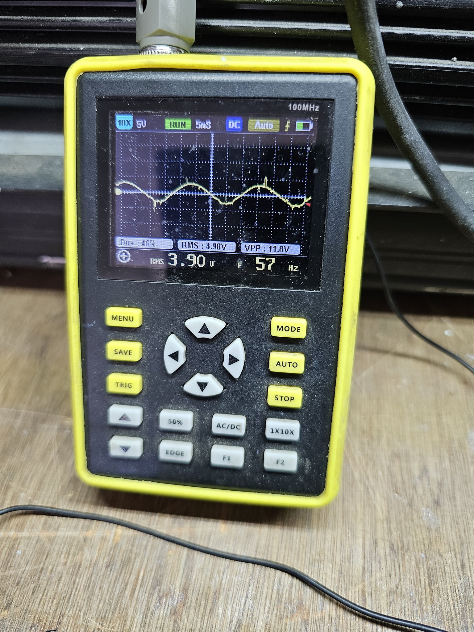

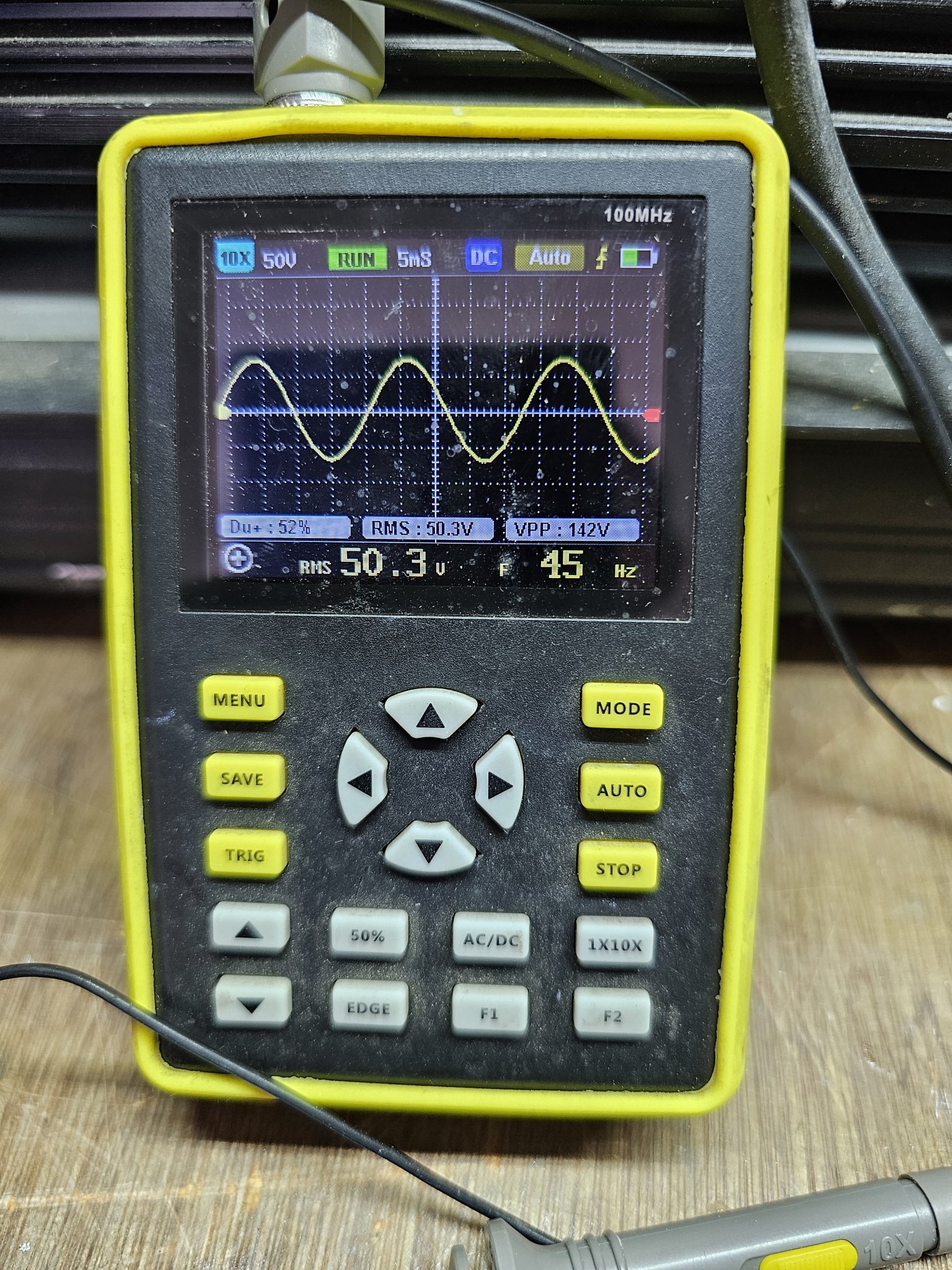

Is the scope connected directly to the two speaker terminals?
What does it look like at higher power?
