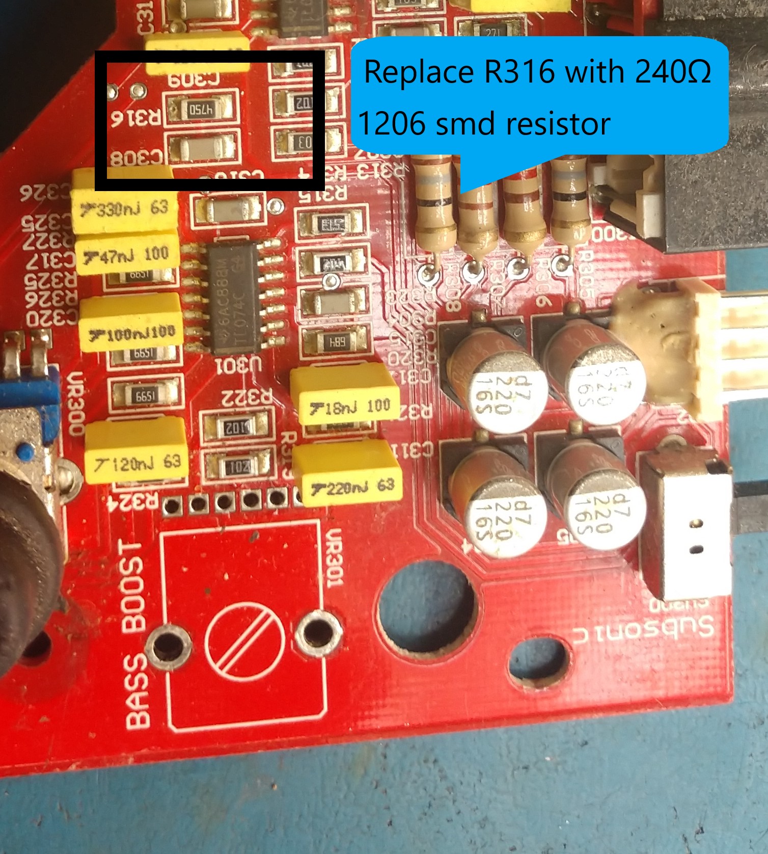

Kicker zx1000.1 question..
If and when you replace VR300 with a 10kohm VR, replace R316 picture attached with a 240 ohm 1206 smd resistor.
There was so much muck in this and the legs that touch the small board in the was bent so it didnt make contact. Ive cleaned it and bent the legs back. Hopefully this will fix it as once the gain is setup i wont touch it again.
