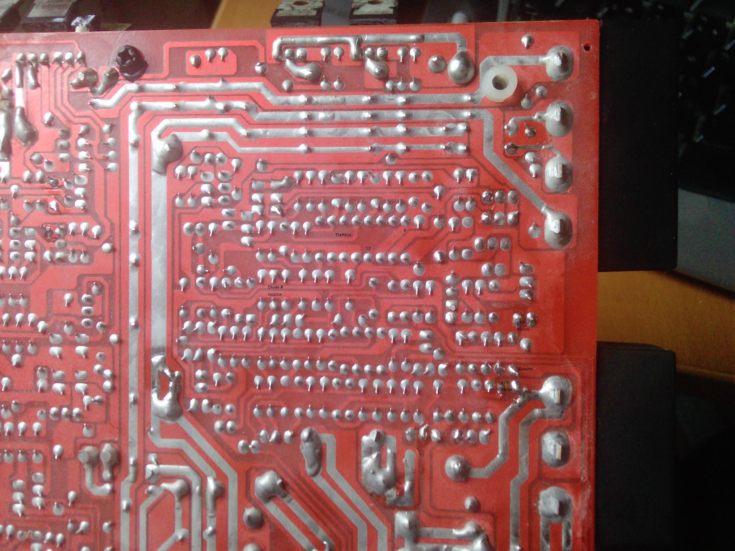

Now i have kicker zx100.2 that worn´t shot off.
r1 (100ohm) was burnd. c10 and c19 was svolen. I have change the components. But it is just on. I do not nead remote.
Power 12v to the tl494cn.
pic
Her is a pic on it

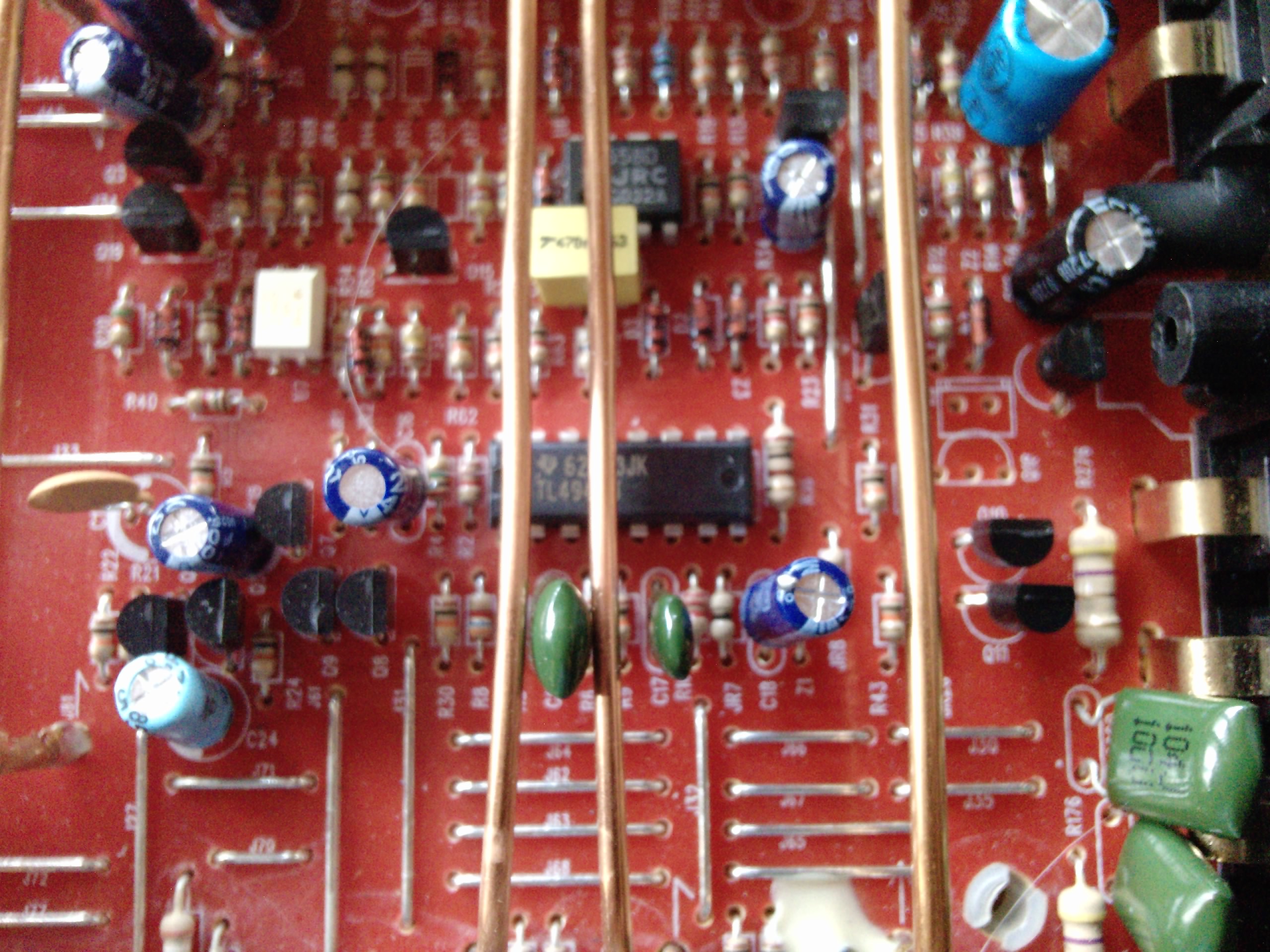

Post the DC voltage on the pins of the two circled transistors. Place the black meter probe on chassis ground. Place the red meter probe on the point where you need to measure the voltage. No remote voltage applied.
yellow
Pin 1:
Pin 2:
Pin 3:
orange
Pin 1:
Pin 2:
Pin 3:
Is the one circled in yellow a 1N4003?
It appears that the orange transistor is defective. Pull it and the amp should not power up. After pulling it, the voltage on pin 2 of the a56 should be the same as the voltage on pin 1. The voltage on pin 3 should essentially be 0v.
Are you sure that the orange one isn't a 2N4401?
