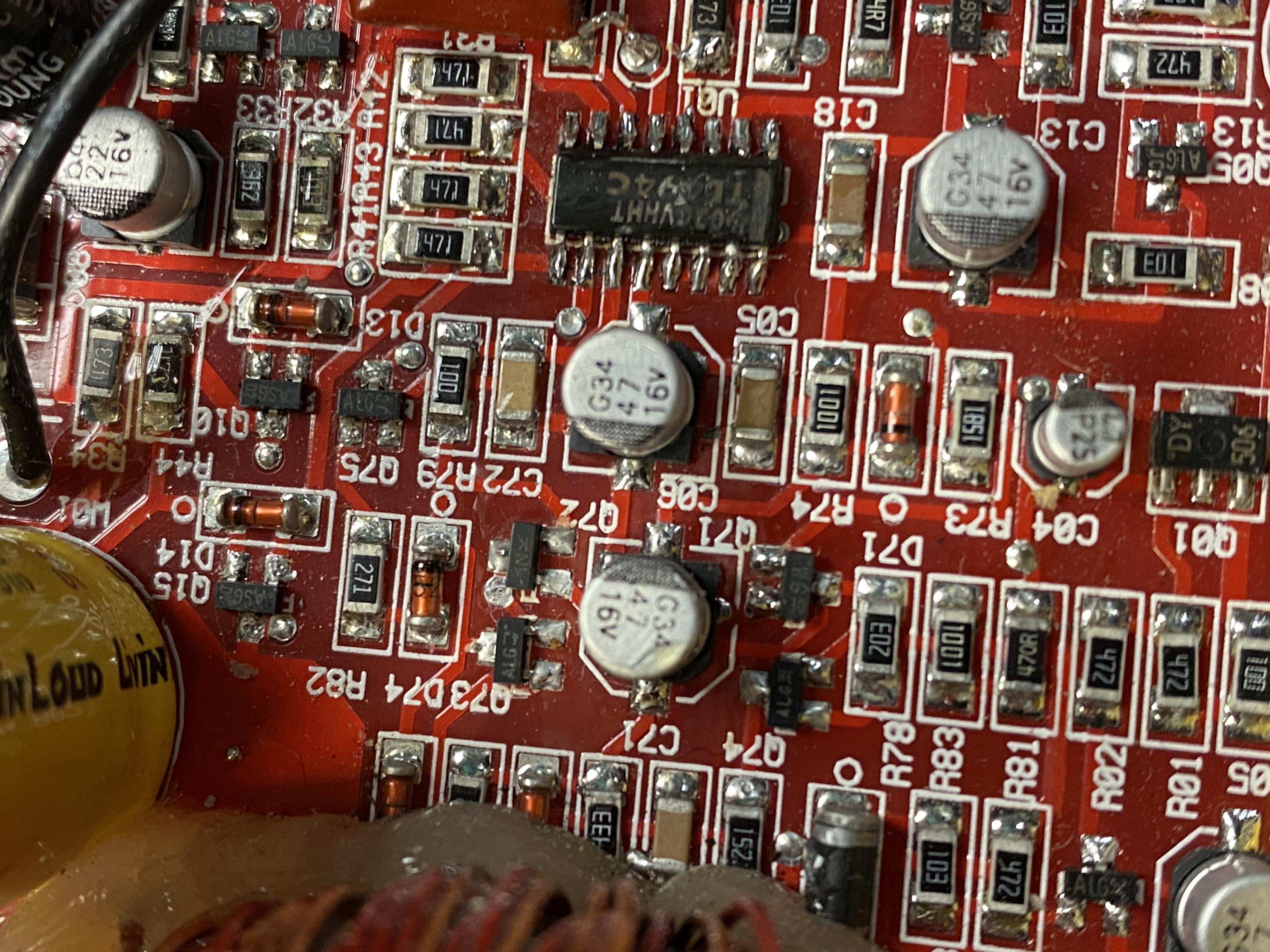

Check C73-103p and C72-104p. C73 may be causing the softstart to not latch.
If replacing the caps fails to restore softstart try lifting D73 and R78 one at a time.
If you haven't already, double check that the transistors where installed correctly.
Q71- 3876GR
Q72- MMBTA14
Q73- A1505GR
Q74- 3875GR
Q71- 3876GR
Q72- MMBTA14
Q73- A1505GR
Q74- 3875GR
There may have been a mix up. List the four transistors, locators, part number and markings as below.
