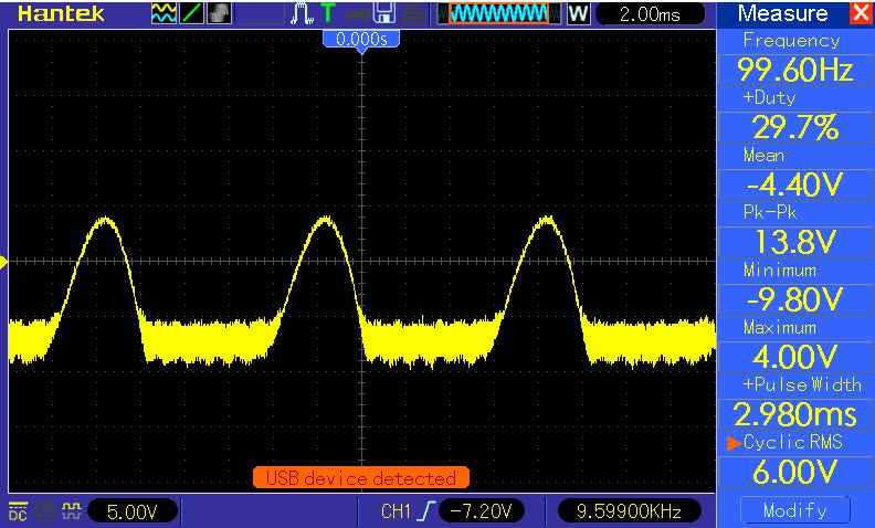

I have 24v from pin 6 to 1 and 4.3v from pin 10 to 14.
This is the signal on pin 3.
I believe the voltages are right, but to confirm measure the DC voltages from signal ground(black probe) and Pin 10, then Pin 14-U14-LM361.
Ground Pin 3-U14 to signal ground. A Jumper from pin 3 to the sig gnd side of C270-220p will do. Recheck to see if you have drive from Pin 13-LM361. Pin 11(NC) should have drive as will.
If no drive the LM361 has failed.
