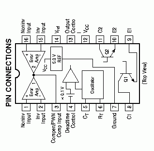

! got a kicker kx 1200.1 off a buddy he said it smoked i opened it up seen where it smoked and ordered some of the parts .But red on here i might need more if the irf3205 blew but also the little chip marked with 22 on top between the irf3205 mosfits what are they called ? And where can i buy them? and what other chips will i have to order? I will post picks in few mins
R74 is the gate resistor for Q74. The replacement is a 22 ohm 1206 sm resistor commonly marked 220 on a 1206 sm. You should replace all mosfets and Q10 & Q16(KTA1266GR) and any gate resistors that are out of value 5% or more. Be sure to check all of the outputs and D61 & D63 rectifier diodes.
A good practice would be to check the triangle wave pin 5 of U101 and the drive pulses pins 9&10 of U101 after you remove all mosfets and replace Q10 & Q16,and before you install fresh IRF3205's .
If you have an oscilloscope posts screen shots and DC voltages around U101 black probe on power ground are useful for determining a U101 and C12 have not failed.
