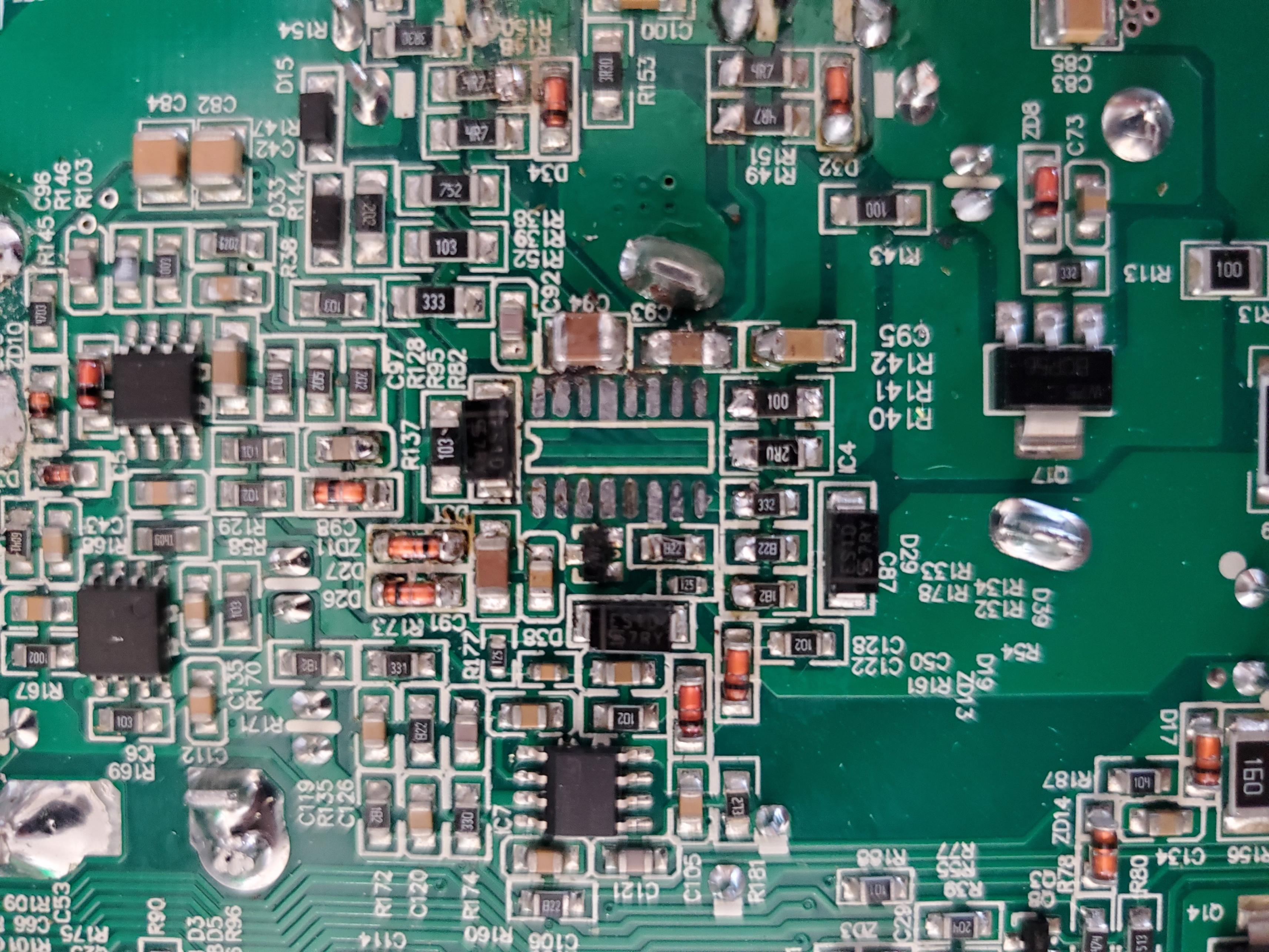

Kicker CXA300.1 No rail, regulated or gate drive.
pin 3 with 40hrz input.
this is with the aot460 in circuit and the aot412 are removed.
ic4
1.) 10.24
2.) .634
3.) 2.077
4.) .005
5.) .001
6.) -31.52
7.) -35.75
8.) -27.96
9.) -36.67
10.) -36.67
11.) -24.37
12.) -.002
13.) .652
14.) .653
15.) 15.01
16.) .648
with the power supply in curcuit. and the diode correct.
with everything in place, including the outputs what are you seeing? What does the drive look like? Do You have 10.3Vdc at Pin 2(CSD) of the IRS20957? Does Q19 get hot?
Without the outputs the CSD will be wrong. I discovered this working on another CXA.
