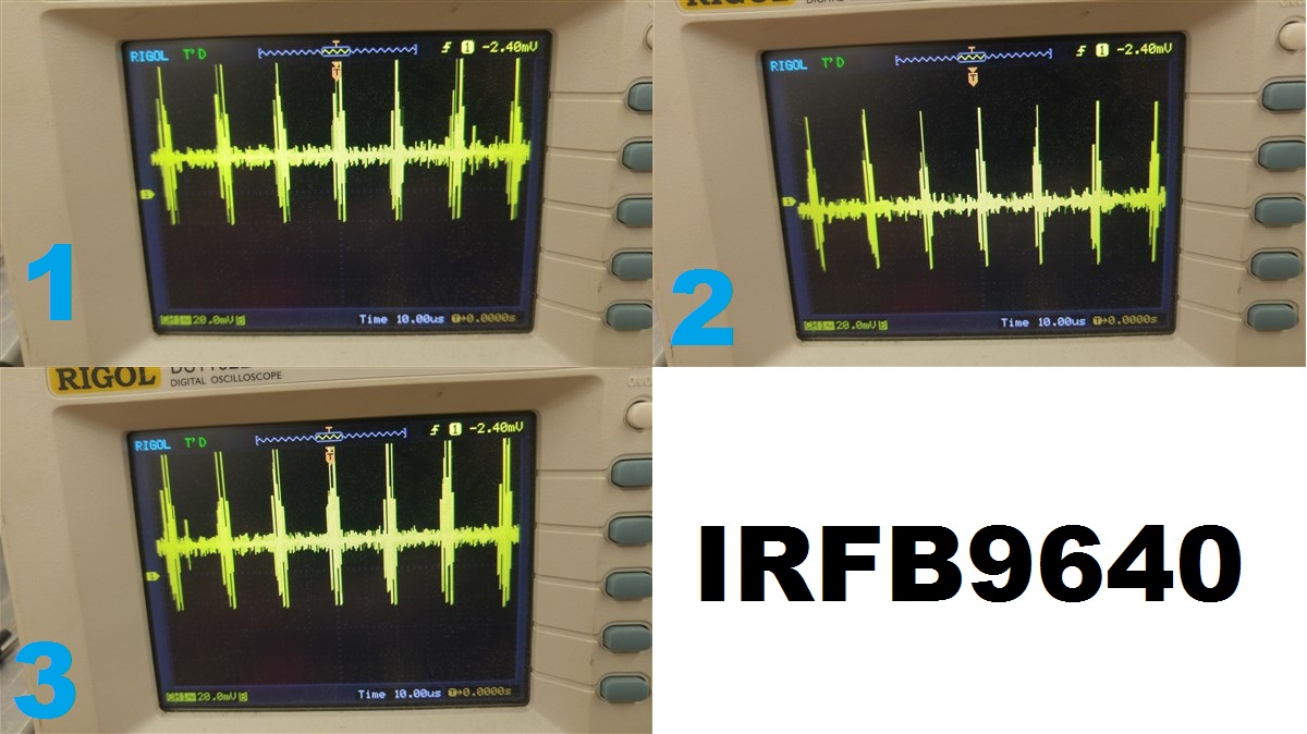

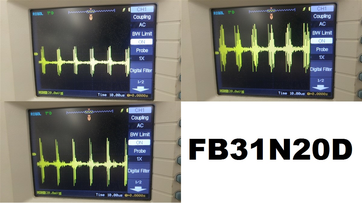

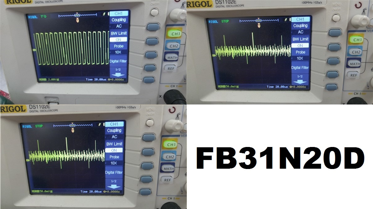

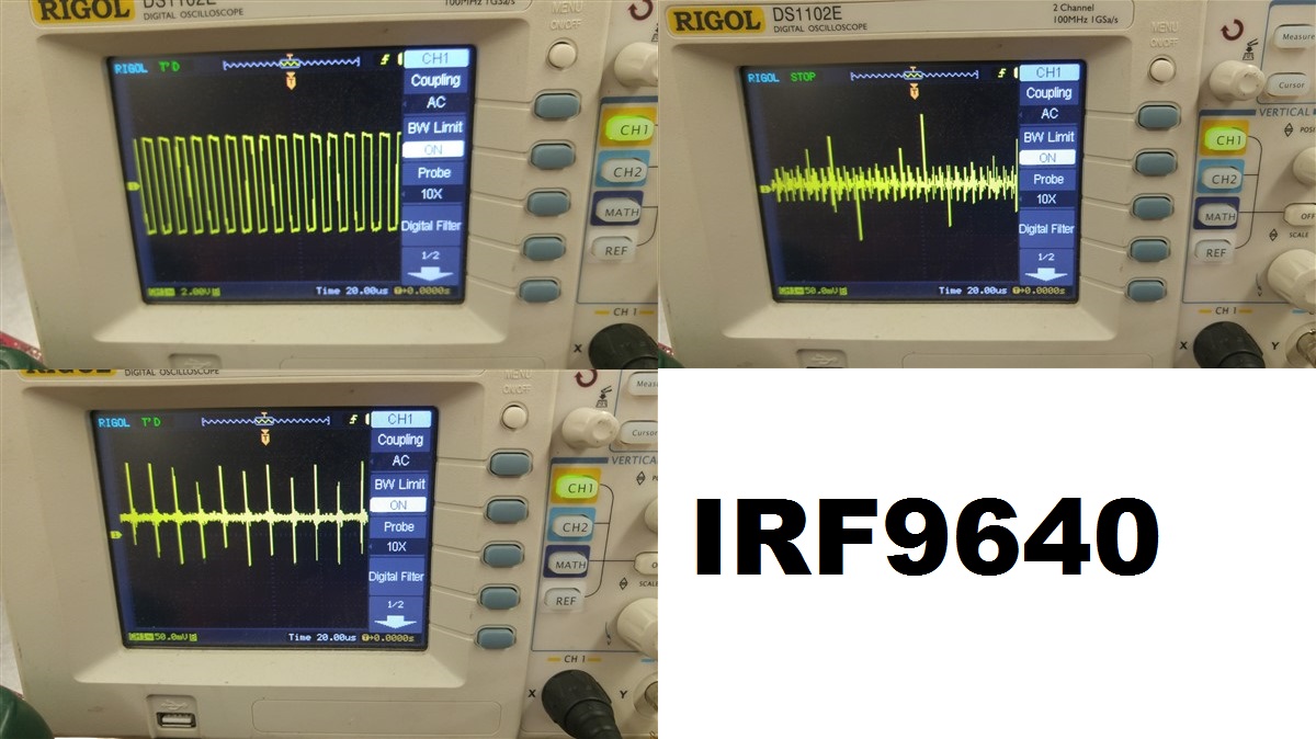

The first set of waveforms is from the outputs. All waveforms matched nearly identically (or at least identically enough I could not distinguish a difference) between banks. The first 3 are the 9640, second are the FB31'S. The secondary center tap is used as ground reference here.

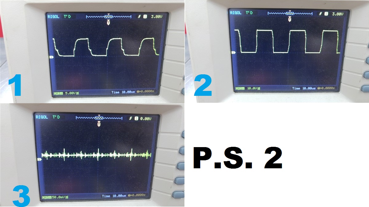

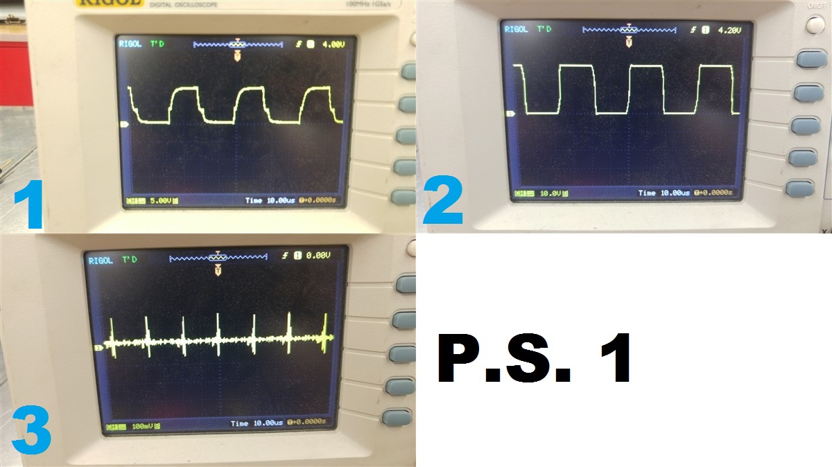

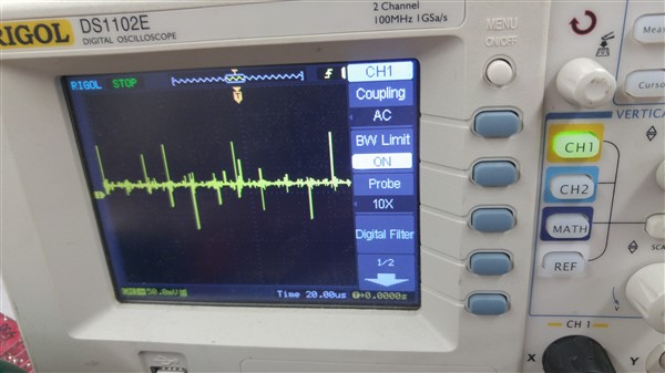

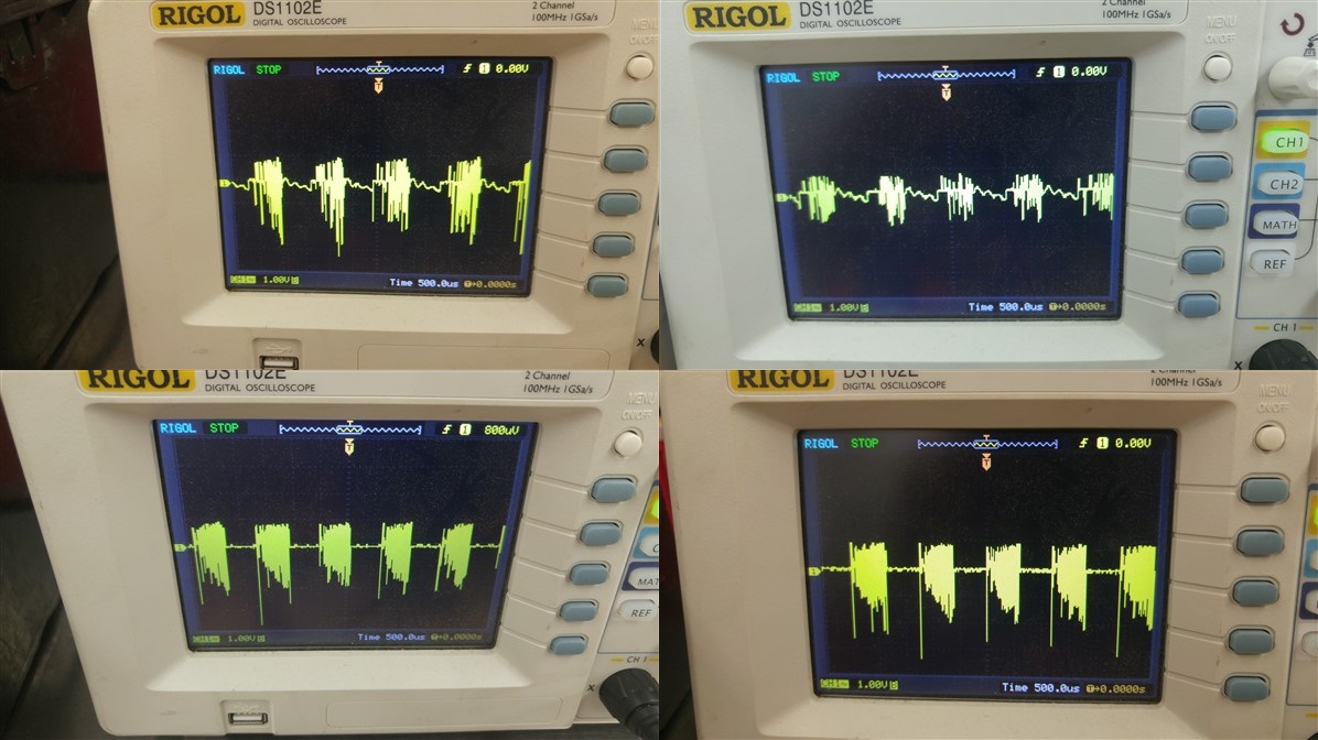

The next waveforms are from the power supply. I did note that one side was different than the other on one of the legs. B- is used as ground reference.

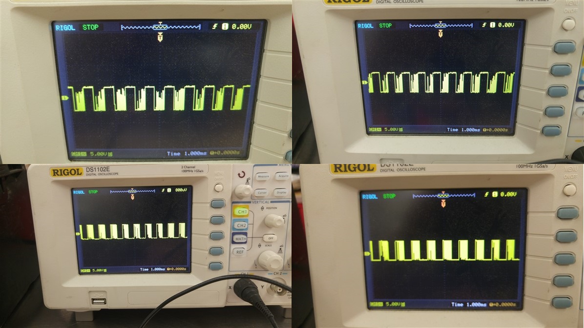

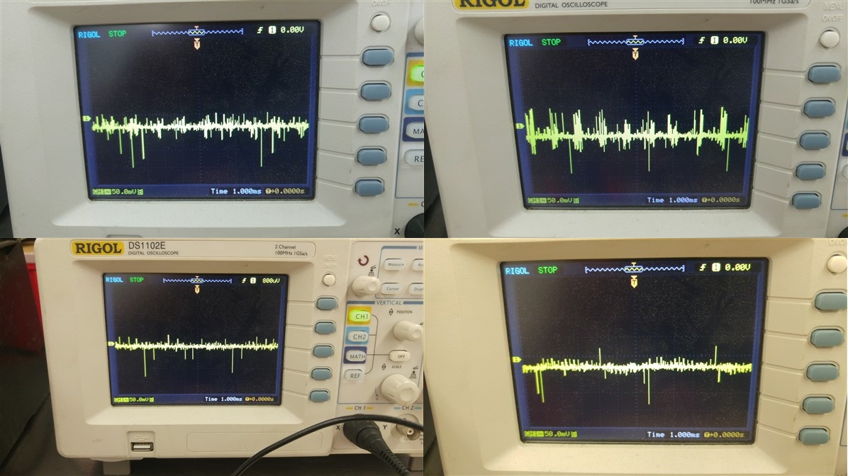

The last waveforms are of the LM361, pins 4, 9, and 11, respectively. The secondary center tap is used as ground reference here. I do apologize, as it appears I only have the waveforms of 4 & 9. I will try to grab 11 next time I have a moment to work on this, if it is needed.

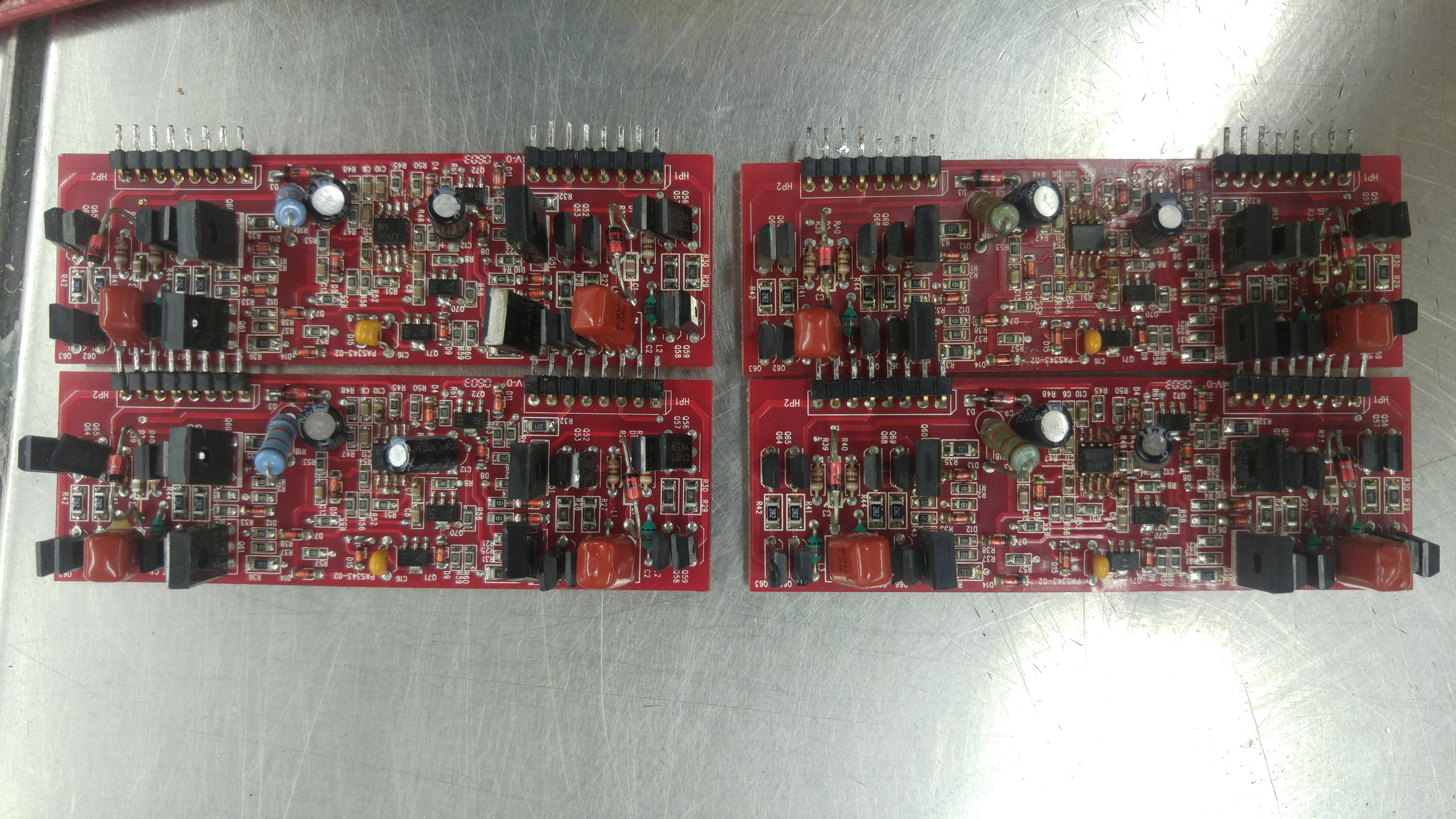

You can remove all of the outputs FB31's and 9640's included.This will allow you to check waveforms and determine which driver board is bad. Did you say you have another 2500.1? If so you may be able to substitute the driver board's. Post pics of any driver boards you have,there were some revs made and you don't won't to mix and match.

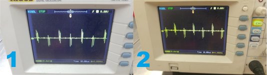

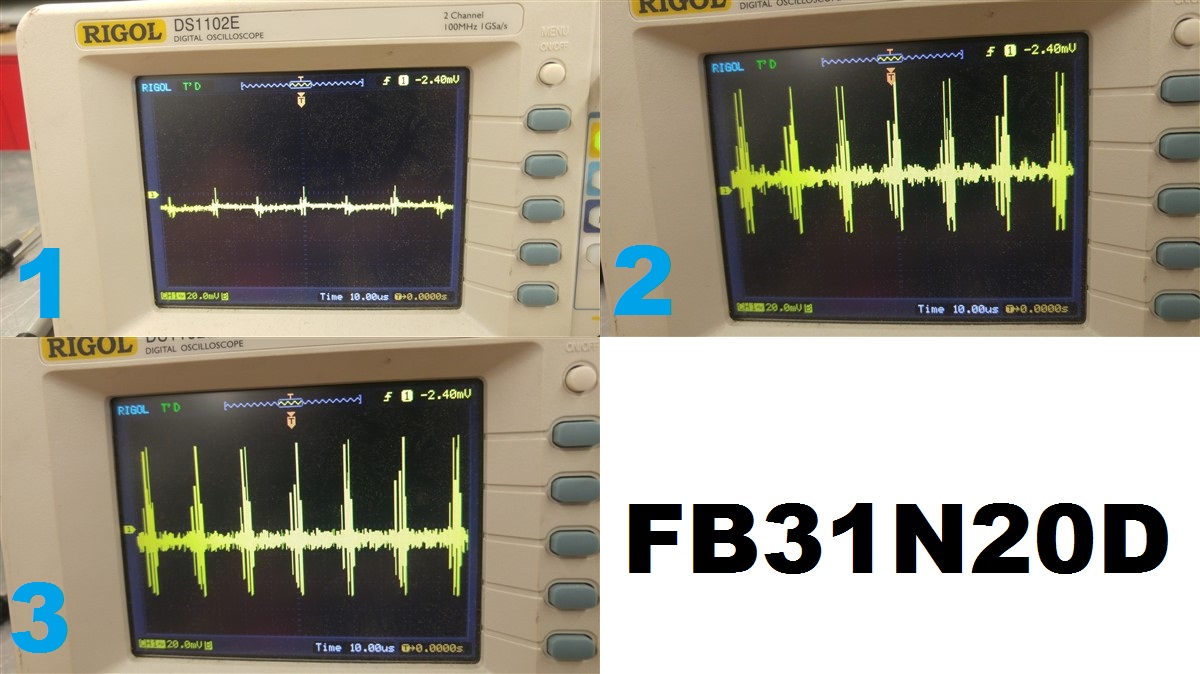

I have come bearing waveforms! All output transistors have been removed. I am using secondary center tap as ground. Driver boards have been labeled 1, 2, 3, and 4, to keep track. 1&2 are original, 3&4 are spares.
In the following waveforms, I have board 1 in the 'Good Side', labeled by me as banks 3 & 4. Both sets of waveforms were matching between banks.

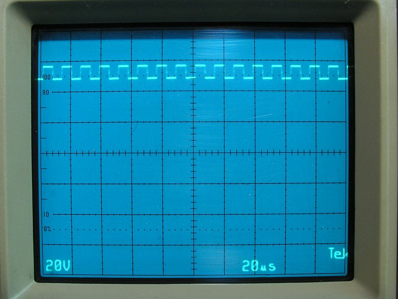

Did I miss something? Was the issue of the drive from the LM361 resolved? The following is approximately what you should have. Right-click to zoom in.
http://www.bcae1.com/temp/genericclassd1kicker550pt3b52idwaveforms.swf
Check the DC voltages around the LM361 and the MC14060 which is right beside the 361 and post. Comparing the pictures you posted in #17 and #27 it appears you may have
A) Damaged the MC14060 and possible the LM361 or
B) The regulated +/-15 volt supply
PapaZBill, you were correct. I swapped the LM361, and got no new results. I did not remove the donor LM361, and then swapped the MC14060 (labelled CD04060DE on my amplifier), and now I have waveforms that look clean and exactly like what Perry's link shows. No messy waveforms whatsoever as were previously observed on 4/9/11. I will install driver boards tomorrow, and re-post the waveforms from the outputs, and see if you think it might be safe to install FETs again. Do you by chance have any resources on what the waveforms on the output should look like with the driver boards in? It doesn't have to be exact, just would like to know about what I might want to/expect to see. Thank you again for all of your help, I greatly appreciate all the advice and explanations you've given thus far.

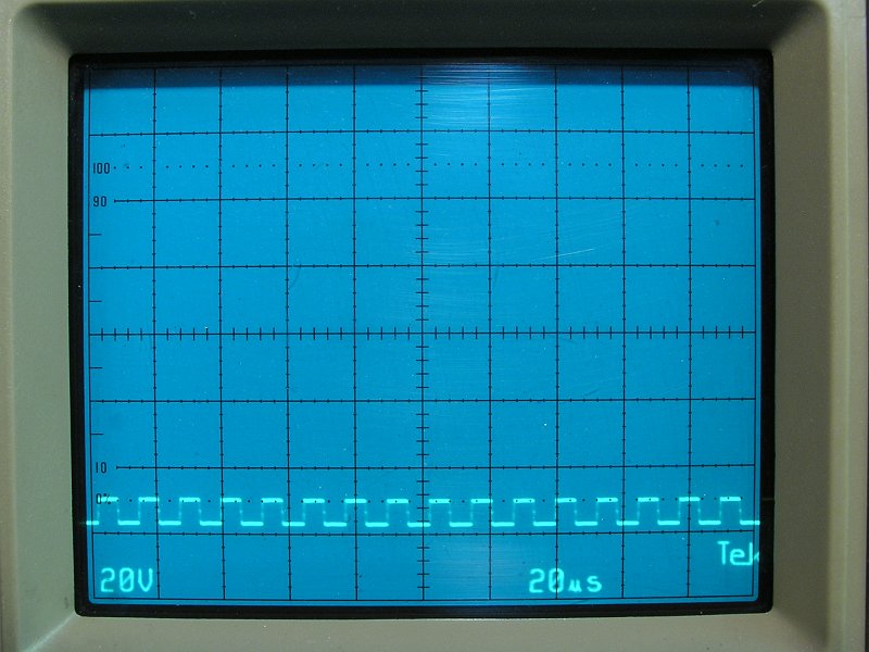

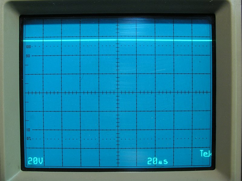

Basically,what you see at pin 9 & 11 of the LM361 is what you should see at the gates of the output mosfets,present or not.

The attached photos show the drive signal and rail voltage. Your rail voltage will be different but you can see how the drive signal drives up and down from the respective rails and shows the amplitude of the drive signal.

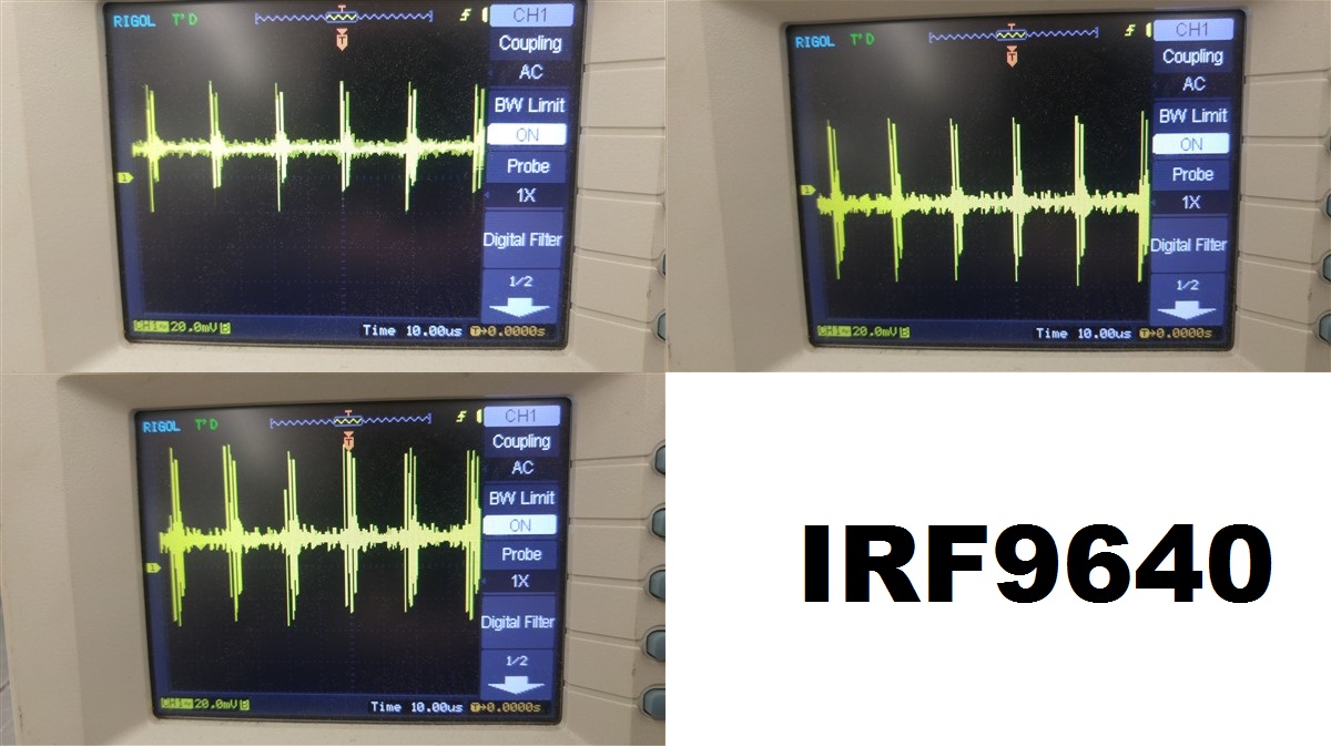

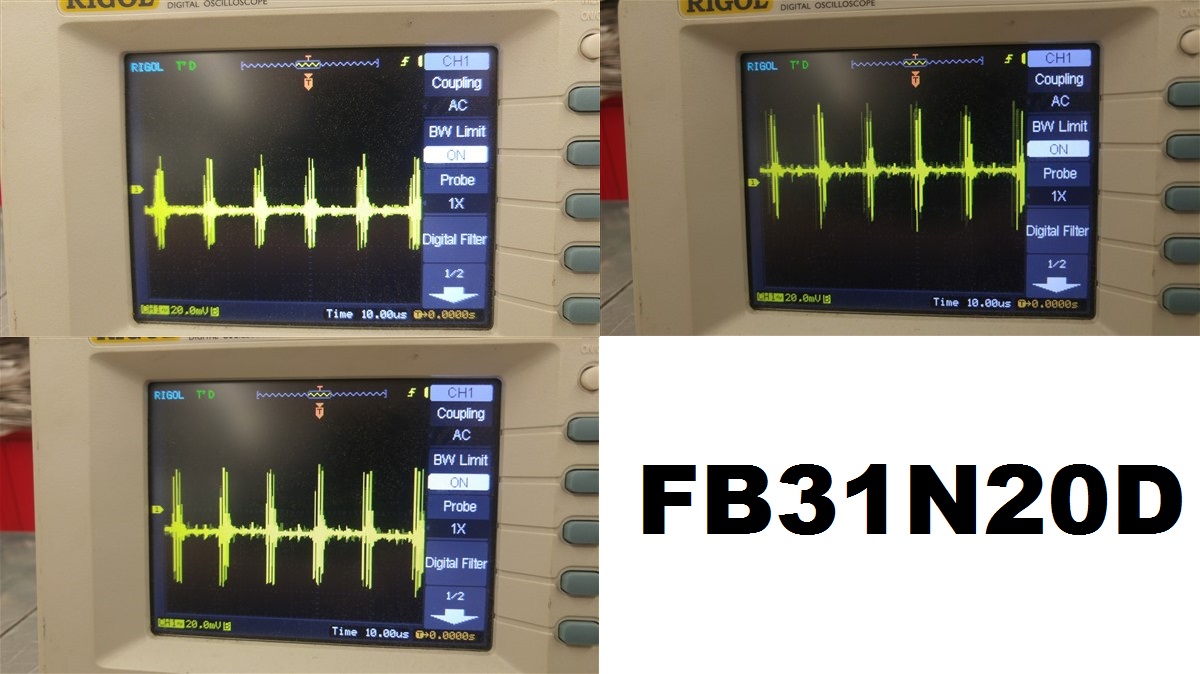

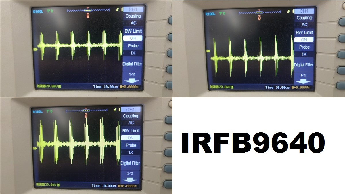

Okay, I popped the driver boards in. I now get this for the IRF and FB31. Note that the last two unlabeled waveforms are from bank 2, pin 2 of both IRF and FB; they were the only discrepancy between banks as far as waveforms go, the other three banks matched the corresponding waveforms almost identically. I believe this is the channel that was previously damaging FB31's, just to note.
Without FETs in the circuit, the gate drive is the only waveform that you will have. When your scope is at 50mv/div, you're just looking at noise. The drain is at 0v and the source is at rail voltage. You cannot have any significant signal (only noise) on the drains without the FETs.
