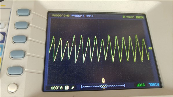

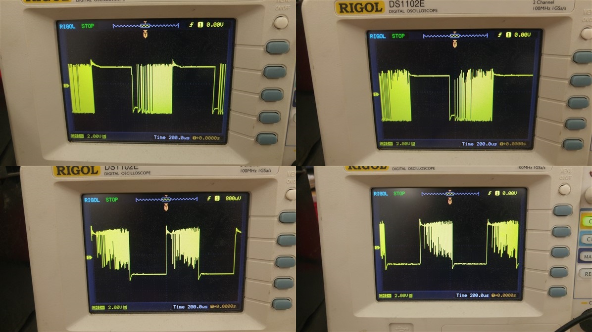

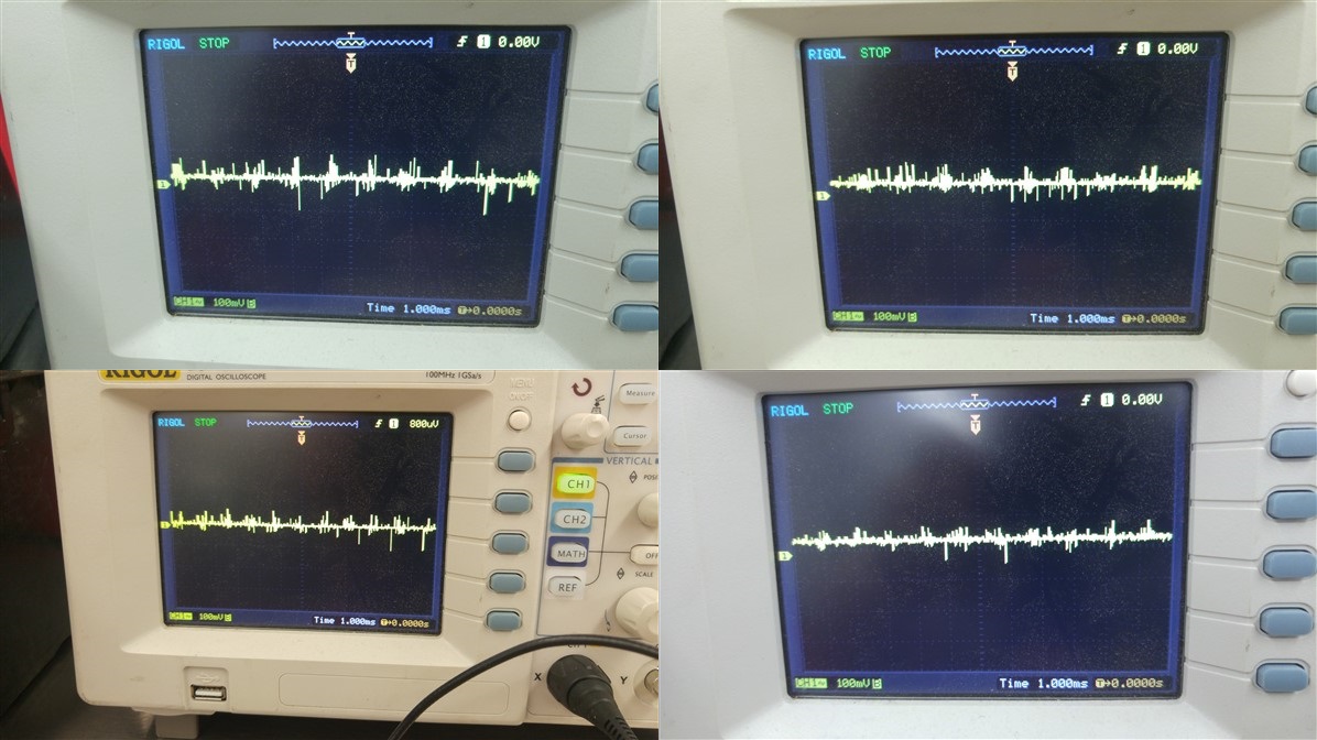

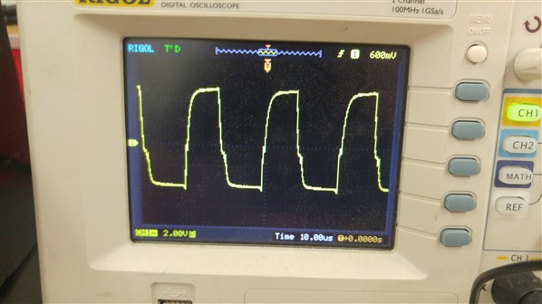

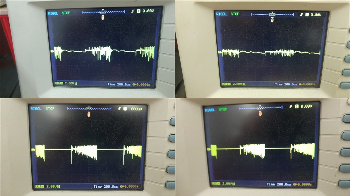

Okay, I got some waveforms. I used the negative speaker terminal for ground, I interpreted Perry's advice to mean that should be a wise choice. I have the amp running on a 15A fuse, drawing ~1A current, the only thing I do not have installed is the tone card (the card that gain/bass boost/xover controls are on) and the FB31N20D's. Remember, banks 1 & 2 are the 'Bad Side', banks 3 & 4 are the 'Good Side' - meaning I can leave the FB31's in without them blowing. Not sure if both banks 1 and 2 are bad or just one or the other - when I pulled the FET's the last time, I had 3 of 6 FB31's blown that were good when in Banks 3 & 4.

It appears that there is either excessive noise or you scope isn't triggering properly. Did you confirm that the negative speaker terminal read 0 ohms to the secondary center tap?

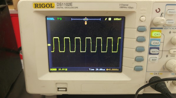

Can you get a clean waveform image on the power supply FETs?
It also appears that the signal is approximately 1kHz. Is that what you have on the pin of the LM361 (it this amp has that IC)?

You should see a squarewave w/ a 50% duty cycle much higher than 1khz.This should be 50khz or higher.
Comparing the waveform at the power supply FET's will give you some idea what the output drive should look like as Perry suggests.
The LM361 is underneath the preamp board (you referred to it as a tone card). Using the negative speaker terminal for scope ground, assuming there is zero ohms between neg spkr term and secondary center tap, check and post the waveforms at Pin 4,9 & 11 of the LM361.

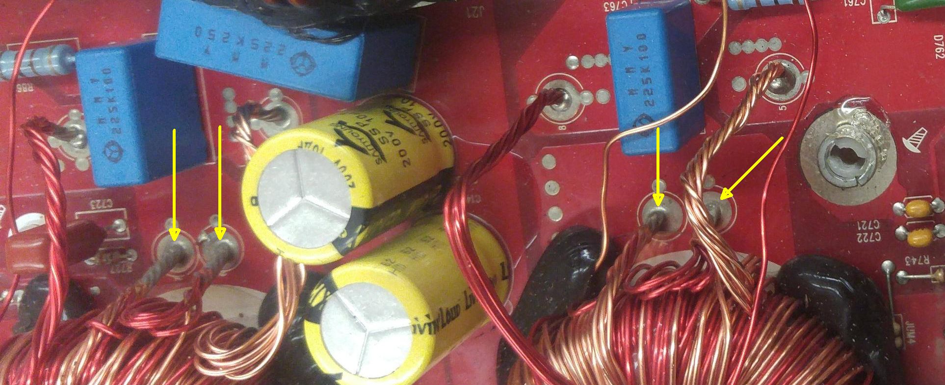

This is the transformer I have been trying to find the secondary center tap on, no luck on my part.

C763 is in line with two leads (one red and one gold) these two leads are the center tap. The other transformer has a blue box cap in line with its center tap. An ohmmeter should see 0 ohms between these two points along with the negative speaker terminal.
If for some reason the neg spkr terminal and center taps are not connected this could cause the noise your seeing on the scope,and an imbalance between the negative and positive rail voltages.Which your DC voltage measurements of the output FETs seem to indicate and should be approximately 60 volts on both the positive and negative side.

The arrows point to the secondary center taps for each transformer.

Okay, I have a bit more insight. Neither of those two read zero ohms to the negative speaker terminal. When metering DC voltage using B- terminal as ground, those two posts read -6.52vDC. Between the tap indicated and either speaker terminal (using speaker terminal for negative probe), it indicates about -56vDC (not sure if that actually means anything).

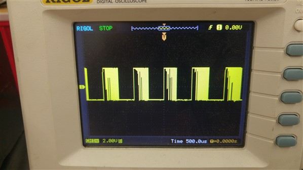

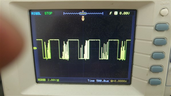

These are the waveforms of the PS FETs using that indicated center tap as ground.

The power supply is referenced to the main ground terminal. That's what you would generally use for the scope ground when checking power supply waveforms.
The reason that I wanted you to check the power supply waveforms was to confirm that you scope was working properly. The waveforms that you were getting for the outputs were not what I'd expect.
As a side note, using DC coupling is important when checking waveforms, especially when checking the gate drive for the power supply (not applicable here but would be if you were troubleshooting the power supply drive circuit).
