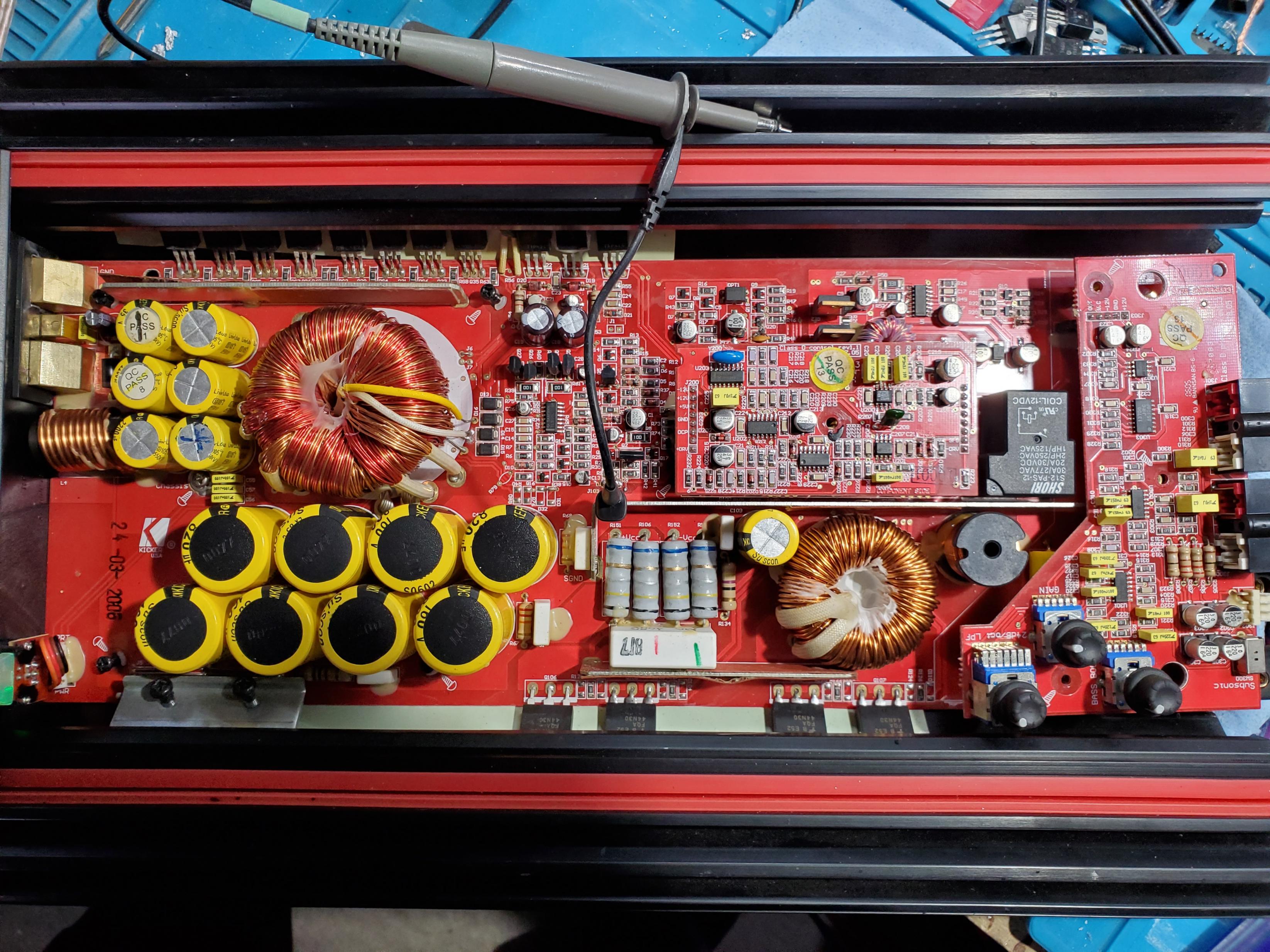

Kicker 083ZX1000.1 output trouble
OK so I am starting a zx1000. 1 amplifer seems to be running in perfect order. 13.3vdc it draws after the relay engages 1amp of current. Regulated voltages are present on the class D card and the input card. I traced my 40hrz from input to class D card as well.

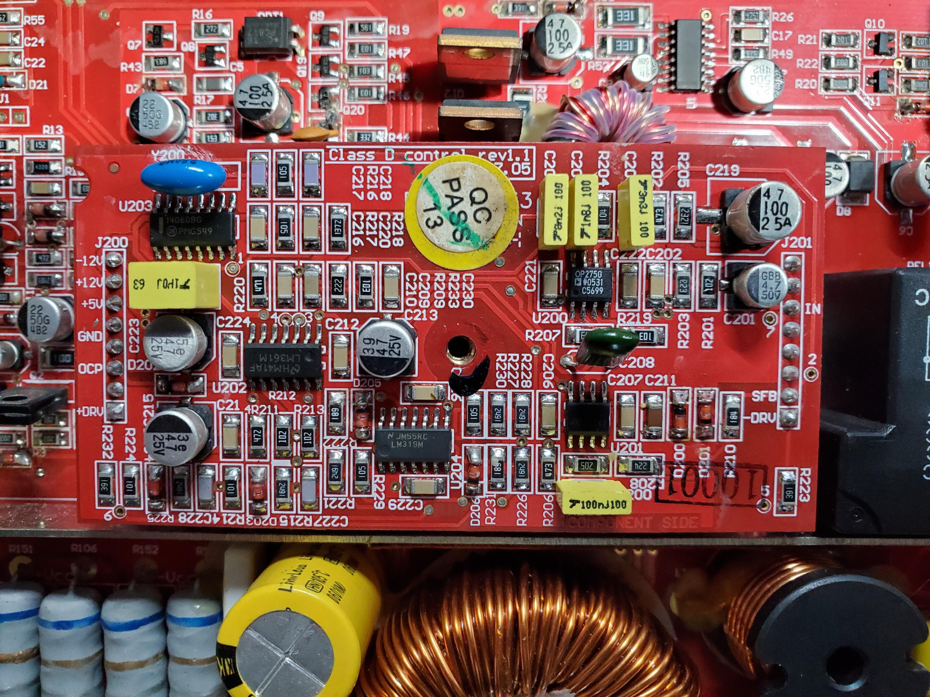

So I checked u202 pin has a nice triangle wave. No driv from. Pins 8&9 so I'm thinking its the ic that's bad?
So when I changed it the amplifier started flashing in and out of protection.

If you lift D7-1N4148 does the amp come out of protection?
Check the voltage across C11 and C12. Both should be 18Vdc. This is an aux power supply independent and isolated from the main supply. This supply consists of U1-TL594, T1,Q12 & 13-MTP3055(Mosfets may be different in your amp) and is the operating voltage for the Output Driver stage Q100,102-2SD669, U100,U101-MC33151(May be different in your amp),OPT100,101-2601.
You will have to remove the Class D board so you can check the voltages around the Driver stage and use the negative side of C11 and C12 for references. C11 supplies the Q100 driver (+DRV) and C12 supplies the Q102 driver (-DRV).
I lifted D7 and removed the class D card to check the voltages.

The voltages at OPT101 Pins 1 & 2 are much too high. You should be using C12 neg lead as your reference/black probe.
when you lifted D7 did the amp come out of protection?
It appears to have drive ~5V at DRV pins.Is there a squarewave in the gate circuit?
I'm not getting a clear picture of what is happening. It's be a few minutes since I ha one on my bench. They can be beast to troubleshoot.

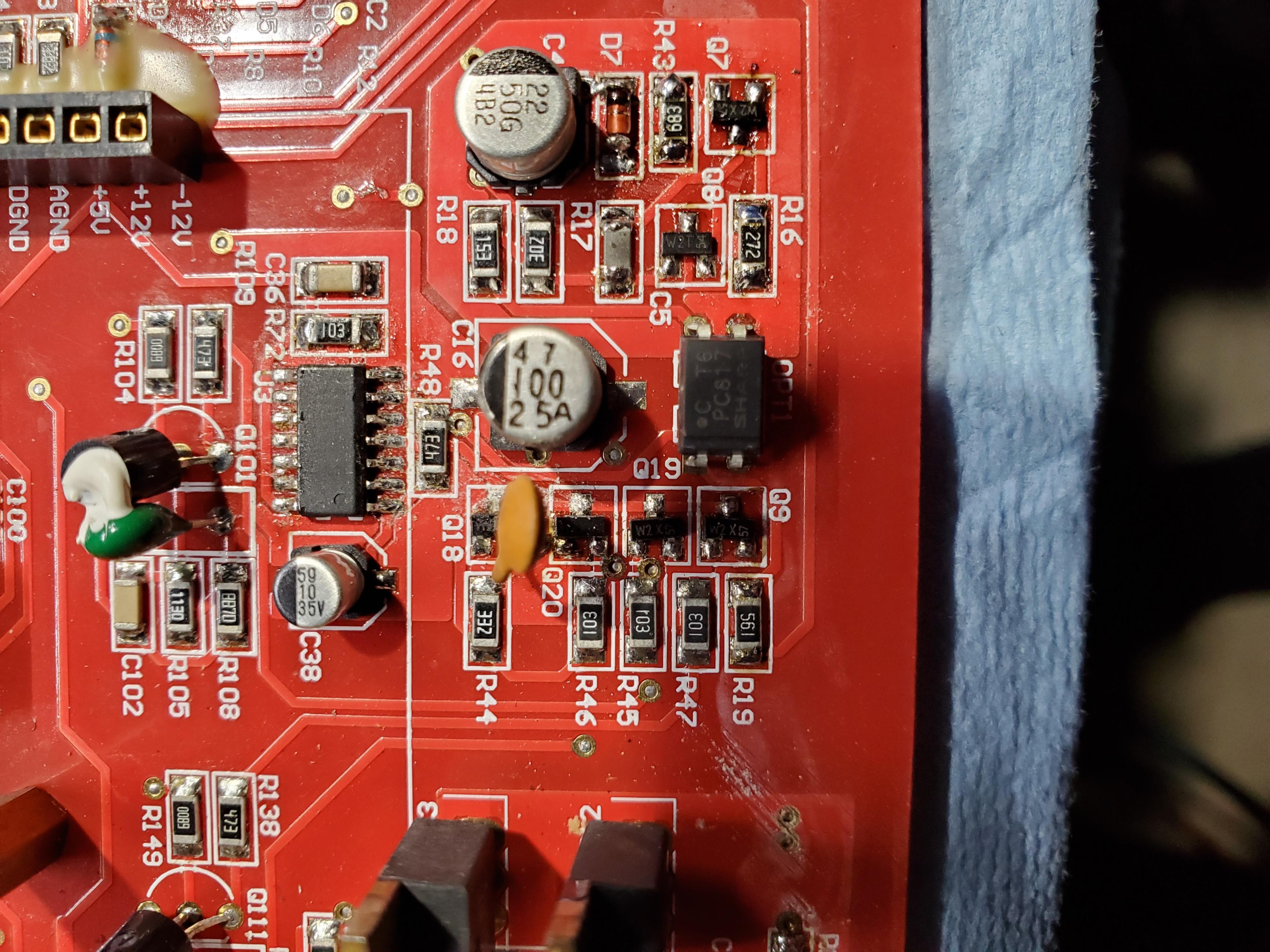

Also, check the DC voltage around Q9,18,19,20-2N4401 & U3-74HC74 and post.
Yes lifting D7 brought the amplifier out of protection. I have no audio at the speaker terminals.
That high voltage is strange at pins 2&3 of otp101 grounded at c12, they are not present on opt100 unless I swit h from C11 ground to c12 then the same 112.2v is present at pins 2&3 of opt100.
Where should I be grounded to check the Q9, 19,q20,q18 set and the 74hc74?
I do not have a square wave on pins 9&10 of the lm361 but the triangle is present on pin 4
I have 40hrz getting to the card no 40hrz at speaker terminal.

All those transistors check out. I changed the 74hc74 with one I had here. I do not know if it is good or not.
So. I learned that the Amp goes I to protection when I apply an input signal and turn the gain up. it stays green with D7 in curcuit until I add a input signal and raise the gain till about just under 1/2 gain.
So. I learned that the Amp goes I to protection when I apply an input signal, and turn gain up to about 1/2. This with the class D card in curcuit.
