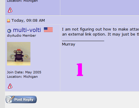

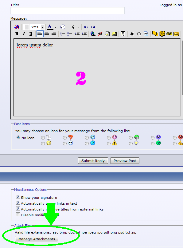

I am not figuring out how to make attachments, or if I can. I see the attach image icon under the "go advanced" expanded menu (after trying the 'basic' icon that acts the same way), but it only offers an external link option. It may just be that way...?

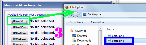

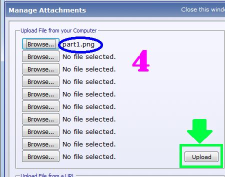

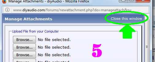

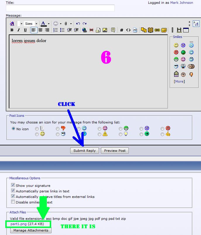

Follow these six numbered steps.

Well, wow, I must be getting old(er).
I've used that attachment method on another site with same forum software...& forgot all about it.
