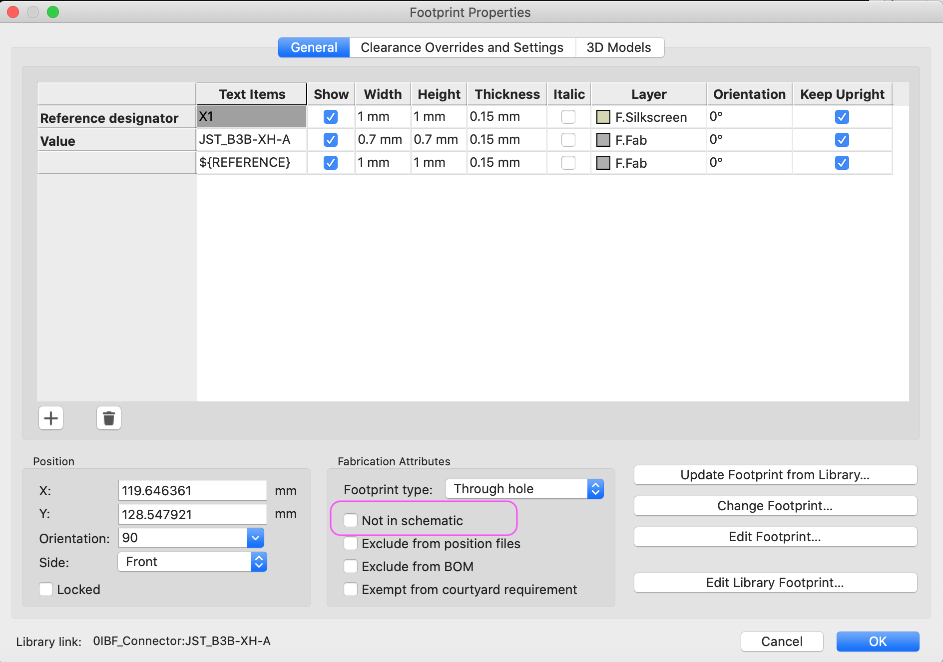

Generally speaking,Imo Mounting holes with no connectivity do not need to be on a schematic. A heatsink with no connectivity can be added to a schematic if you want it to be included in the BOM however. Sometimes how mechanical parts are used depends on your design process

Most of us put mounting holes on the schematic, it can make it easy to show that they are attached to Gnd
I used to leave unconnected mounting holes out of the schematic, but it does make it more likely for a mistake to happen related to them, and it can also be useful to see exactly how many mounting holes you have. If you didn't want them to show up on printed versions, you can place them outside the border and if you plot the page they won't appear.

I would always put them on the schematic too.Most of us put mounting holes on the schematic, it can make it easy to show that they are attached to Gnd
Otherwise schematic no longer matches pcb and should be flagged as an error.
Actually they do, and the reason is that if you add them in the PCB design, the next time you update the netlist they will be removed from your PCB design.Generally speaking,Imo Mounting holes with no connectivity do not need to be on a schematic. A heatsink with no connectivity can be added to a schematic if you want it to be included in the BOM however. Sometimes how mechanical parts are used depends on your design process
I've used KiCad for about 8 years now and previously used OrCad and Altium and this was true for them as well. I'm a big fan of KiCad in case there is any question.
I group mounting holes and heat sinks in a convenient spot on the schematic to keep them out of the way.

I can not comment on the use of kicad since I have never used it. but I do use orcad 16 layout all the time and can verify that what you say about a forward eco removing a mounting hole is incorrect. You have to set the layout part property to “not in netlist” for it to be retained in layout and unaffected by a forward eco or “netlist” op from capture to layout.
Think about this situation, you have design that uses a standard pcb outline having tooling and mounting holes that have no connectivity. They could be a footprint or geometry that is reused in multiple designs. It would a royal pita to have to recreate that for every design which uses that pcb outline.
The only reasons for mech bits to be in the schematic is for connectivity and a BOM. If either of those two do not apply then it makes no sense to me.

My last experience was with OrCad 14 and I did not get far enough with it to know the score there. It seems to be (have been?) a fairly common practice, that said none of the suppliers I deal with currently do it, but in previous jobs it was fairly common.
I forgot about that. Kicad 6 has a similar facility that will also work here:
Which version are you using, I use 6.0.5 and cannot see the "exempt from courtyard requirement" here. It would certainly be a useful option to have. Up to now I always removed courtyard lines from the footprint that needed to overlap with another footprrint.
