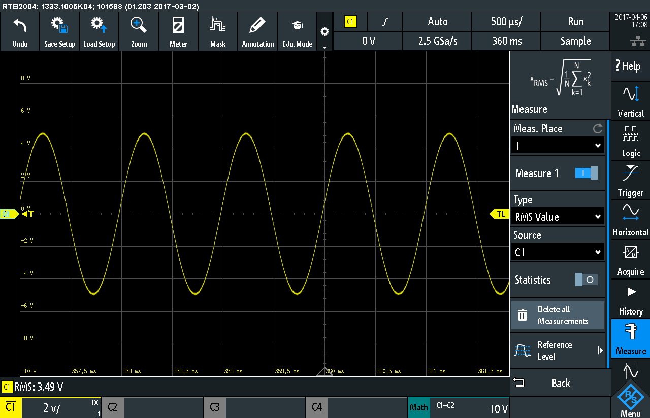

Hey AGDR - if you have 50R termination, would you mind checking the output of your 4400B at 10Hz, 1kHz and 100kHz to see what you get in Vrms before clipping? Thanks.

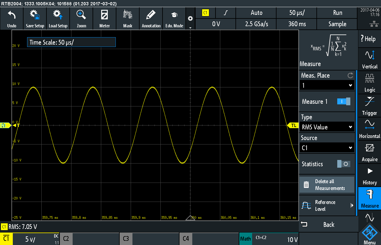

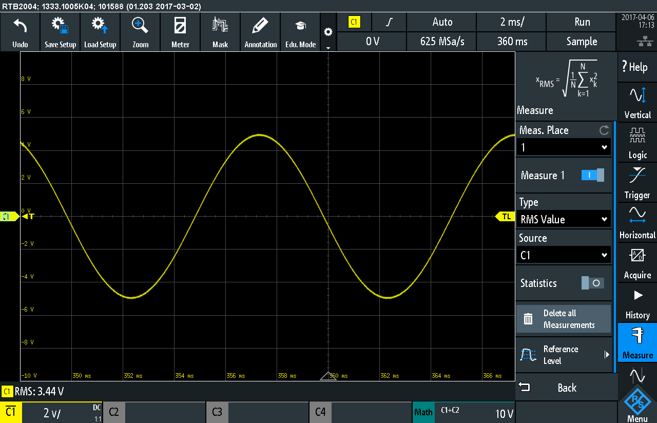

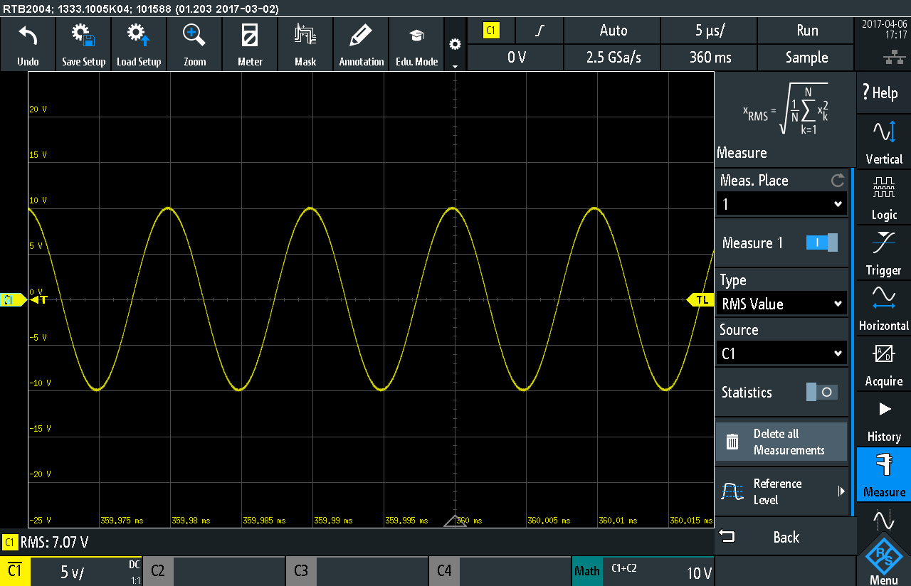

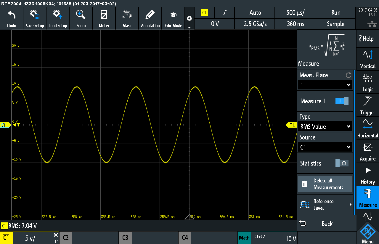

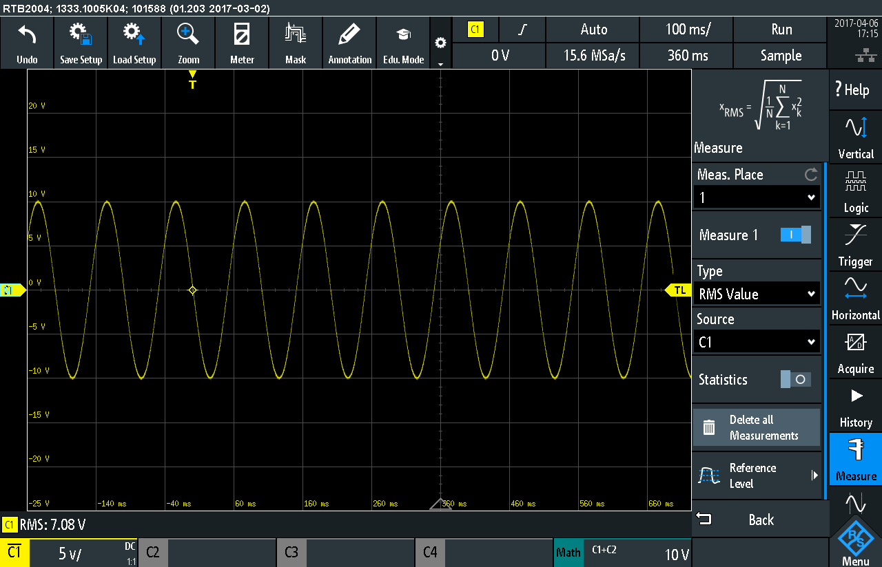

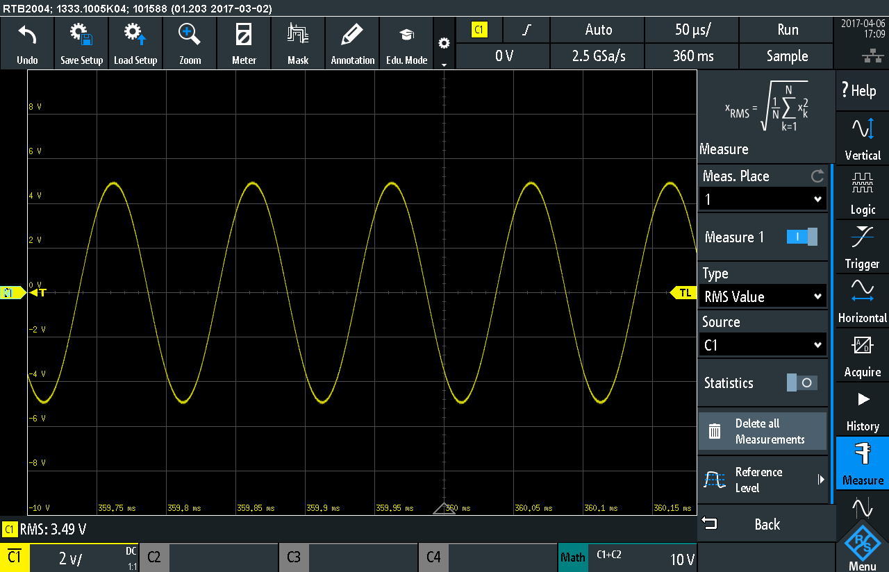

OK, here you go. 🙂 I did the tests with the 50R load, then removed it an ran again. The good news is the KH4400B's AVC circuit is amazing. It never clips. With the output voltage control all the way up the AVC limits every single frequency to between 3.44Vrms to 3.51Vrms. Maybe I won't mess with those TL072 chips after all!
As expected with the terminator removed it goes up to 7Vrms. AVC works great here too, steady at 7 for all frequencies. The only time I saw it clip was when pressing the frequency multiplier buttons. For a second there would be clipping until the AVC restored the loop. Looks like the gain switches must be break-before-connect and the gain loop opens up during the press.
The bad news: the scope is dead! 😱 I've been having crashing problems with it ever since it arrived. They have become more frequent, crashed (screen freezes and the buttons don't respond) a couple of time during these tests. Somehow I didn't capture the screen for the 100KHz with-load test. The scope died before I could go back and get it. But I saw the reading, 3.5Vrms. I'll get the thing warranty swapped at Newark.
Photos:
* 5135 is the test setup. I tack soldered a pair of wires to the two PCB holes that feed the front panel 50R BNC jack, for the scope probe connection. 50R terminator installed.
* 17 is 10Hz with terminator, 3.51Vrms. The rms value is in the lower left of the screen on all of these.
* 18 is 100Hz with terminator, 3.44Vrms.
* 15 is 1K with terminator, 3.49Vrms.
* 16 is 10K with terminator, 3.49Vrms.

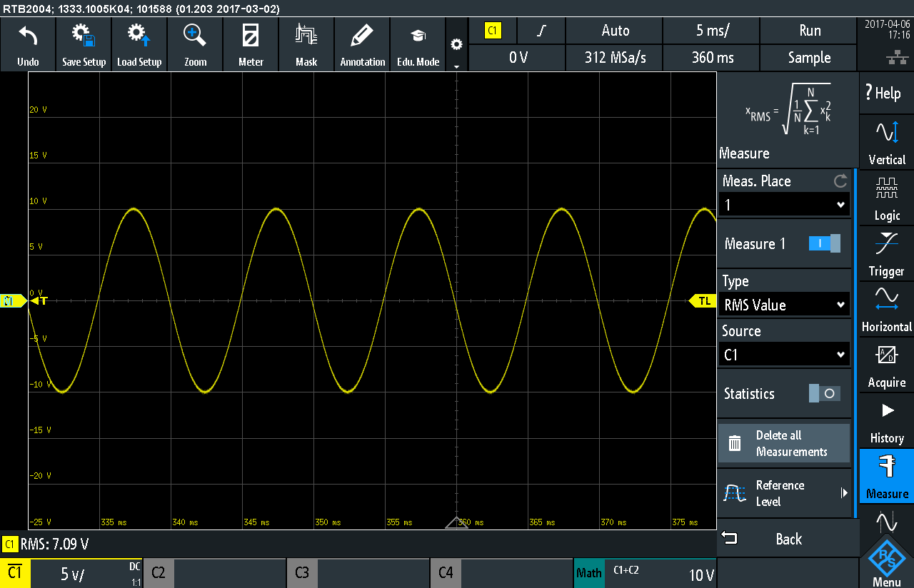

* 19 is 10Hz without terminator, 7.08Vrms.
* 20 is 100Hz without terminator, 7.09Vrms.
* 21 is 1KHz without terminator, 7.04Vrms.
* 22 is 10KHz without terminator, 7.05Vrms.
* 23 is 100KHz without terminator, 7.07Vrms.
Hoovering the mouse over these will show the photo number, clicking on arrows in the lower left will zoom it in..

Thats a drag with the scope. Let us and the EEV blog know about your warranty experience.
The output level accuracy is way beyond what your scope will show. In the cal they use a thermal converter (20 ppm or better accuracy on level vs. frequency) to check it. They are still the gold standard for accuracy for level response.
The KH stuff is really flat response. You will see a level transient when you change frequency, especially range. The AGC needs to adjust for the new frequency. If you watch test point 4 you will see the AGC correcting.
There is a 50 Ohm internal source Z so the 7V internal would be 3.5V across the 50 Ohm load. Load both outputs for max draw on the supplies. The schematic shows 24V DC on the raw supply so low dropout is not an issue. Peak current may be and that would explain changing regulators. As would a visit from a National sales guy in 1990.

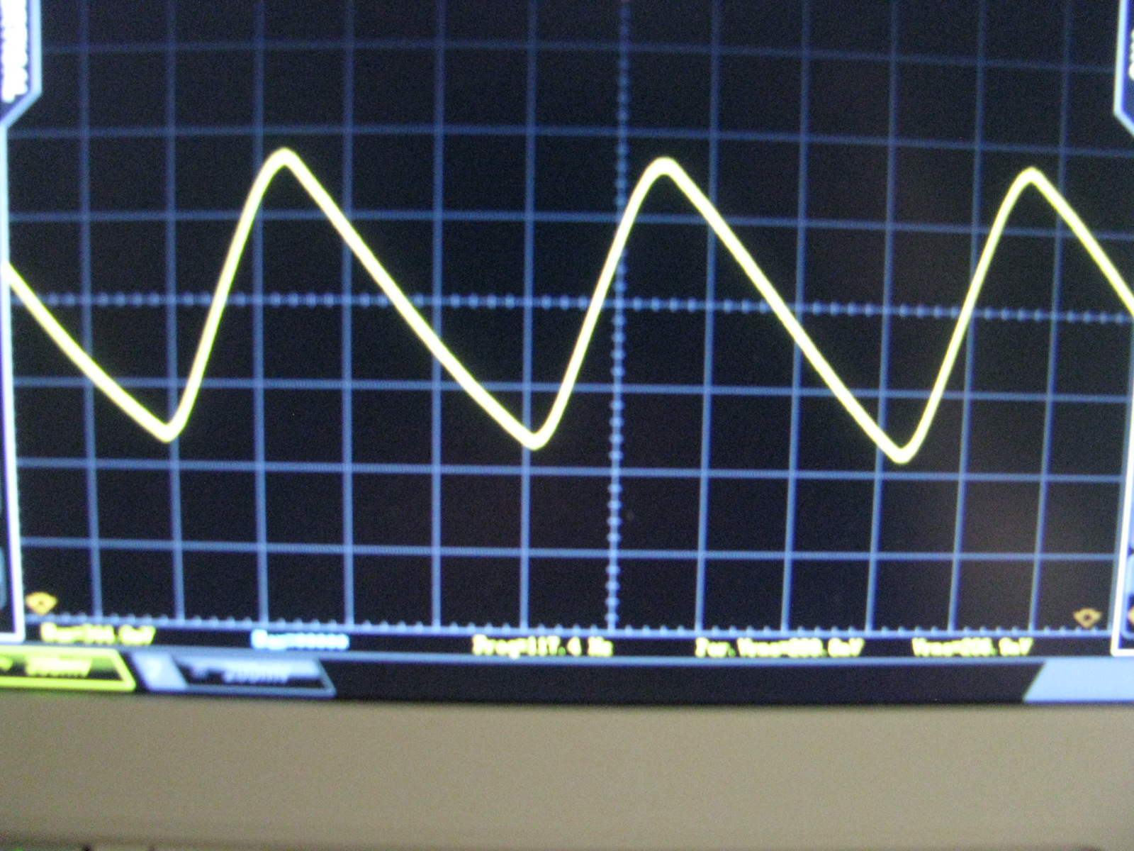

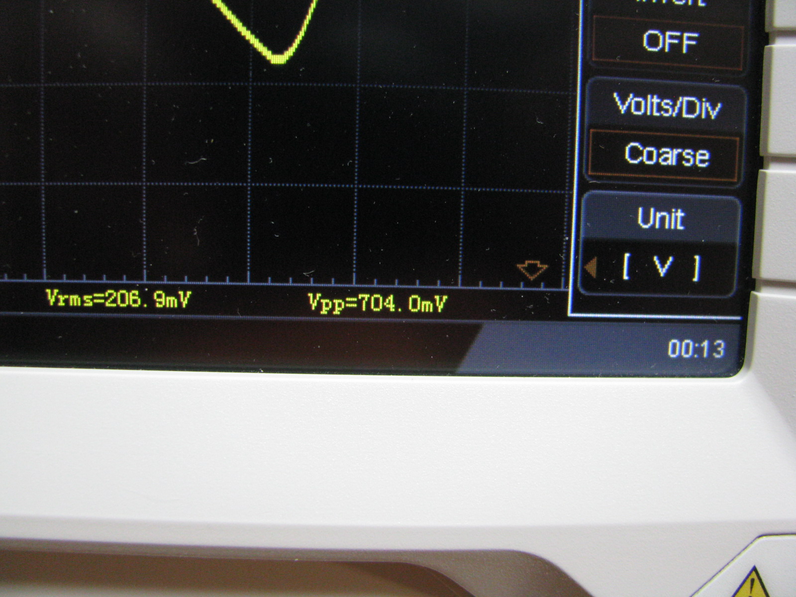

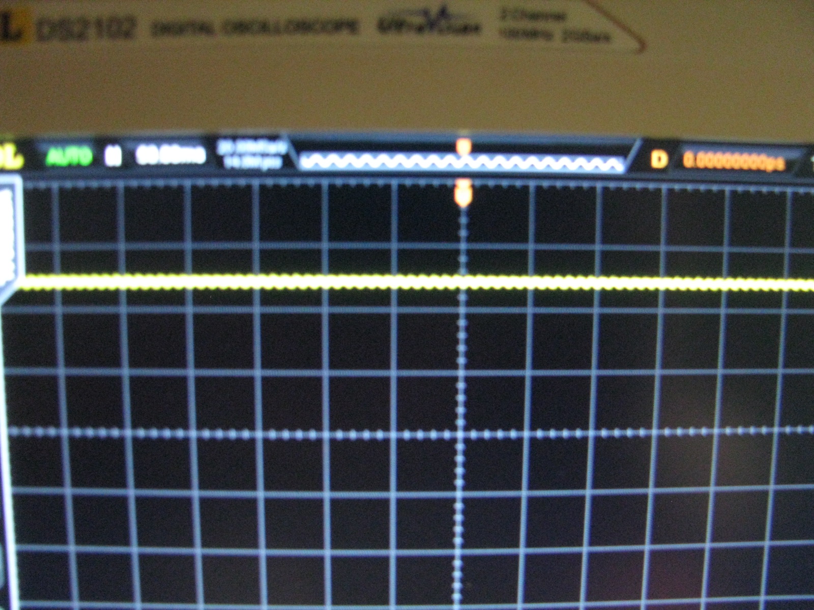

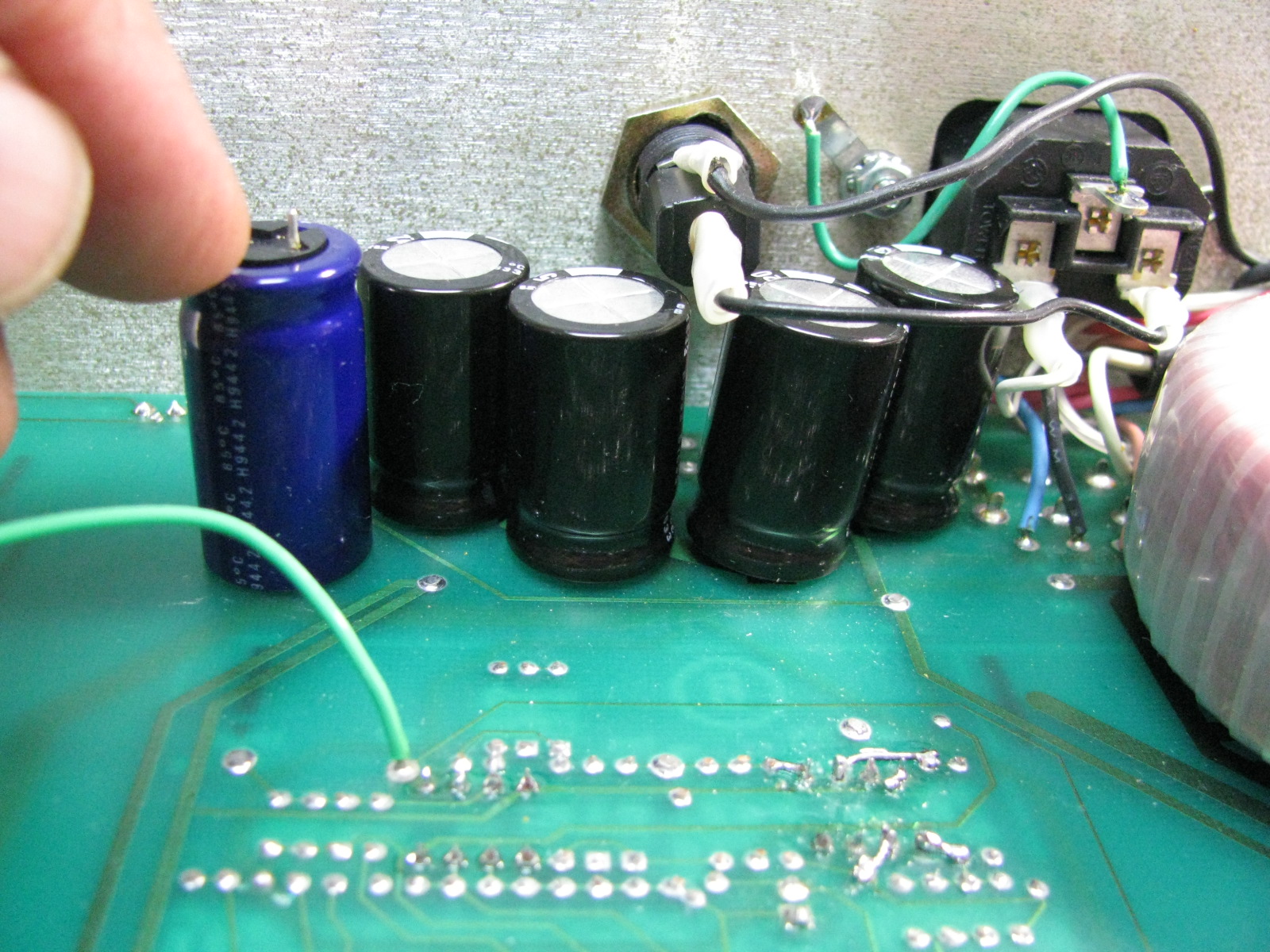

So here is the ripple under max load, the first 3 pictures. Unfortunately all with the Rigol. About 3/4 of a volt riding on top of 24V. I didn't even bother taking a picture of the ripple without a load given how small this is. This is the two electrolytics feeding the voltage regulators. Out of the voltage regulators the only ripple is about 10mV of the actual frequency the generator is set at, as expected. The load current through the regulator times the regulator output impedance.

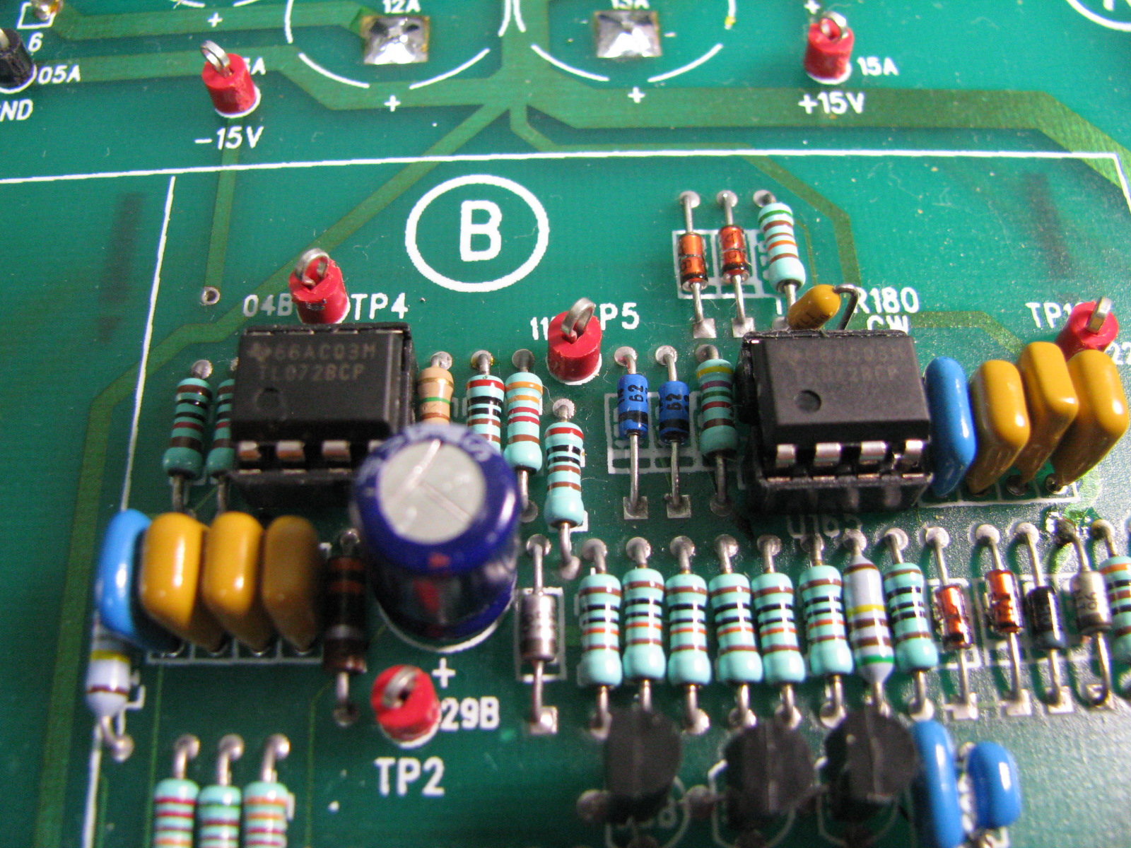

The next photo - well I just couldn't resist trying the TLE2072ACPs in for the TL072BCPs in the AVC section. I socketed them and tried it. The TLEs don't work. The AVC reguation is all over the place and it doesn't work at all for 10Hz for some reason (one chip gets hot at that frequency so I assume it is oscillating there). So the old chips are back in and working great.

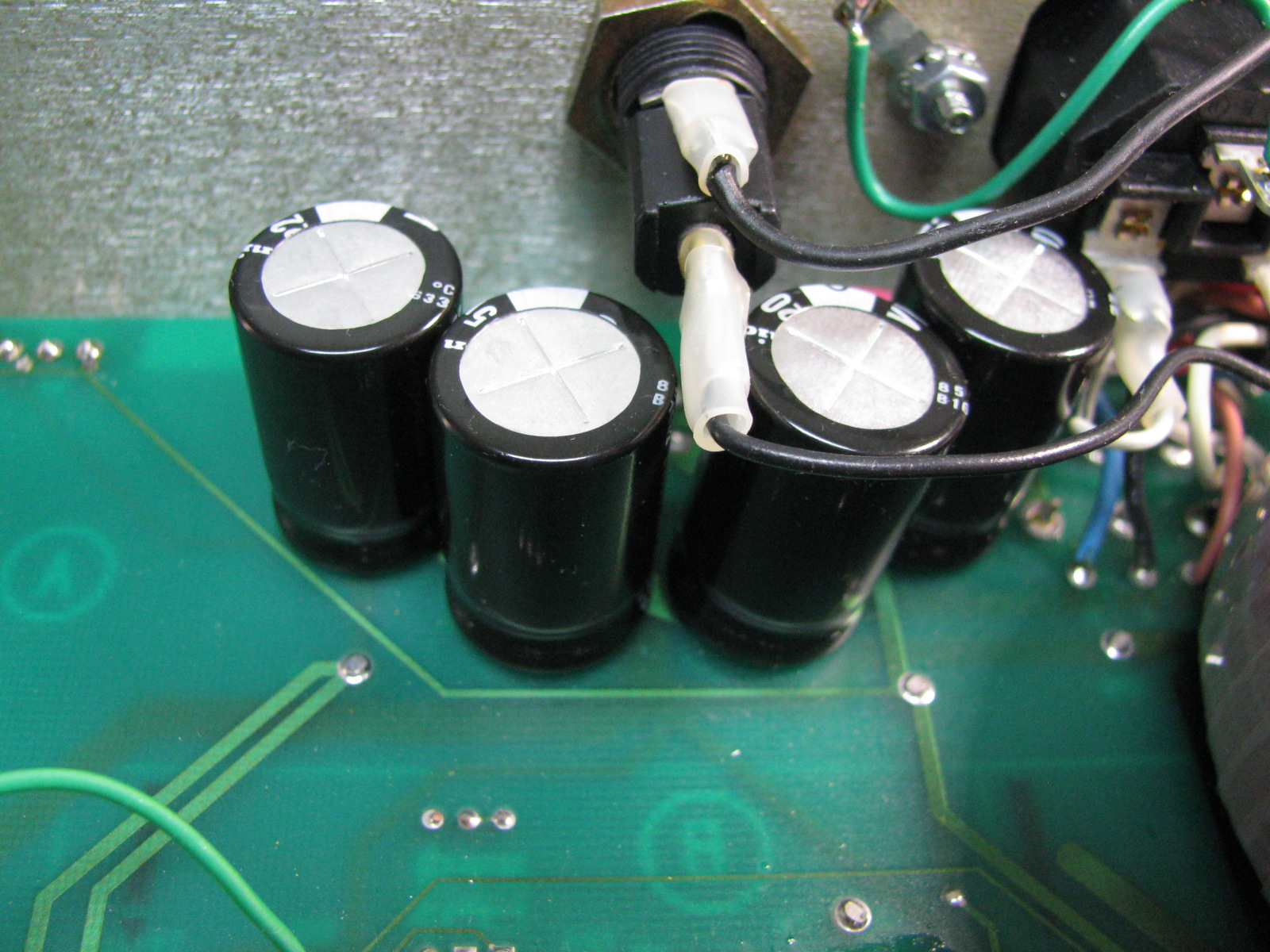

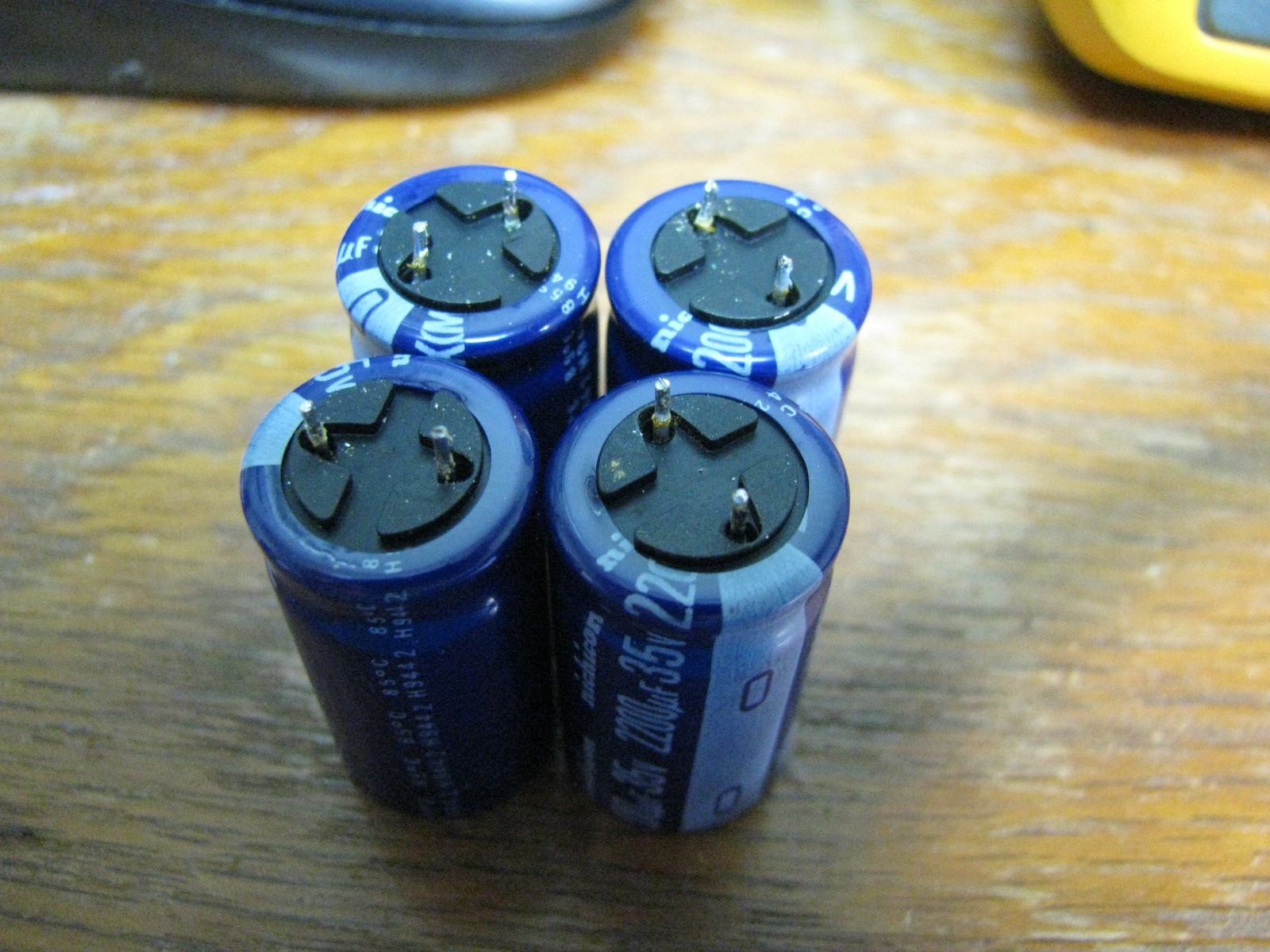

The final photos are changing out the power supply electrolytics. This made zero difference in the ripple. Exactly the same after as it was before, both input and output of the voltage regulator. Apparently those 20+ year old electros were still working pretty well. Note no leakage in the photo, but KH did a smart thing in mounting them upside down under the board. Any leakage wouldn't spread over the PC board and eat the traces. The new capacitors are 5mm shorter for the same capacitance and votlage. They fit under that fuse holder a lot better. KH had a nylon tie around the originals. I don't feel the need to do that with these shorter caps. In the last picture I have one of the old ones up for height comparison.

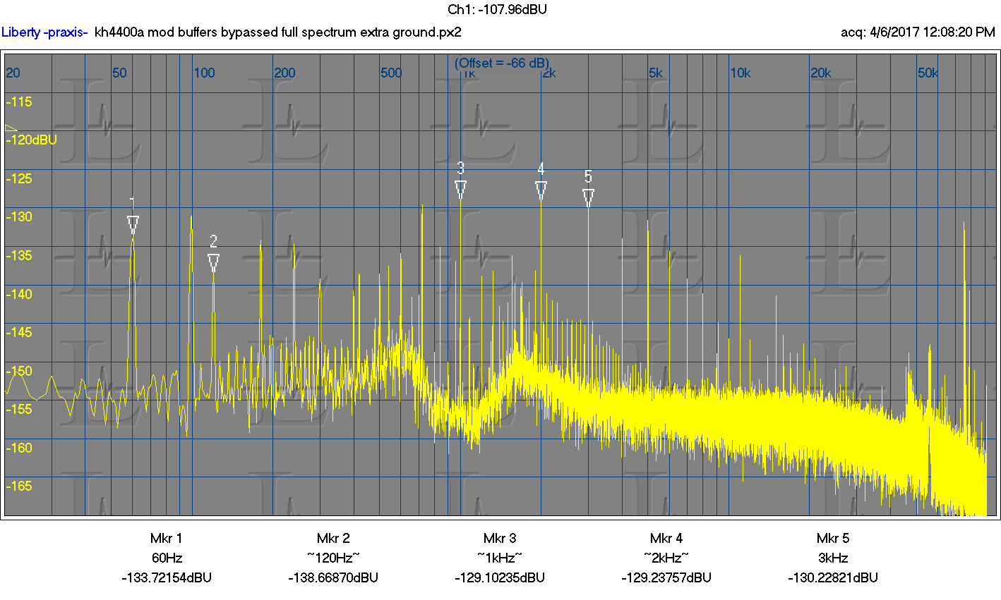

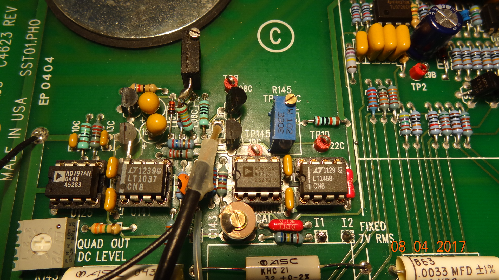

For the 4402B the improvement is easy. I just exchanged all IC with LT1468 except these two here. and added a variable control. This will put you at -135db (1KHz).
THx-RNMarsh

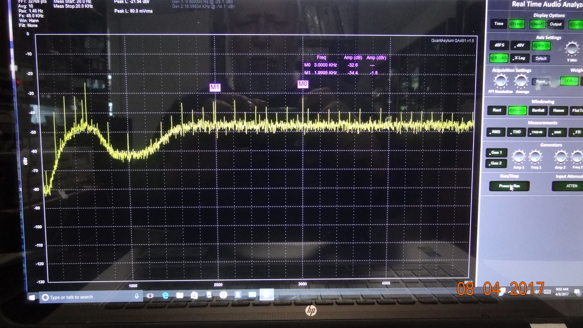

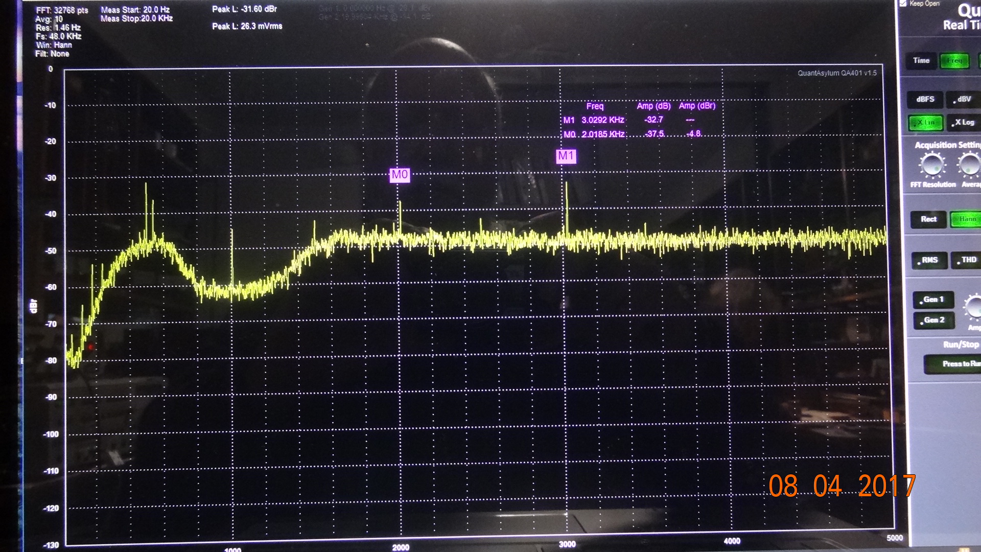

Here is data.... <-130dBv .... Of course to tune for lowest distortion, you have to be able to accurately measure it.
The added trim interacts with the other pot and makes adjustment a test of patience. It ended up at same value as factory. So no need to change anything except the IC's.
David's generator design is still 10dBv lower distortion and lower noise. An impressive achievement.

and with the cover on, computer on Battery power only and ON for 1 hr ---> 1.1KHz:

I loked again and I'm now convinced the harmonics are coming from the level detector. I looked at the signal on TP3 and its spectrum has the same harmonic pattern.
Simple fix would be a big filter cap but then the settling time gets really long.
I'm debating adding an inverter and ac coupling the inverted harmonic spectrum to cancel the one that is there and get clean DC. Its a long shot but I don't see any other easier way. Not sure its worth the effort if the residuals are all at -130 already.

Old, thin, PC trace alert! TLE2072s work just fine for TL072s
A word of caution for anyone modifying these things: the PC traces are extremely thin in places and old, not well adhered to the board anymore.
When I removed U150 the tip that I used on the Hakko 808 vacuum desolderer was just a tad too big it turned out, 1.3mm vs. 1.0mm. and sucked two of the tiny PC pads right off the board. When I removed U165 I changed over to the 1.0 tips and that solved it, no missing pads, or so I thought.
I had repaired all the damage around U150 and thought everything was back together. But the x10 multiplier range wouldn't work at all and x1 was sluggish. After some time with a meter and magnifying glass this morning I found a hairline crack on the trace going from the pin 7 output of U165 to the feedback loop. Fixed it and all is back to normal.
The upshot: the TLE2072ACP chips do work just fine in place of the TL072BCPs! It even looks like the loop settles just a little faster with them in. The oscillation I was getting before (U165 back to 90F vs. 120F!) was due to that broken feedback loop.

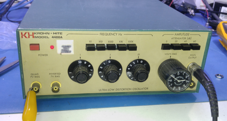

KH4402B now on eBay
The fellow I bought my KH4400B from last week just let me know they have a KH4402B up for sale now, for $799:
Krohn Hite Model 4402B Ultra Pure Sinewave Oscillator | eBay
It also has the "make offer" button so maybe there is some negotiation room there. This is the currently-selling KH model of course. I think that I saw it listing for $1700 on the KH site but can't verify that right at the moment. The eBay listing claims it is functioning. My 4400B worked just fine.
Disclaimer: I'm not affiliated with this seller in any way, just a happy customer after my KH4400B purchase. I figured it would fit right in with the thread of modifying these things. 🙂
