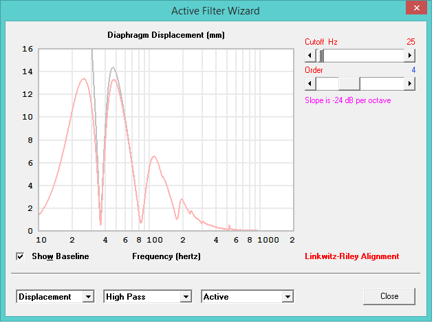

This is probably a stupid question, but what high pass crossover point is suited for the Keystone to protect from over-excursion at high SPL, the amps I'm using are class A/B, will be bridged and put out 3500w at 4ohms, I had thought running it from 35hz up as that's what it was designed for but can I set it lower.....safely??
Rowan
This is just on my hornresp sim so take it with a few grains of salt, but the lower excursion maxima becomes the same size as the midband peak at around 47hz with the highpass set at 25hz for Linkwitz-Riley and 29hz for Butterworth. The peaks are approximately the same size regardless of order used I discovered, interestingly.
That's using the logic that the highest excursion reached below the corner won't be any bigger than the excursion you'd see in the passband. Not sure if that's the best way to judge for filtering, but it makes sense to me at least.
I'd set it just a bit higher to save power/increase efficiency, reduce distortion and conserve excursion.
Rowan
I use a 30 Hz BW24.
