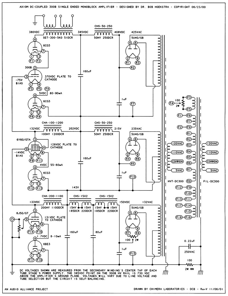

One other thing, you seem to miss. A two stage direct coupled tube amp is the best possible design IMHO overall, because it will have a transparency, that NO three stage amp will ever even hope to have, by the virtue of not passing the signal trough an un necessary middle (3rd) stage.
Another point, if you can't see the difference between passing a signal between two stages using a two inch length of Siltech ( silver with a little bit of gold in it, wire ) versus ANY series connected capacitor at any price you wanna name, well, I will have to give up !!!
If you are unfamiliar with the difference between a well made triode tube amp with zero negative feedback loop, and any feedback amplifier, I suggest you explore both designs and learn for yourself what sounds most like music. Myself, and others, already have - for decades now. Ohh, darn, you can't DO that, your inefficient speakers force you to compromise and use ultra non-linear or pentode operation. Sorry, what a shame. You never ever experienced it, or much of what else I was writing about . Sorry indeed.

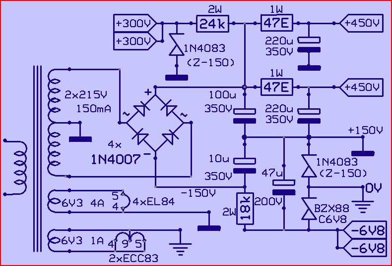

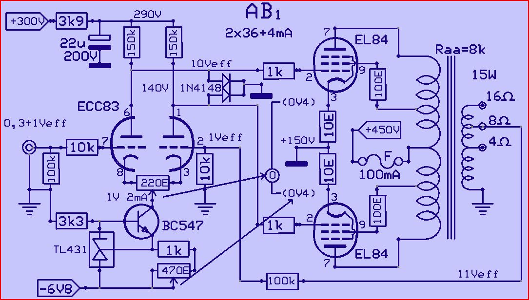

DC-coupled amps,I like that 🙂
Some time ago after seeing a design with even bigger cathode resistors and losses(heat),I said to myself can't that not be done better.
This is what I came up with,for those who like to experiment.I am to old to do that![]()
Mona
Hi Ketje / Mona,
Yes, very good. You have the basic topology, a differential front end as I suggested, direct coupled to the grids of the Finals. KISS rules.
Too old BALONEY, I am 69 !!!
All else in your schematic needs FAR more thought as it needs simplification to make it better and more elegant.
(1) Get rid of 100% of the solid state devices, except for " something" on the common cathode tail of the 12AX7.... one LM334 ?? Tube rectifiers sound nicer. 5V3A or maybe a 5U4GB.
(2) Get rid of EL-84s.
(3) Get rid of feedback loop, global. UGH, UNNECESSARY.
(4) Get rid of any non-triode operation.
(5) Address heater to cathode ratings on the Finals tube, by biasing the Finals' Ef supply.
FORGET about "heat" from large value Cathode resistors. It isn't a problem at all. A NON-ISSUE !! Two Mills MRA-12 resistors will sound great and become bullet proof as Rks. The problem is dissipating large amounts of power to ground through the Finals tube itself, stressing it. !!!
(6) Run Finals conservatively at Golden Ratio plate power dissipation, ( 62% ) reducing mostly current, not VDC across it P-K.
(7) Run 12AX7 at about .0006 A. per triode section, and over 150 VDC Ea.
(8) Apply an elegant one resistor ( Mills MRA-12) shunt regulator to each 12AX7 tube, also called a draw down resistor by some old timers, so Finals swinging current does NOT possibly upset the front end B+.
All this I have HEARD and bits and pieces of it have been done over the years, by different advanced designers. No ones "put it all together yet" as I have above, and applied to an ACRO 20-20, or 20As, as I have offered to do .

MonaHi Ketje / Mona,
Perhaps,not for me.I am 72 but disabled,only one hand more or less usable.
As long it's a reliable current source,the bias depends on it.
What do you have against sand?The tubes are made of it too (glass 😛)
(2) Get rid of EL-84s. Why? good tubes 😎
In that case,connect the grid to ground and put some cathode resistors to limit the gain.
(4) Get rid of any non-triode operation. g2 to a 🙁
Is the case,separate heater windings on appropriate powersupply points.There are two ground symbols,one for the inputsection and one for the poweramp a +150V.
Those big resistors must be decoupled with chemicals 😡 (to get no high output impedance),those from V+ to cathode are the only now and thanks to PP not that harmfull.
Adjust current source !
They are now .001A and 140V,not that far off 😉
I don't see the use of that.The +300V is referenced to the cathode of the finals with a zener.It's allways 150V above those cathodes and the drop on the anode resistors is fixed by the current source giving a well determind bias voltage.
