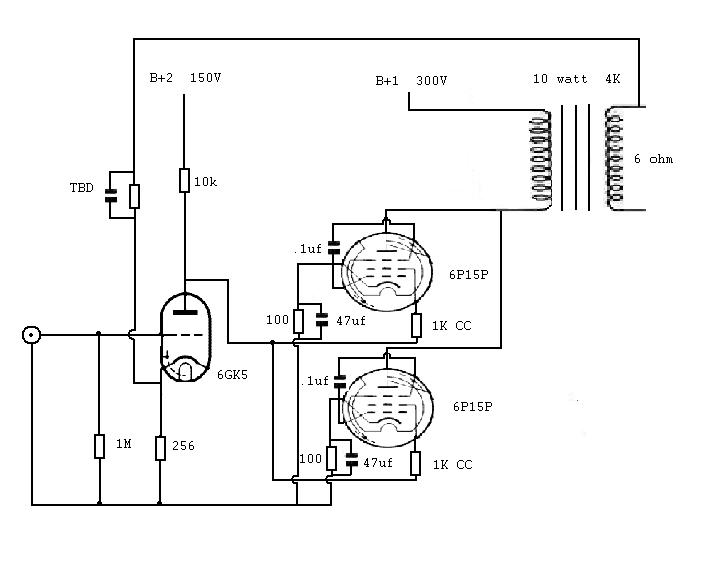

Following this interesting thread I wondering why grounded grid (G.G.) DC coupled SET Amp is not used often ? , here is my concept schematic ,
Where output power tube V1 can be anything from 45 ,2A3 ,300B , VT4C or .... , and V2 can be any low Rp / high mu triode , or even some pentode , or even substituted with some appropriate mos fet .
Best Regards to all !

Why not used very often? It is..for video output stages ad HF amps.
As audio out not so interresting.
V2 needs same current capability as the output valve.
High supply voltage.And very high output impedance that ends in much feedback to lower it to acceptable level.

Quit contrary I think that GG triode is very good topology for audio ( SET ) , but is not researched enough , for example : what if two parallel strapped 6c45p triodes (V2) drive 2A3 or 300b (V1) cathode ?
There is no more evil Miller capacitance effect included , (at least for output power tube) , and high performance class A2 operation is now possible & is quit different from conventional A2 grid drive .

So it's a cascode which (in this case) needs a lot of current.

Hi AatV !
Yes it is basically some sort of cascode ! ,
but I think no extra current is necesary there for normal DHT SET amp A class operation ,
for example G.G. VT4C (211) cathode driven with two parallel strapped 6c45p tubes , common B+ around 1,25KV , 211 cathode voltage and in the same time 6c45p(x2) anode voltage at +75VDC (or even more) , with common plates series current of around 60ma .

When you drive a 300B p.ex.with a cathode follower there is not much hinder from Miller and for A2 an actif pull up.
The problem here is the high cathode impedance witch in turn produce an even greater anode impedance,it makes the triode look like a penthode.

Agree with that !
Except that except DC coupled CF driver stage we need there one more input gain stage at least , that`s altogether three stage Amp, I try to limit this GG Amp concept to only Two DC coupled stage .

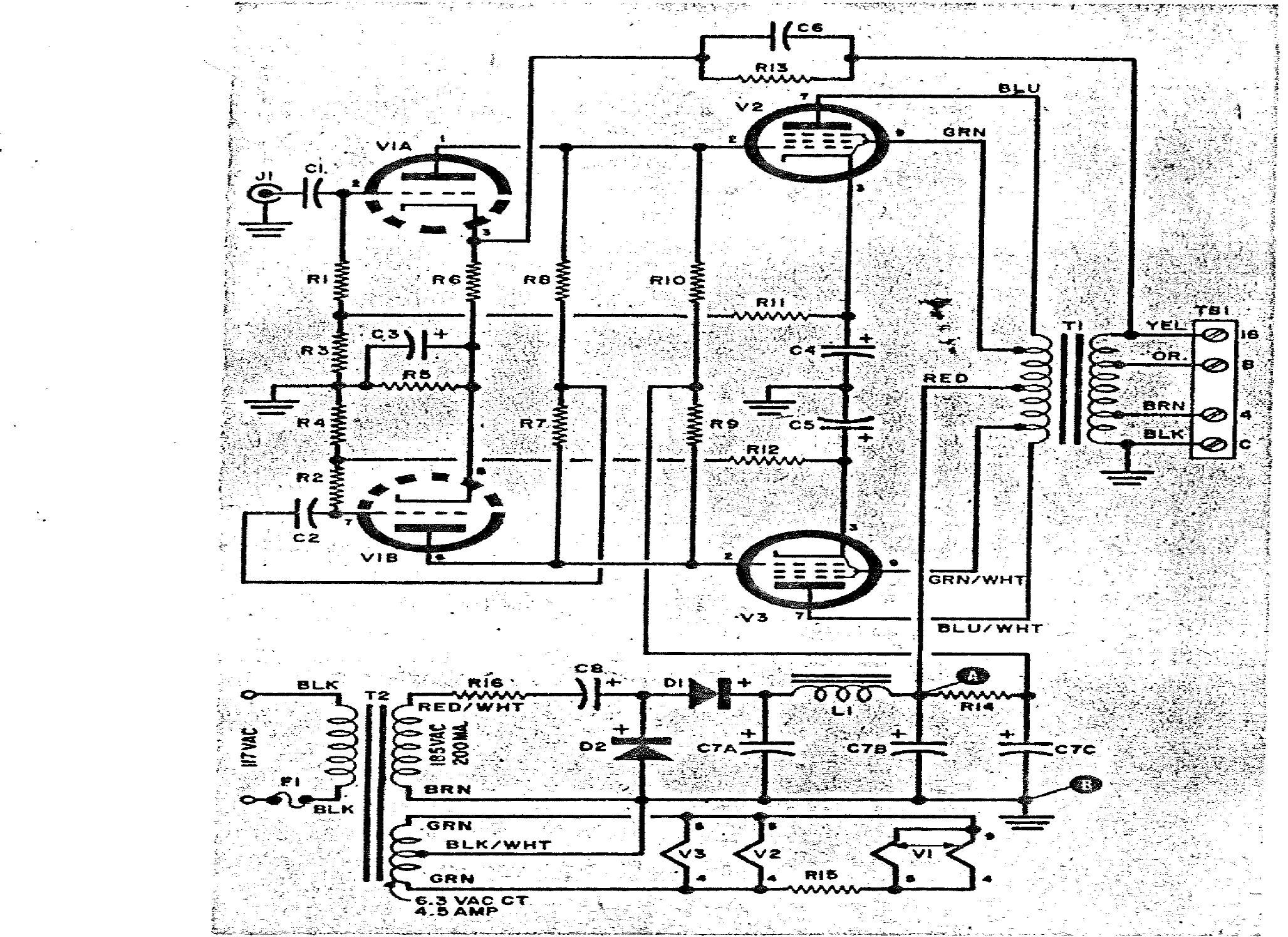

I spent 1 year fixing up my acro 20-20. My goal was to lower the idle current in the output tubes while keeping the amp perfectly functional.
After many attempts and tries in error, and with the help of Dave Gillespie, it's now a solved problem.
The only way to achieve this without disrupting the direct coupling is to increase the cathode resistors. 3K to 4K would do it to your taste.
Also starved mode is not that well supported by modern tubes. They add distortion compare to a NOS tube. You may want to use a vintage tube for the 12AX7/ECC83 driver tube, balanced section is a must.
