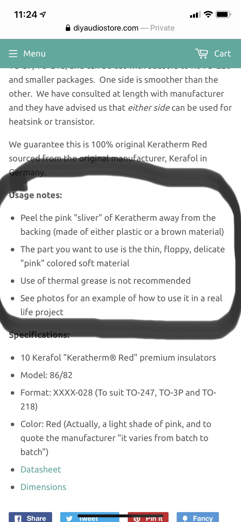

Quick question, the keratherm has the woven "bronze; looking material and a separate white material - do I use both under the mosfet and if so is the bronze size down on the heat sink and the white material on top of it (under the mosfet) or is the white material just some some sort of backing material that's used during production and I don't use it at all?

Further to ZenMods reply. This is from the DIYAudio Store Keratherm product page for reference.
