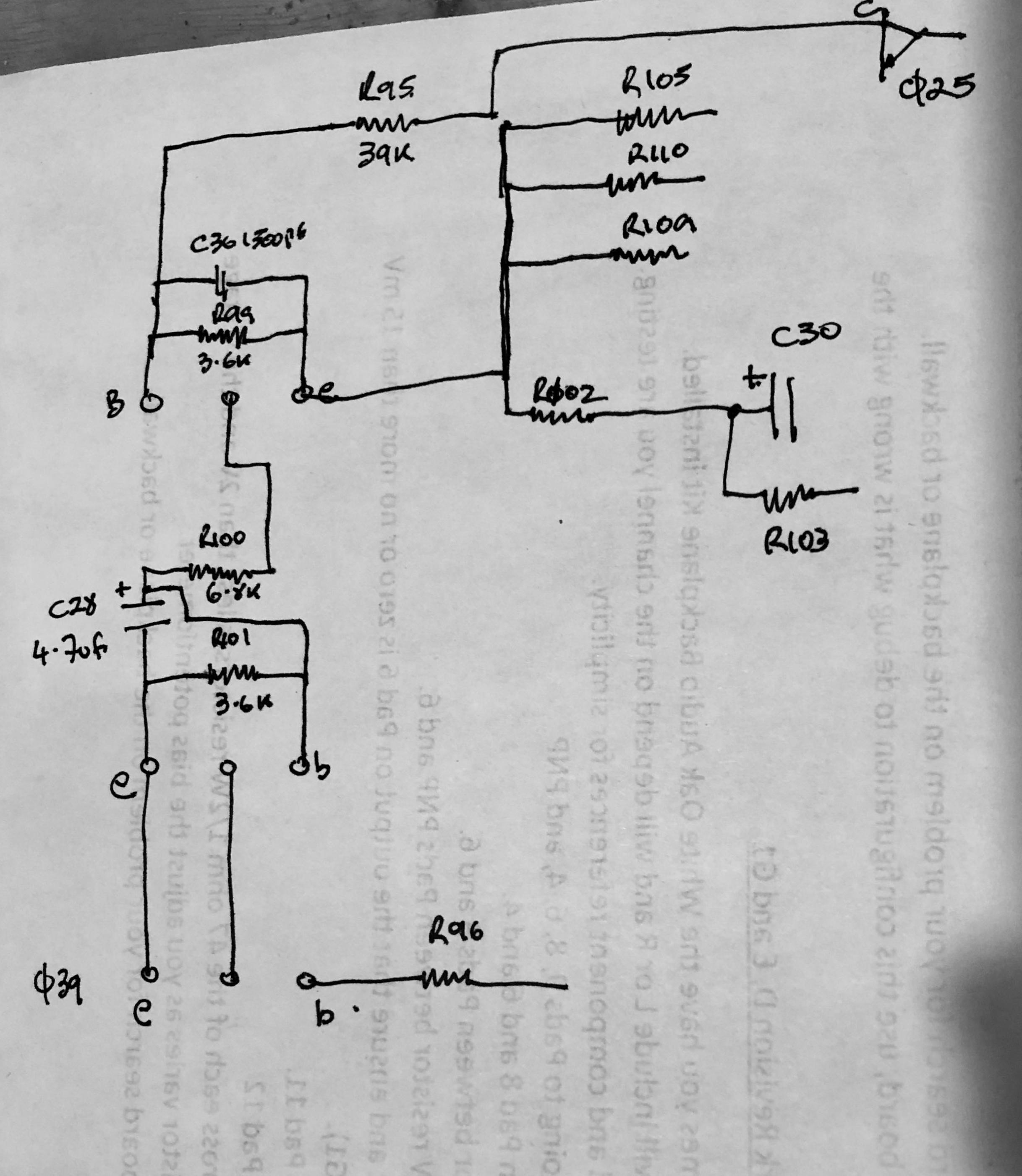

Agree, need 1.2V on Q43b, probably due to increased current(and volt drop) through R102, R103. If Q39 is on it will drain current. Likewise Q40 and Q42.
Maybe work out where the bulk of this current is going.
Calculate current through R102 by measuring volt drop across it. Repeat for R103.
Expect R103 current to be less than 50% of R102. Would point to Q39...Q41
otherwise Q43,4. Compare with working side.
Check C30 for solder bridge.
Is LED D39(protection) on

yes I feel the same-
I will check the voltage drops, and will draw a new version of the Q40/Q41 circuit as the emitter of Q41 goes to R109,R110 and R105 as well as R102
Will check LED and solder joints (have been redoing some and using the big magnifying glass..

Bad unit- R102 -60v A =00027/ R103 -3v (fluctuates between -2.5 and -3.2) A=0.00008
Good unit R102 -55- A=0.00025 /R103 -6v A=0.00016
The LED (39 is on on both units- I think it is an indicator rather than protection
There is no solder bridge ob C30

Your diagram helped a little. Q41e connects to the 71V rail, I incorrectly had it on the other side of R102, that's why I was looking for R102,3 currents.
Bad unit has an extra 5Vdc drop across R102 (.02mA). Does not appear to be going through R103, points to Q39,40, 42. Some of these already replaced, will check orientations...
