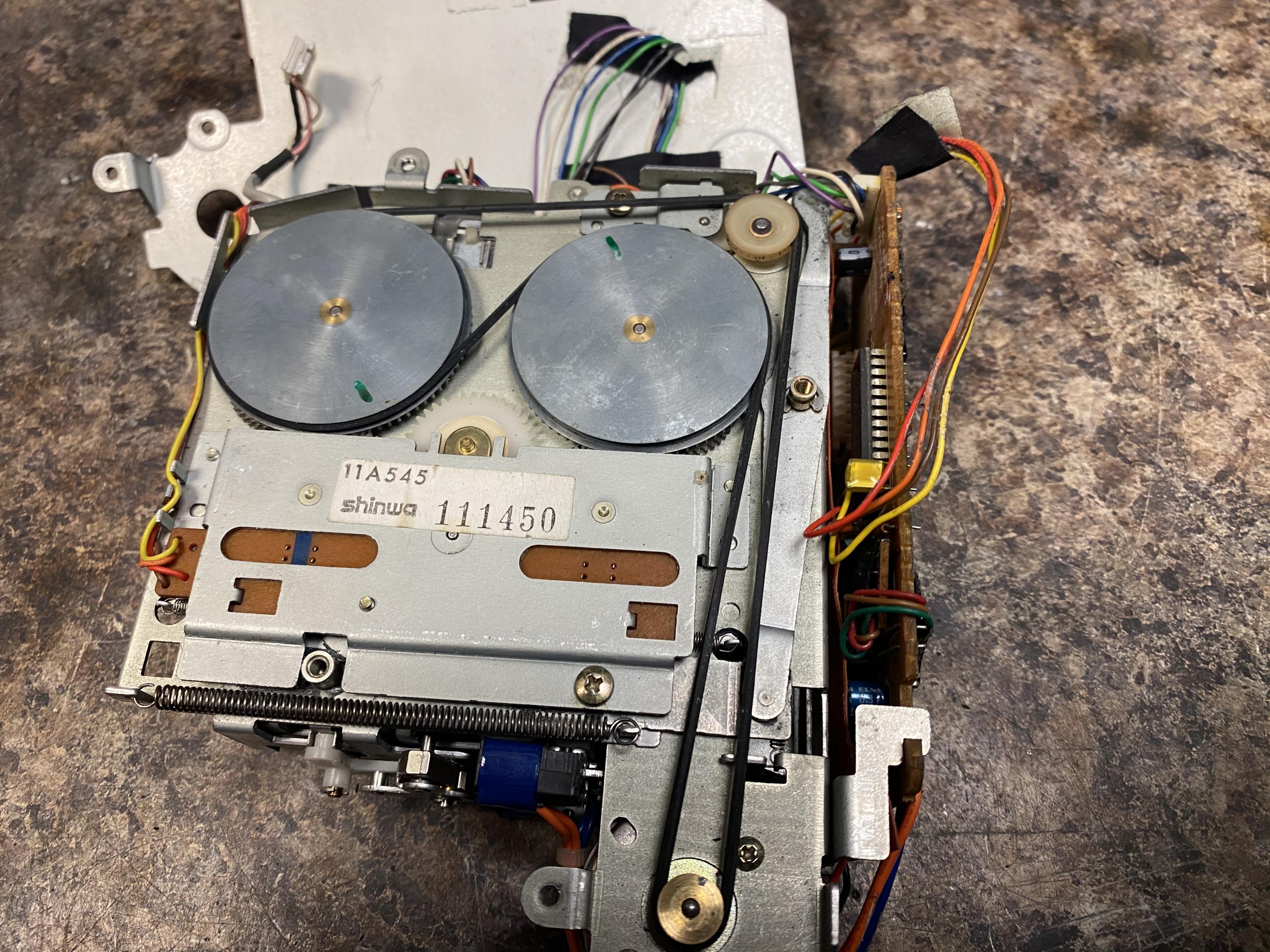

Tape player doesn’t work at all I bet no response from the unit .
It won’t play tapes won’t fast forward wound rewind won’t eject .
Could this be from bad solder connections or bad caps or does this sound like a different issue ?
Any thoughts ?

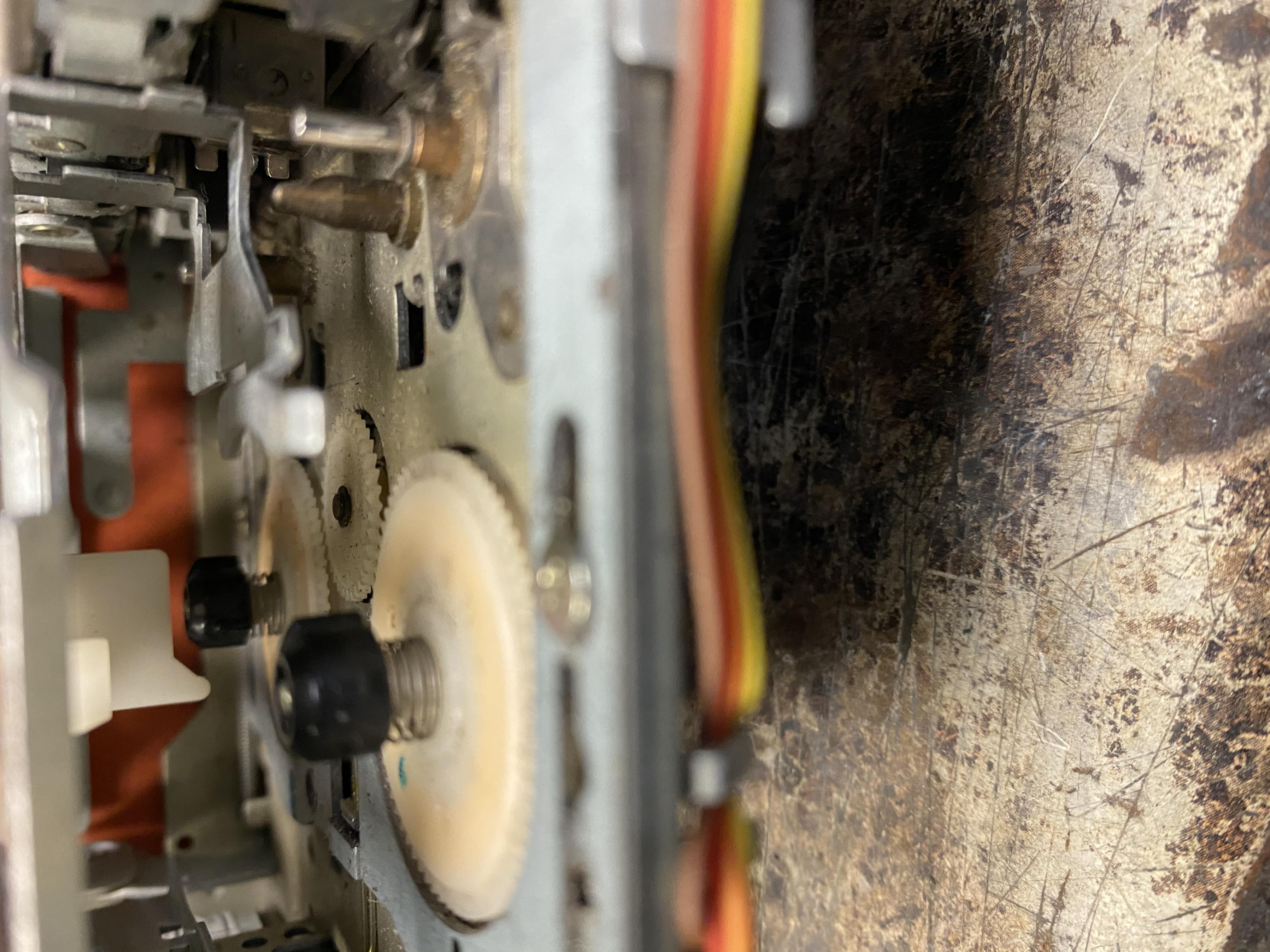

I replaced the belt since I saw it was stretched out .
I will have to see what switch is triggered when I drop a tape in .
With the new belt of no tape is inserted the gears will spin if I drop a tape in the unit the tape with not spin and just keeps ejecting .
Wondering do I need a even shorter belt or what would cause the tape to not spin and just keep ejecting the tape
In pic 1 the pulleys turn if there is or isn’t a tape in it .
Pic 2 the capstan stops spinning when a tape is loaded but the pulleys will continue to turn slowly .

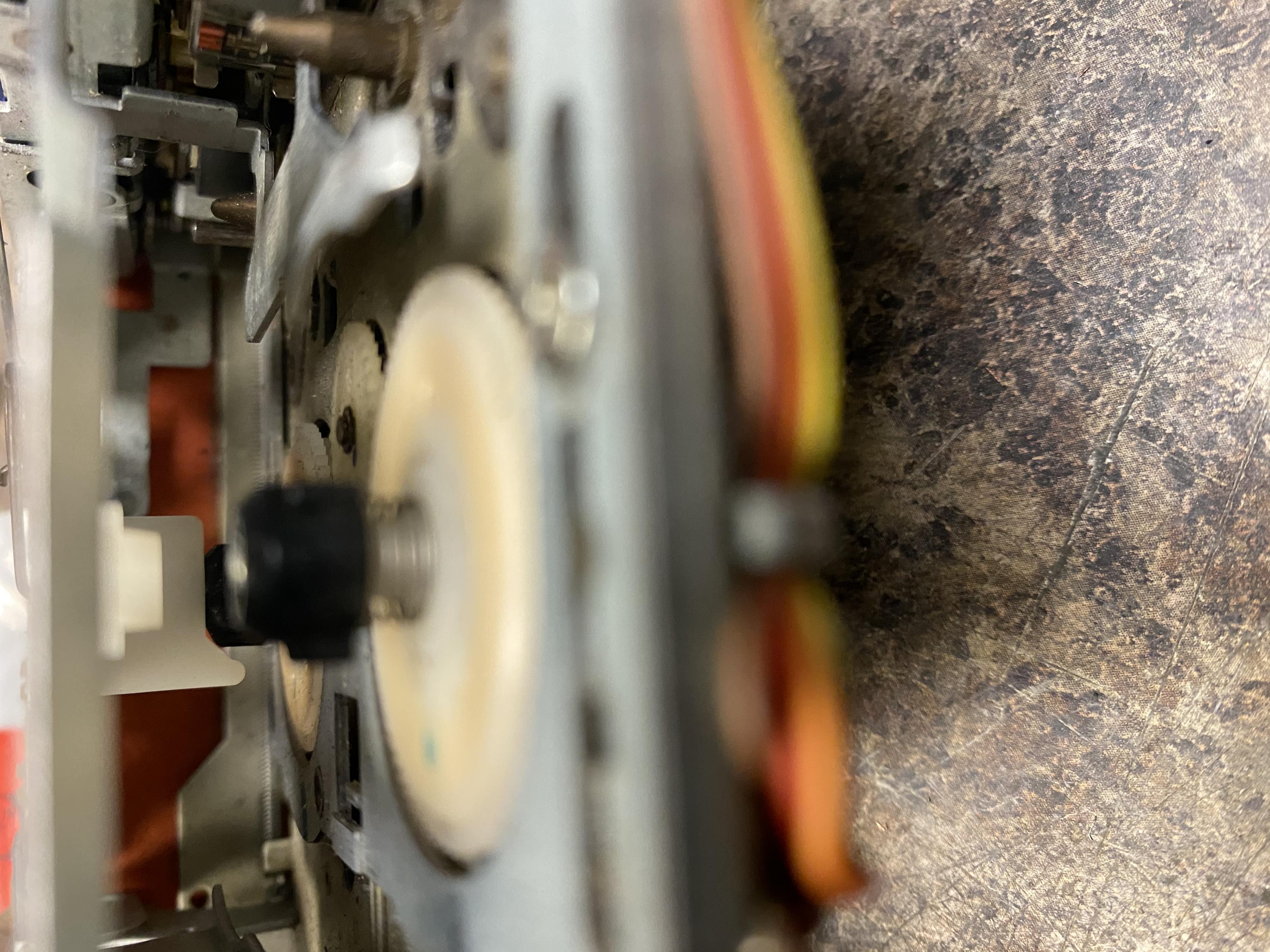

I’m gonna explain this the best I can .
In the pic the black capstan is on a shaft and pulley
If no tape is inserted they will spin along with the gears when I spiny the pulleys by hand or with the motor
If I insert a tape the pulleys will still turn but the black capstan stops spinning all together
