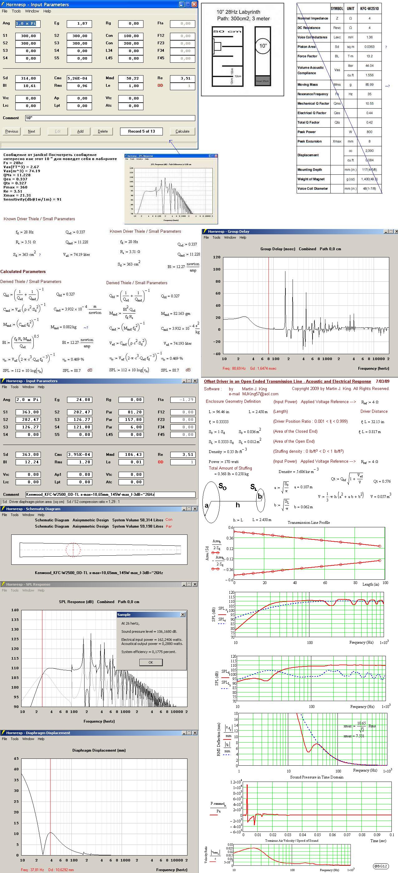

Ugh! Bad acoustics, what with the dims in even multiples, especially if the ceiling is around 8 ft.
Well, for HT it needs to be tuned to at least 20 Hz and preferably lower if no true sub is used. For music, ~32 Hz is low enough unless you like to listen to pipe organ symphonies that can have usable output down to 16 Hz.
Don’t know which Needles you’re planning, but ideally you’d want at least 200 W/driver since it’s so inefficient, so will probably need EQ to tonally match the mains through the XO BW.
Regardless, due to the driver’s tiny Vas dictating an acoustically small cab with a long vent to get a low tuning, using some form of TL such as bjorno has suggested is the way to go.
