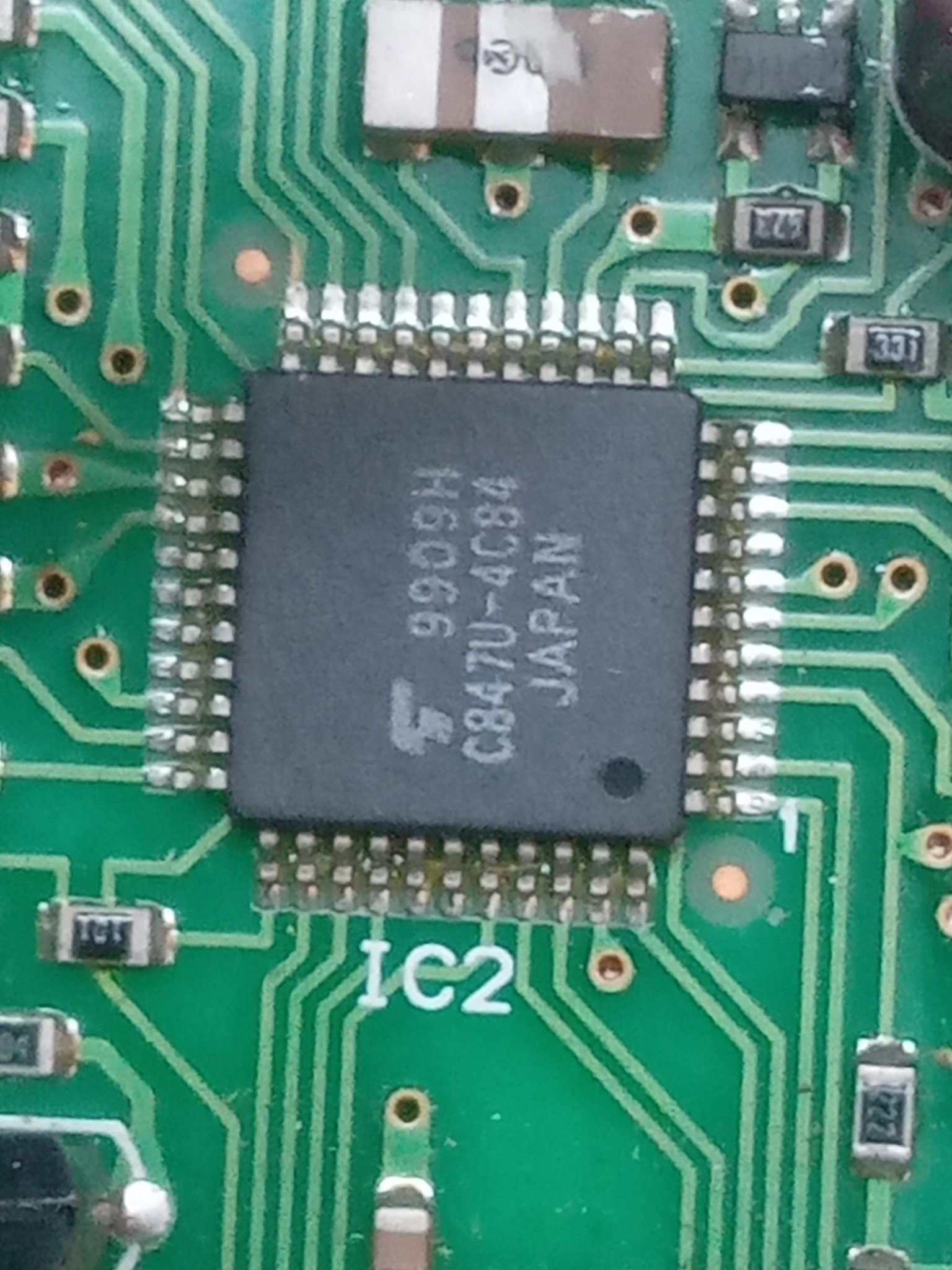

Were there any shorted/defective components that were clamped to the heatsink (FETs, output transistors, rectifiers)?
DCV on pin 30 of the MCU?
Which leg is connected to R2It should be near Q9. They are connected by R2.
