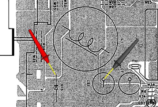

All measures fine on the front side. I was able to take the amp out of the enclosure and started to trace p+ after unplugging from the car. When I got to d16 and and had my multimeter set to ohms i measured no resistance. Could this be my problem? D16 looks like a resistor with the shape and colors but seems to have a glass sheen on it. Its size is also smaller.
Correction:
D15 is the reverse protection diode. D16 is a zener diode.
With no power applied to the amp, measure the resistance between the two points in the attached photo.

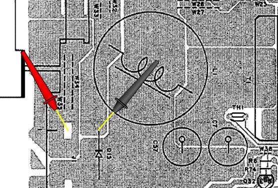

There will be another photo in the next post. Measure the resistance between those points also.

All works. Just a bad solder point. I sucked up the old solder and resoldered both points on the coil. Everything works fine. Like new. Thanks alot for your help. By the way your website is really good. I got a lot to learn and will start there. Let me know if I can do anything for you. I happen to manage a industrial lcd manufacturing floor and we have monitor components go bad all the time. Touch screen controllers as well. You could probably fix alot of them. Let me know if you are interested and next time I scrap a part I will send it to you.
