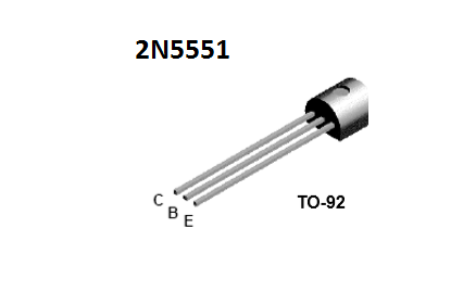

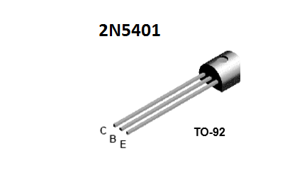

So you have available the 2N5401 and 2N5551 and TIP41C and TIP42C. Is that correct ? Two drivers, two outputs.
And we are working on the zapped channel, yes ?
morning mooly. yes sir, that's correct, 2N5401 and 2N5551 and TIP41C and TIP42C. i have removed all transistors from the zapped channel.
OK. This is how it should end up. We were saying the outputs were OK I think at this point.
Familiarise yourself with the pinouts.
Remember to turn the bias preset on both channels so that it has maximum resistance (so its like a 1k resistor)

ok, will do. now, i of course noticed that the pinouts are different on the new drivers than on the old (haven't even looked at the new finals yet). does it matter how i bend or manipulate the legs to get them to their correct holes? avoiding any shorts, of course. on many of my amateur radios, such as the yaesu ft-1000mp, one must be careful when installing replacement transistors, with yaseu supplying a diagram showing the correct angle to bend the leg(s), this might just apply to rf, i guess. i really am a noob when it comes to SS.
