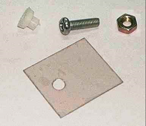

Both those will need the correct insulating kits for the "T0220" type package as shown in the picture. And you have to be sure you can mount those OK on the heatsink because they are physically different to the originals. I don't envisage a problem there though.

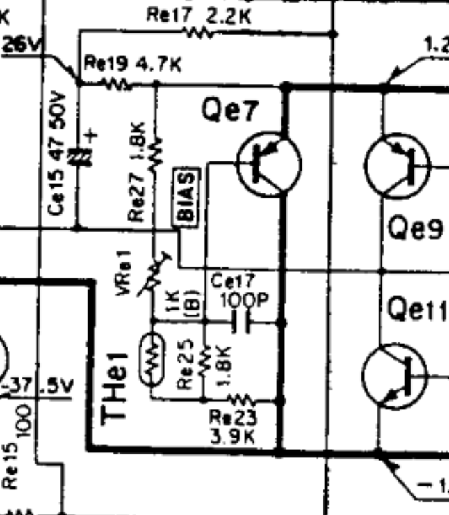

QE9,11,13 and 15 are part of the protection circuitry. Whether faulty or not they are no problem in getting the amp working as the amp will work correctly with them removed. If they did prove faulty then 2N5551's and 2N5401's would be fine as replacements.

3. can i use either type of insulating kit for each of the new transistors? i do have a few pieces of mica here somewhere, and i do have the heat transfer compound. whichever of these mounting kits you think i should use is the way i will go.

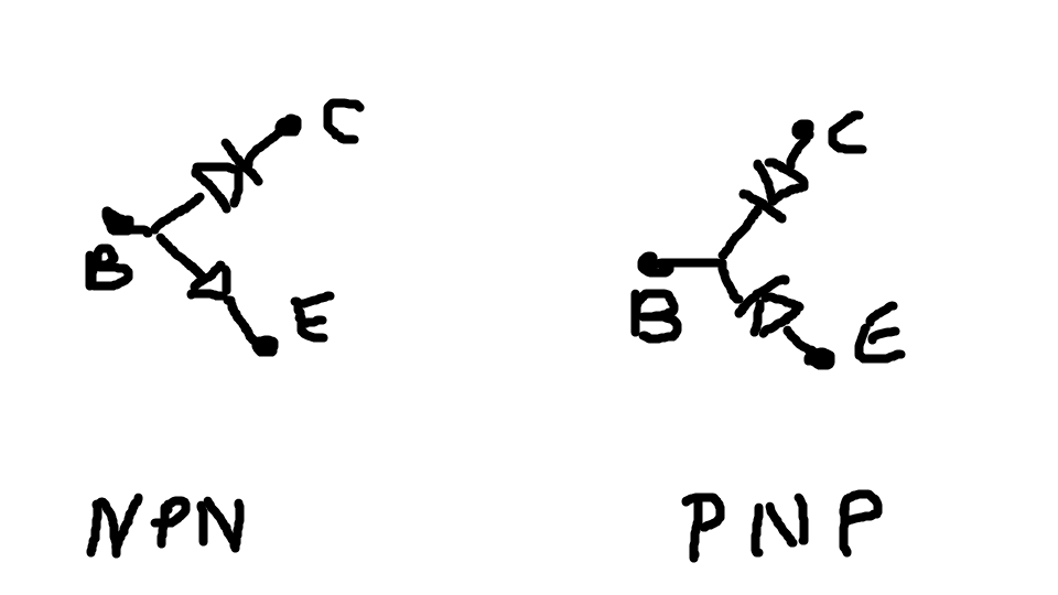

If the transistors are short circuit (or nearly so) then that will show up in circuit. On a DVM on the diode range if you see something like 0.127 between C and E and with the meter leads both ways around then they are duff. The 0.47 ohms can probably be checked in situ, the others quite possibly not, you would have to isolate one end.

OK 🙂 And remember as a first step that its easiest to check for shorted devices with them still in circuit. If they are short they are short.

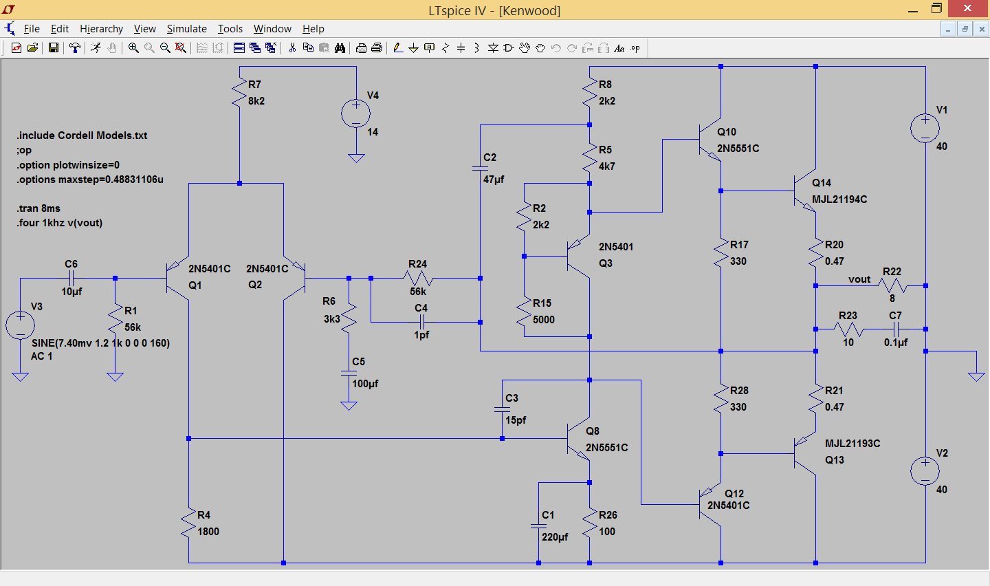

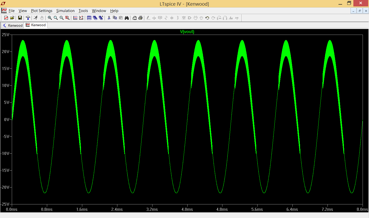

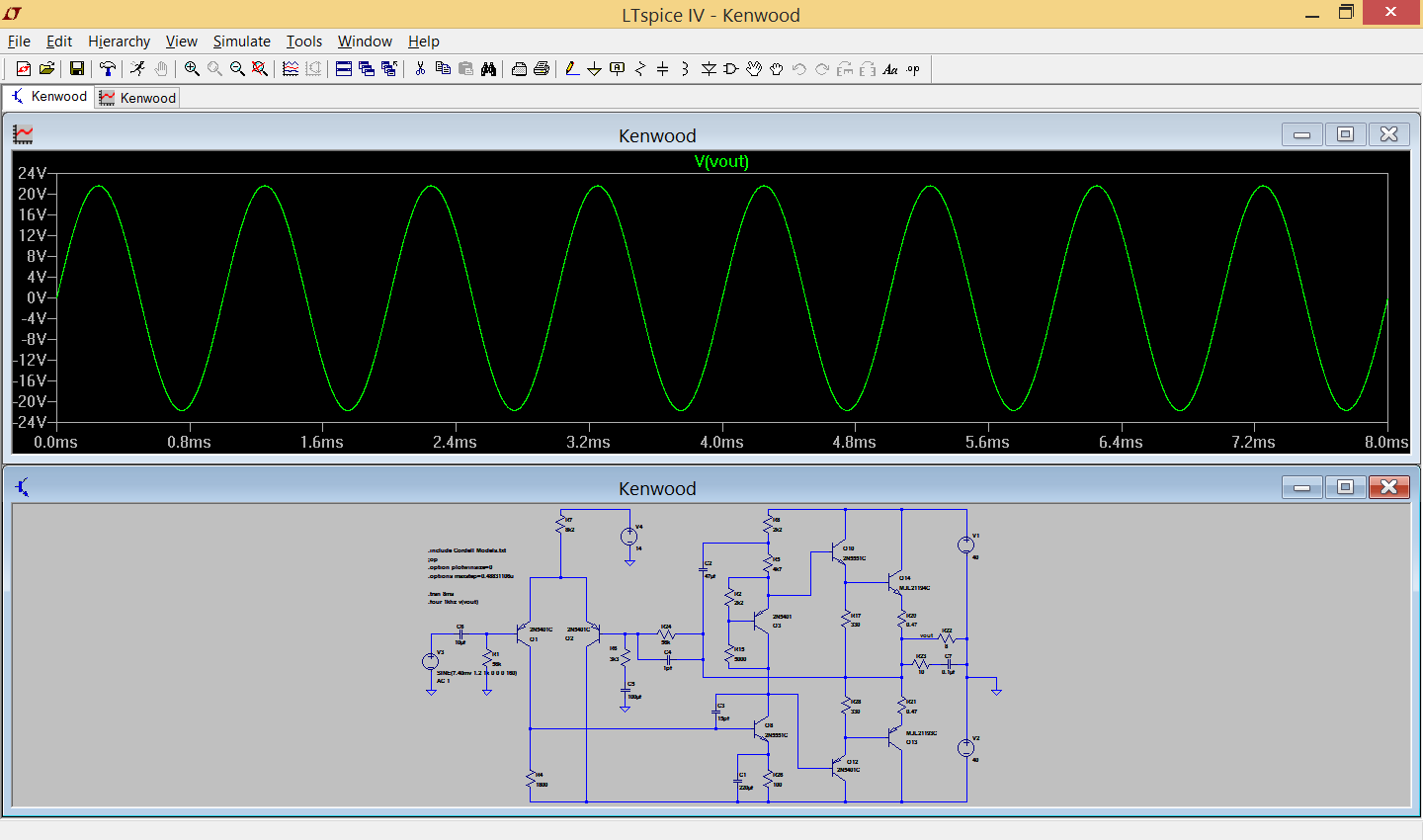

(And for interest I threw the basic circuit into a simulator to see what showed up and Sakis is correct on the drivers being a little problematic, the MJE340/350 combination that I initially suggested did actually show a problem that would have needed other component changes to get them to work, the 2N5401/5551's however seemed fine)

Will the 2N's be OK. That's the big big question. As your interested I'll show you the simulation I ran. I did this just for my own curiosity 🙂 Its basically your design less the protection circuitry. First up is the circuit (using 2N's) followed by showing the full rated output into 8 ohms. For what its worth the distortion came out at 0.006% The driver currents are surprisingly low at 45ma peak. Even with crummy 2N3055 type outputs they are still not that horrendous.
Then we have the same test but using the MJE devices I suggested earlier and which Sakis suggested could be problematic... and indeed it seems they are as you can see. Thanks Sakis 🙂 There is oscillation and instability.
Now in the simulation (and don't read too much into this) it seems that the upper driver (the NPN) is the most critical in that fitting a much slower and lower gain device for the PNP alone didn't cause an issue.

Yes, its quite useful program. Its not infallible though and the results (real vs simulation) depend on many factors... but yes, worth its weight in gold.

Before you power it up (with the bulb/variac) we need to turn the bias on both channels to zero by turning the preset so that it has maximum resistance. In other words so that it appears as a 1k rather than a short. That will allow Qe7 to be turned fully on which gives the lowest bias current.

You were measuring in circuit I think initially which can give misleading readings. Lets be sure... if you isolate the base and emitter you should read around 0.6 ish from B to E and the same from B to C on both devices. That is with the red meter lead of the DVM on the base for the NPN device (the top one) and the black lead on the base for the PNP. With the meter leads reversed there should be no reading.
If you imagine the junctions as diodes then this is how they should measure.

Don't be impressed of the simulation results these are partially ideal or even wrong the models on the transistors may present different results and for the simulator transistors are perfect , do not suffer from thermal issues , power supply and ground are also clean together with absolute perfect distribution and so on and on .
In real life circuits none of the above facts exist .
Simulation is just an indication and will help you proceed if you manage to come even close to the simulation you have done a grate job !!!

I thought you might be 😀
(It was interesting to see the MJE's show instability in the simulation though)
