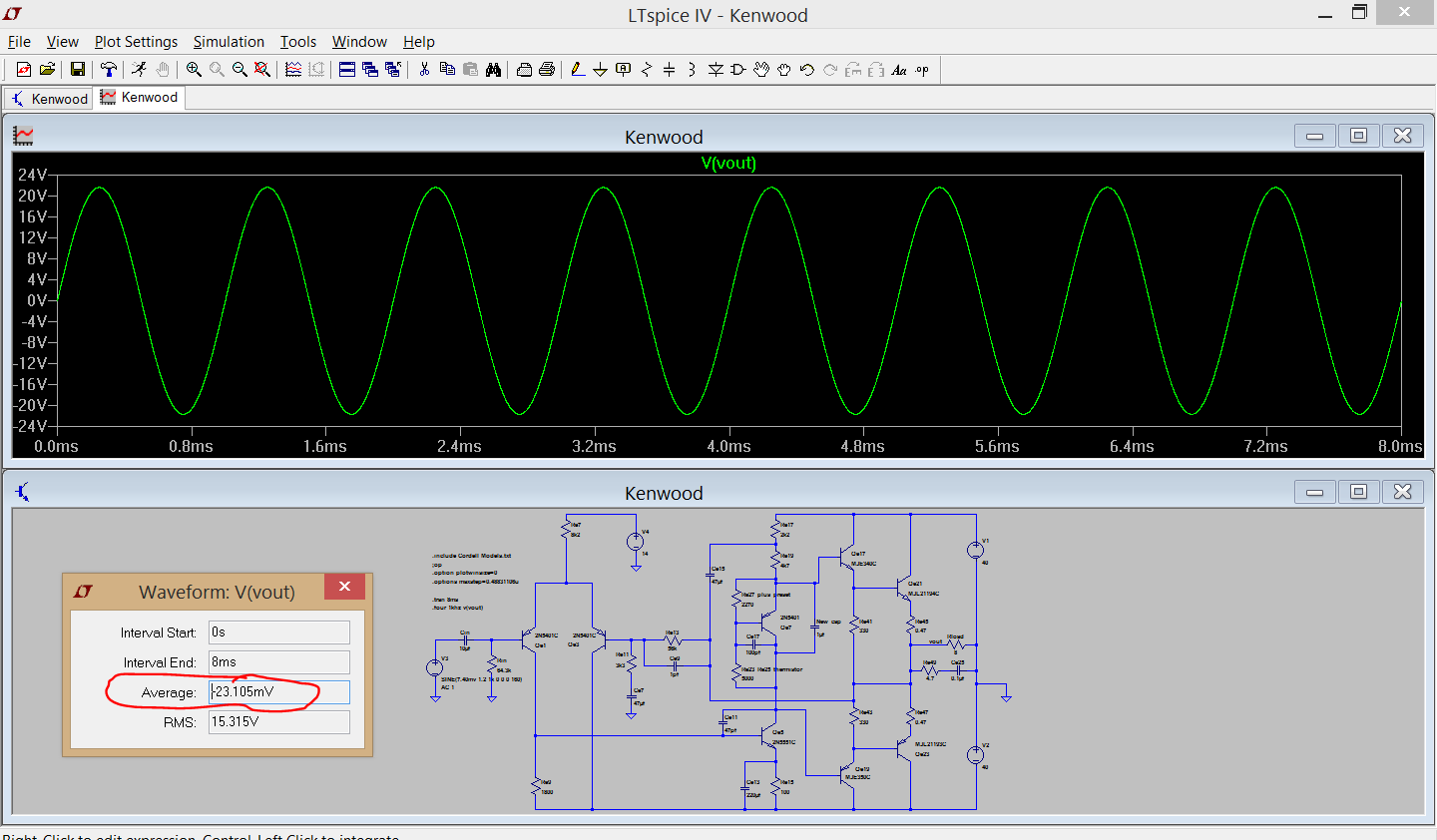

mooly. i removed Qe9 and Qe11. the DC offset rose to .225 (from .209V) and the bias has now dropped to 0V, with no change with bias adjustment.

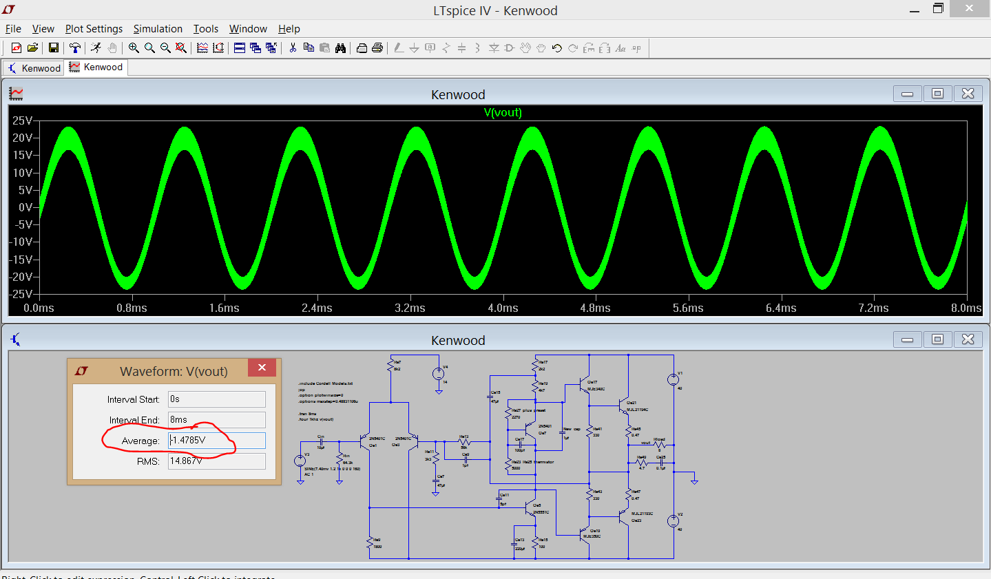

I think there could be two issues at work here now. If its oscillating a small (and it must be small) cap across Ce11 could prove it.
Get your scope fired up...
I'll tell you what I'm thinking, before the scope revelation 😉
Removing Qe9 and 11 should have had zero effect. If you quickly check them on your meter do they read faulty (very low and leaky) ?

In a nutshell... the offset you have is small and doesn't suggest a damaged or non functioning device or component. Such things tend to cause the output of the amp to swing toward the rails. This is more subtle.
Causes... the most likely at this point is a form of instability. A tiny cap across Ce11 would nail that as the cause. If it were unstable the adition of the cap would kill the oscillation dead.
You say you have a 500pf cap (must be 100v or more because it sees full rail voltage at times) then adding that across Ce11 would still prove the point but its to big to leave in... it would limit the amplifiers high frequency response.
