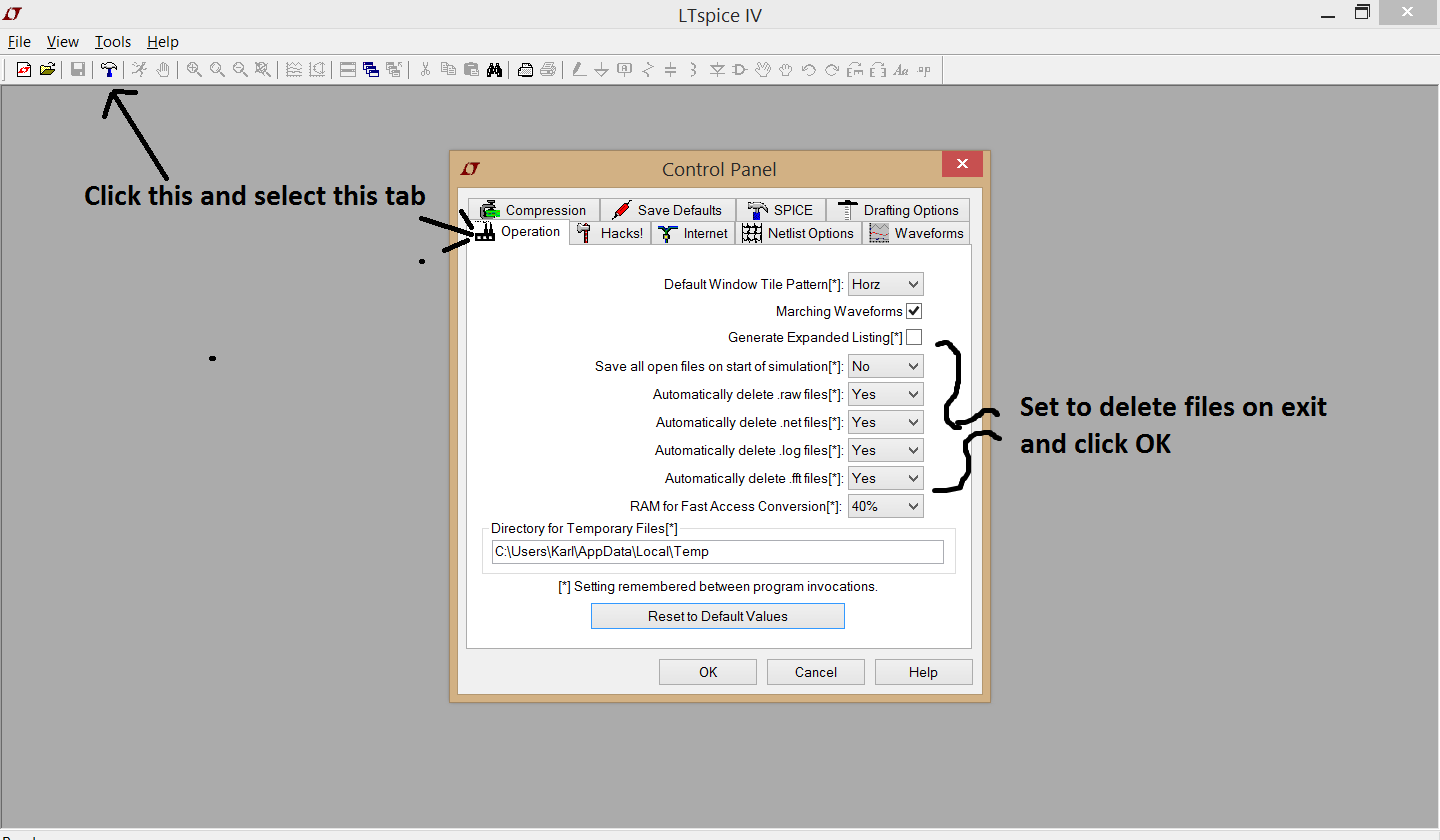

Here is the simulation file for the amp. The zipped folder has two files that need to be kept together for it to run. One is the simulation file and the other the models for some of the transistors. So just extract the contents and keep them in the same folder.
If you do install LTSpice then I recommend you set these options which will delete temporary simulation files automatically every time you close the program.
To run the Kenwood file you can either browse for it (click file and then open at top left) or just click the .asc file which will open LTSpice with that file.
Fifth symbol in from the left on LTSpice is a little running man. Click that and the program will run. You'll hopefully get a small window open with lots of voltages and info... close that 🙂 and then just move your cursor over component leads, resistors, transistor leads etc and you'll get instant voltage and current readings together with power dissipation in all the parts. The info appears at the bottom of the screen and changes with your cursor position.
