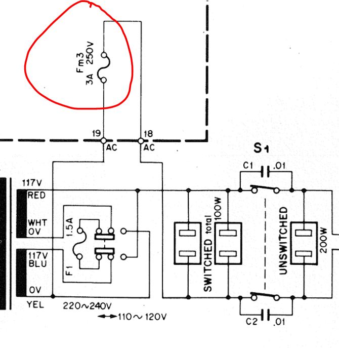

The mains fuse at the transformer (F1) is taken out and we attach a 60 or 100watt bulb across the fuse holder. Make sure the wiring is safe to the bulb.
Next we turn the bias pre-sets VRm4 and VRm5 to maximum resistance. If you put your meter on ohms (probably going to have to be 20K range) and put the red meter lead on the emitter of Qm13 and the black lead on the base and then turn the pot to the end that gives the highest reading. It should be around 2300 ohms but other components will alter that reading. Just turn it to the end that gives the highest resistance.
And that should be just about ready to test for real.

Need to find a 60 Watt bulb here.. Since 2012 they are forbidden in the Netherlands (not in the uk?).
vr4, and vr5 are set to max resistance.
I would be surprised tbh. They are in a very low current and low stressed part of the circuit.We can leave them for now and see how it all shapes up under test.
60 or 100 watt is OK. Even a 40 watt might work as the current drawn will be low. Not sure whether 60's are banned here, I don't think so, not yet.
can't do better then 40 watt.. If that isn't good I need to find a shop that sells old fashion bulbs haha.

Sounds like we are ready to test then. Solder wires to the bulb and solder those across the mains fuse holder so the bulb takes the place of the fuse. There are two mains fuses shown on my diagram (one around the voltage selector switch) but its the main fuse Fm3 that you replace with the bulb.
Bias pre-sets turned to maximum resistance.
100% happy with all transistor connections.
I think that's everything covered... so we should be ready to switch on. No speakers to be connected yet.
The bulb should flash brightly as you switch on and then go out (or be very dim). If it stays lit then switch off as there is a problem.

Well, The 60 watt bulb broke on my way home 🙁.
But tested it with the 40 Watt, and as you said, it firs lit up brightly and then goes into very verry dim!
I used the fuse with 3.15 a on it because without that one it doesn't switches on.
And for checking the 0vdc, I measured the fuse that's next to the main amp (old picture)
Sounds good so far. Hard to make out in the pictures but it should be the mains input fuse. (Models for different countries and locations vary on fuse and safety requirements)
