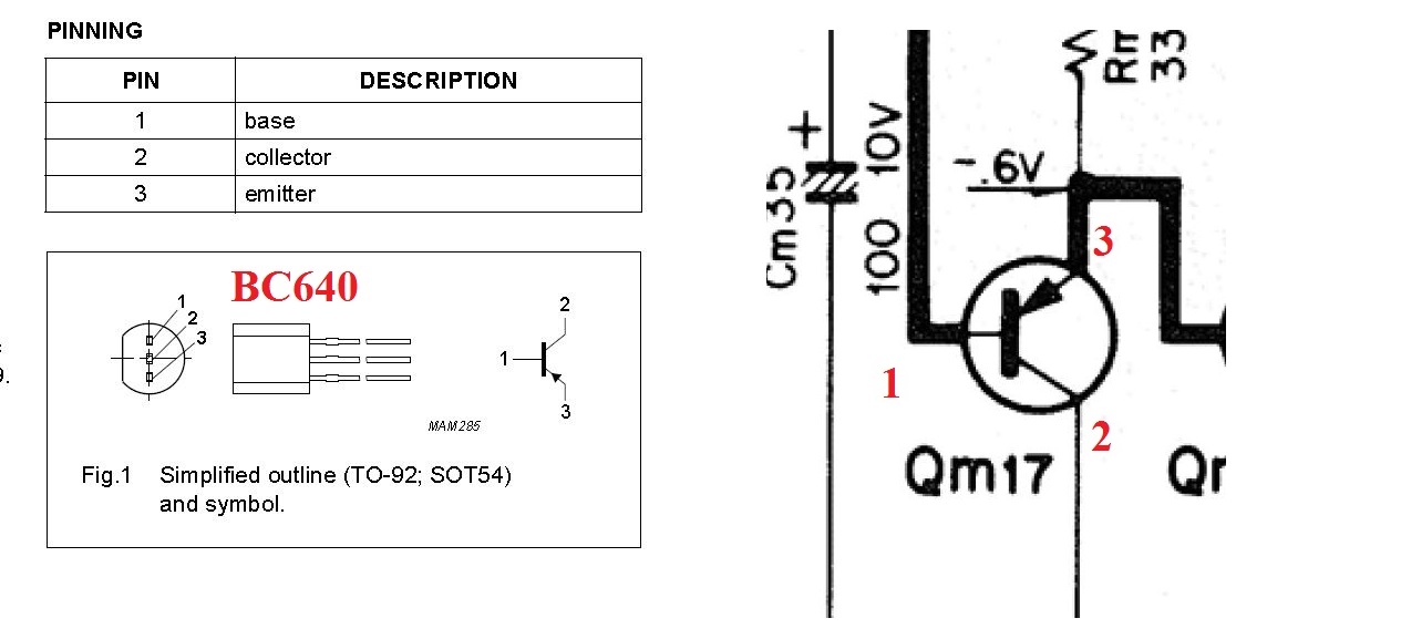

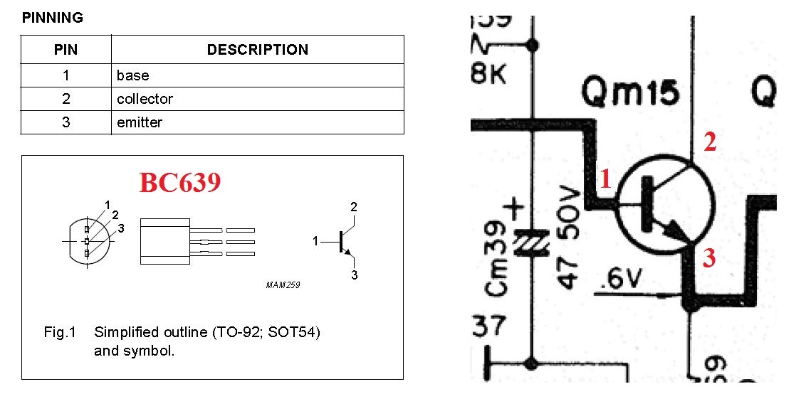

Well guys, got my order at home!
So I checked everything out and I think It goes like this:
The outputs:
(td525) For Tip41C : Goes instant, same pinout
(tb595) For Tip42C: goes instant same pinout
The drivers
c1509 For bc639 Goes instant, same pinout ( the one in the schematic is opposite of these both)
A777 for BC640 goes instant same pinout( the one in the schematic is opposite, so the a777 is already opposite then the one in the schematica)

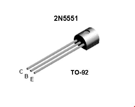

A721 For 2n5401
With flat side up looking at the bottom: (2SA721 pdf, 2SA721 description, 2SA721 datasheets, 2SA721 view ::: ALLDATASHEET :::)
A721:
1:E
2:C
3:B
2n5401:
looking from the bottom, flat side up:
1:E
2:B
3:C
a750 For 2n5401
A750 (really not sure acutally!!)
1:e
2:c
3:b

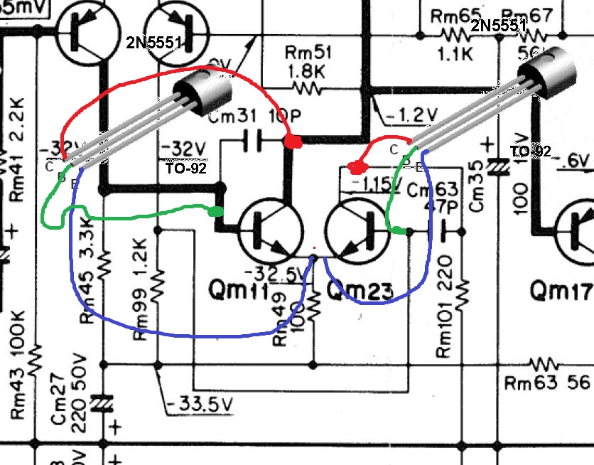

c1400 for 2n5551(not 100 procent shure)
c1400:
1e
2c
3b
2n551:
1e
2b
3c
c1400:
1e
2c
3b
2n551:
1e
2b
3c

Replace QM11 and QM23 with the 2N5550. Look at the pinouts. The emitters connect together on the PCB. When fitted make sure that none of the leads are shorting to any other as you will have had to twist/bend the leads to get these to fit. Look at the data sheet again and confirm that the connections are correct. On the diagram the emitter is the one with the arrow. The base is the "middle" connection and the collector at the top. Remember on the diagram the other (right) channel is drawn "upside down"
Next we fit the NPN driver QM15 using BC639. Look at the diagram.
And the same for the PNP BC640 driver QM17
