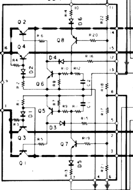

I'm a new member. I'm looking for a circuit or schematic plan for the kenwood basic c2 preamp and kenwood basic m2 amp. A few weeks ago i bought a c2 and its sound is very good. Now i'm looking for a m2, but all i've found was defect amps. I suppose the powercircuits dat 1521 and/or dat 1018 have finished there life...
I've red that there is a posibility to bypass the TA2031 and than the amp maybe runs fine ... only that it runs real hot! Maybe a additional heatsink like a heatpipe for example will solve this problem??? I will try....
Can anyone explain me this bypassing? Then i can test my m2 by that. And i'm looking for a test to check the dat 1521 and dat 1018 if this piece is ok or not....

I have the service manuals for the M1A and M2A
I don't think you can bybass the TA2031, see attached

solution from other Thread....?
i red this bypassing-method in this forum in a thread made by the members SVI2004 and K-amps. But unfortunatly i'm a new member und so i'm under moderation. It's not allowed to me to send e-mails direct to members.... :-(.
