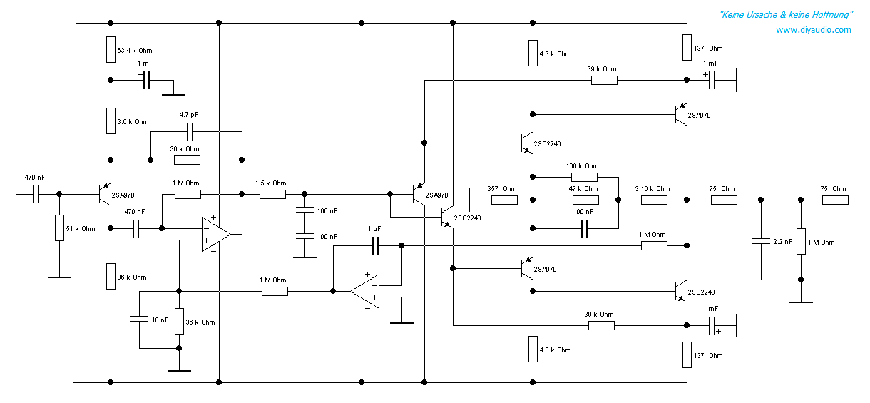

"Keine Ursache" : a still immature MM phono EQ idea
Excuse me for being brief, I am an engineer, and after more than 20 years on various audio (...)
The same applies to me, so let's be brief ..!

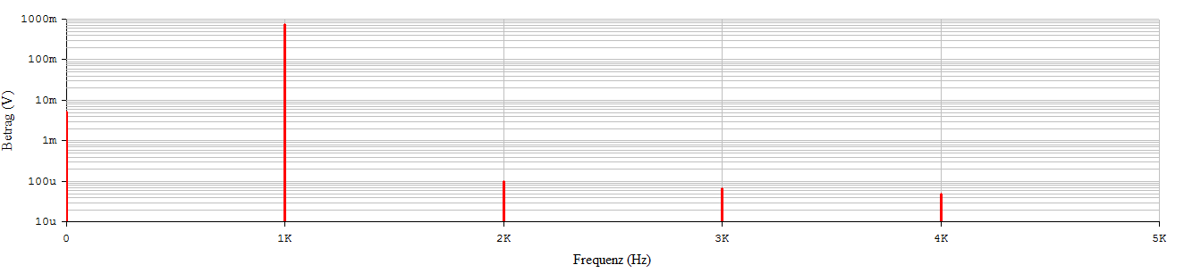

fullscale
n=5
fo=1kHz
Rload = 15kOhm (maximum permissible load, otherwise the distortion increases.)
THD < 0.018%
It doesn't look bad at all for this trivial DIY circuit - and it will have its own sound profile.

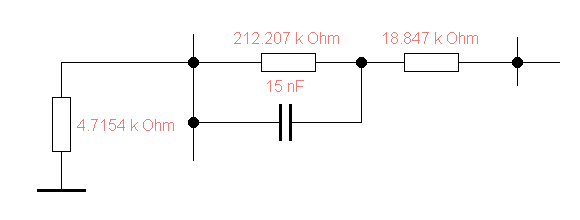

This is a mismatch of several techniques.
That was intentional!
There is a current conveyor visible composed of a diamond bufer driving two transistors that do the voltage to current conversion.
Yes, this is also always the standard case, it applies to the emitter circuit - completely independent of any feedback structure.
One should be able to let go of the dreams of the diamond at some point, it is the collector circuit and nothing else.

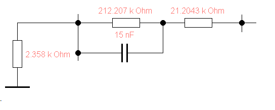

At this point a current driven Riaa network should be connected with it’s other side to gnd.
Aha, the working resistor (also known as the load) - ok. this can be connected to one of the supply voltage rails or to the reference potential called gnd.
Any node (that seems to make sense) can be used, especially if it is a virtual zero. You have to be able to differentiate clearly between the static and the dynamic view. But we are all familiar with this.
A high input impedance buffer should provide a low ohmic output impedance.
Ok, which brings us to the ideal voltage source model. Or finally talking about dynamic internal resistances (of possible sources).
It’s output is the right point to connect a feedback resistor to the diamond output.
That's total nonsense, because the realization of a negative feedback loop that you criticize here has worked for centuries - and has been used successfully since time immemorial.
Feedback from the current output is not the way to go to.
With respect, that is also stupid, because this path is very easy to walk on.
Feedback is not to be used with a current Riaa network.
There is no current impedance (current riaa) and no voltage impedance (voltage riaa), not in the whole beautiful world! There is only one complex resistor, which is formed by reactances and effective resistances. Z(jOmega) you know and Z = U / I.
It’s one or the other no feedback and a current Riaa network or feedback from the output buffer with a Riaa network.
Of course, you can measure a proportional voltage if you dynamically connect a resistor (of any type) in parallel with a current source or sink. U = I * Z or I = U / Z.
When I read your text, I get the impression that there is an ordinary RIAA network (actually it's just a resulting complex resistor, but let's not go there) and a current Riaa network (the same complex resistor). But this does not correspond to the physical facts.
Point is however that CFA’s don’t like caps in the feedback path.
"CFA's" ? current feedback amplifiers don't like -jX. Why? Because exactly this strange resistance (ohmic), i.e. Rf, also determines the bandwidth of the system, i.e. the upper cut-off frequency !?

For all those who have lost track in the meantime, the last iteration once again as a picture.
DIY also means (and not 1001 LT-Spice simulation fantasies) holding something concrete in your hand. Some kind of plan or inspiration. This design is such an example, a possible framework that you can try out and grow with. Don't worry, a simple ready-made soup is simply not the yellow of the egg.
Here you can learn by playing, I will be happy to answer any questions that might arise during a concrete implementation and will not leave you out in the rain.

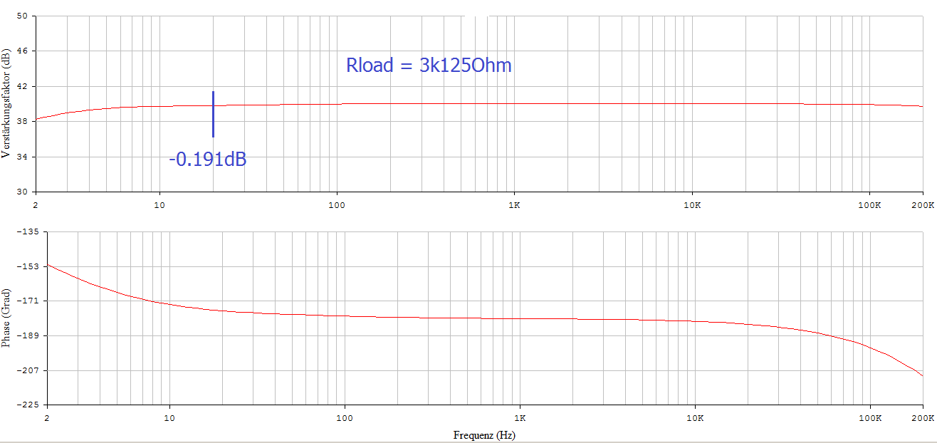

This is a big limitation, as nowadays preamps often have input impedance of 10 kohm or even much less. And you forgot to mention decreased gain and thus RIAA accuracy at low frequencies, when the load gets below 10k. I am sorry, the design is maybe a kind of fun for you, but nothing to be suggested as a DIY project for DIY community.
Reactions: hbtaudio
Now please leave the church in the village @PMA, I asked for the desired key data that a good (?) phono equalizer should have, in which points should it be better than, for example, your OpenAmp1 project - which I find just as good as Bonsai's or Wayne C's offer.
So what load should the equalizer preamplifier be able to drive and how high can the THD be?
Realistic information please.
Nonsense! This thread is a carrier ... and one can or cannot draw information from it.
Greetings,
HBt.

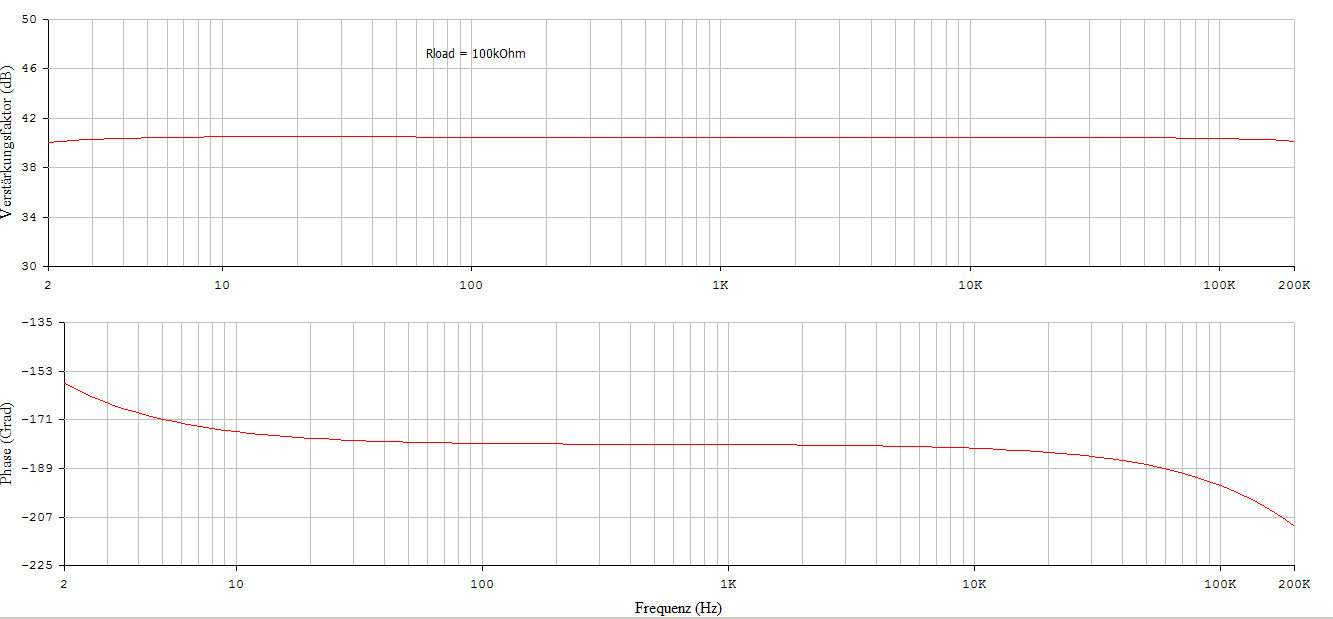

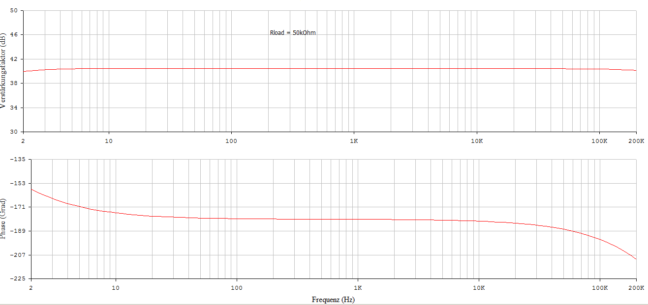

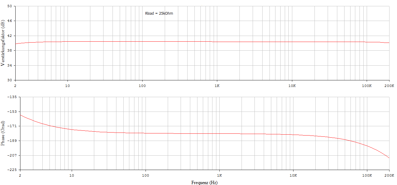

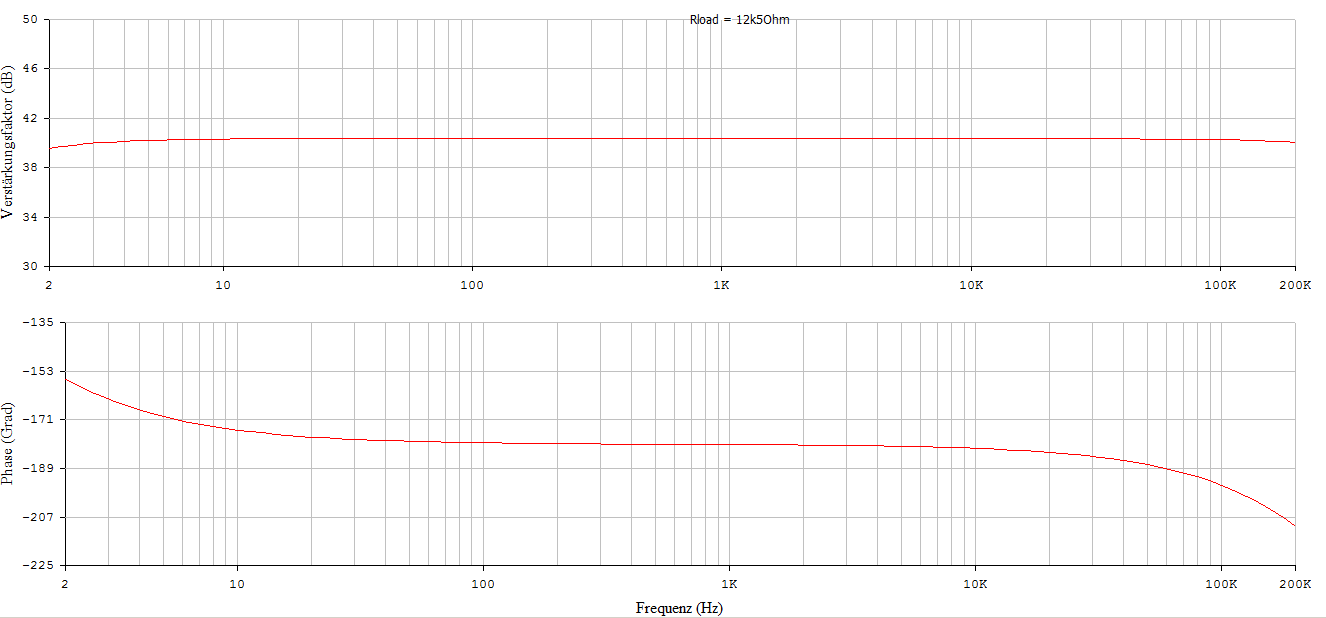

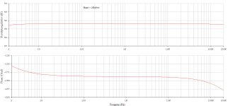

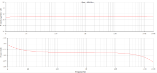

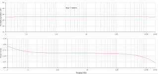

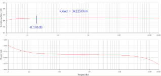

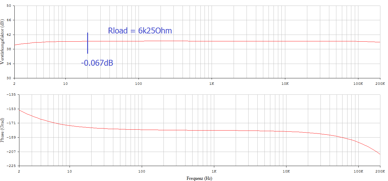

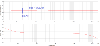

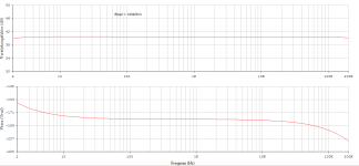

And you forgot to mention decreased gain and thus RIAA accuracy at low frequencies, when the load gets below 10k. I am sorry, (...)
Of course, I'm happy to make up for this immediately, I just didn't think it was necessary with these huge deviations from the norm!
To keep these fabulous deviations visible, I increased the 470nF capacitors to 22µF (which would not have been necessary for either of the two guys, but I won't tell you why - because I have no idea about the matter ... that's what Mr. Hans P. wants to sell us, but he's very wrong ).
So if one can live with a THD of 0.01 % (actually only K2, i.e. a very good-natured distortion) under normal load conditions, you can go for the breadboard ..!
HBt.

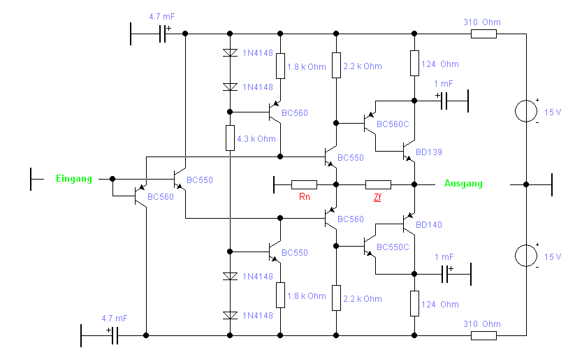

"D' Artangan"
He will help all the other musketeers out of a tight spot.
The advertising and sales department is very happy about the mutation of the secret fourth, finally they can come up with great photos of the high-end PCB. A 100mWrms class A power amplifier, it also drives headphones crazy.
HBt.
