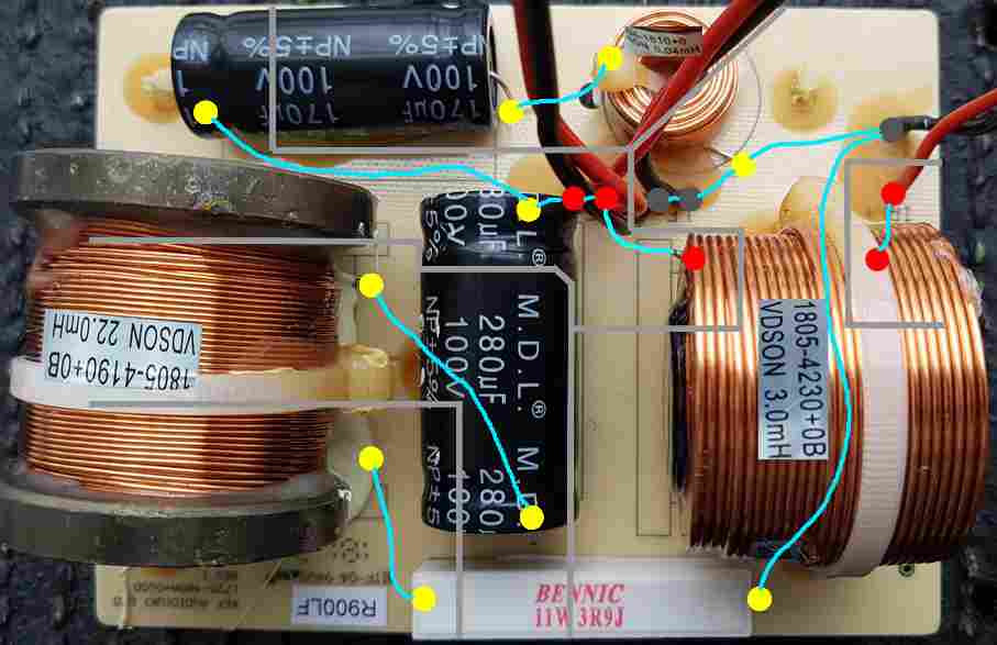

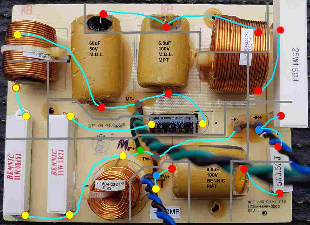

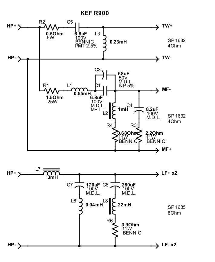

Hi folks 🙂,
I would like improve the sound of the my KEF R900 speakers by upgrading its crossover parts, and am thus looking for suggestions, advices, feed-back...
You will find attached my pictures of its crossover (world premiere !).
Thanks a lot :hug: .
Douede

Only thing that would bring some improvement in their crossover would be upgrade of 3mH coil in woofer section. You should upgrade to air-coil but try to keep Rdc the same - it is somewhat highish.
Bypass those elcos with some small foil caps and that would be it. Everything other than complete redesign would be a waste of time and money.
These are fine speakers and upgrading the caps would be well worthwhile.
The difference between electrolitics and even modest caps will be noticeable. Something like Ansar Supersound caps would work nicely. You'd need to replace the boards, as they won't be big enough for these caps. The only real issue you face is the size of some of the caps. It may well prove too expensive (and space eating) to replace them with non electrolitics - a bypass cap may be your only option.
The inductors can be replaced with air cored, especially the tweeter ones. The others will be ok as long as you don't push the speakers too hard.
Resistors can be left as is - upgrades are expensive and offer minimal improvements.
I see now that there is elco series to midrange. Upgrade at that place to foil cap would also be ok. But again, i wouldn't go wild with Mundorfs or Duelunds. Kef dual concentrics are great drivers but with their factory crossovers are firmly positioned in a certain class of sound. Changes in sound throwing high price xover components at it, while maybe evident, aren't that large to make it worth the hassle.
And don't expect to hear large differences if you change elcos on woofer crossover to foil caps. Both elcos (170uF and 280uF) are used in such a manner that it will not make significant difference but will cost a small fortune.

I upgraded the capacitors in my Kef LS50 and it made a difference, even though the capacitors were all already film capacitors. Applying digital EQ for a flat response made an even bigger difference (as expected).
Here in the R900, the response is already pretty flat, but the electrolytic capacitors and low-grade film capacitors need to go. The inductors look to be good quality already, so I would leave them alone.

I think you are accurately describing the sound of electrolitic capacitors and ferrite cored inductors 😉 KEF have a distinct 'house' sound which comes from the crossovers rather than the drive units. The drive units are really rather good.
I think you are accurately describing the sound of electrolitic capacitors and ferrite cored inductors .../...
Couldn't the plastic sounding treble come from the film cap in series with TW ?.
One of the improvement i am looking for is a treble also able to sound like crystal glass or metal (=not always warm), but still never harsh.
OK, the round and little to slow (& boomy) bass could come from the ferrite cored inductor. A brand/model that could bring them more "air" and slam ?
This is simply false. Kef's crossovers contribute to the sound significantly as with every other loudspeaker, but Q series sounds way different than R series. Again, because Q series employs 6dB/o electrical filters and are 2.5way rather than 3 way systems in R series. There is nothing distinct about it and they are using the same brands of components.
I have at my disposal Kef Q100 with modified crossovers, Kef LS50 with modified crossovers and Kef R300, needless to say, with modified crossovers.
When designed crossovers produce flat and smooth response for drivers in their pass-band on and off axis, the sound character of the drivers is what remains. Again, i'm not saying that better crossover parts will not make audible difference for the better, but that it might not fix the things that needed fixing in the first place. If bass sounds mushy and boomy, no cap or coil can fix it rather than finding better speaker or listener (sometimes both) position.

Do not be afraid of elcos in bass section. Pioneer TAD uses it for their woofers in their Reference One model.
https://www.technicalaudiodevices.com/assets/img/bass-crossover.jpg?format=1000w
